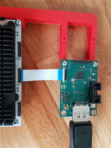

we are trying to capture DisplayPort Video with a BeagleBone AI-64 using a Lontium LT7911D DP-to-CSI bridge.
Sadly, this only works sometimes and only for one or a few frames, then the capture stalls.
For testing, we attached the same Test-PCB with the Lontium chip to a Raspberry Pi 5 and using the same driver, there the capture works as expected. So probably I (or the driver) am configuring something wrong.

I also attached a full kernel log of the board booting, then attaching a Display Port output and trying to capture (which hung), then cancelling the capture ~18 seconds later (Ctrl + C).

    Are there any loose connections in the cables?
    Jared
  • I think your problem is more likely, the timing of the device does not line up with the TDA4, and it's causing issues with the header packets.
    Sadly, our contact at Lontium has fallen silent. It currently seems unlikely we will get more information than we already have, thus no specific timing information. Would it be possible to measure the necessary information off of an oscilloscope capture of the actual transmission? If yes, which parameters should we look for?
    I hope not ;-) It is a standard "Raspberry camera" style FFC with FFC connectors at both ends. I also tried a different cable without change.
    Kind regards,
    Stefan
