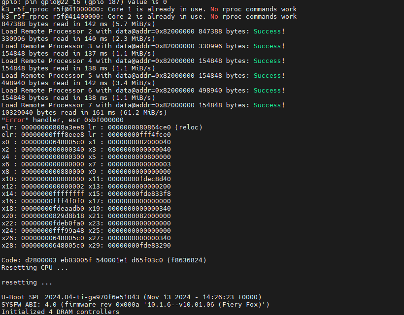

  • I tried another method, which use to try to load the binary from u-boot by interrumpting the boot. Here are the steps I followed :
    • Copied the app in /run/media/BOOT-mmcblk1p1
    • Reboot and interrupt u-boot
    • fatls mmc 1:1 (check if the file is here)
    • load mmc 1:1 0x90000000 app.bin
    • rproc init
    • rproc list (get the core id where we want to load the binary)
    • rproc load <id> 0x90000000 0x${filesize}
    • rproc start <id>
The same problem appears at the load step, the EVM keeps restarting :

  • Hi Wissam,
    Indeed I am trying to load a firmware that has a loadable program segment in the C7X L2 SRAM, because it is necessary to run code in L2.
    Thanks for the details.
    This is not possible at load-time from either the A72 U-Boot or Kernel (or even from an R5F core). The C7x L2SRAM is part of the C7x sub-system, but it doesn't have a separate power control on TDA4 devices.
    The A72 core would need a separate power control typically for loading this internal memory, while requiring the C7x core to still be in reset. The h/w does not support this, so a loadable program segment in C7x L2 SRAM is not supported.
    You would have to rely on your C7x firmware to relocate code while booting.

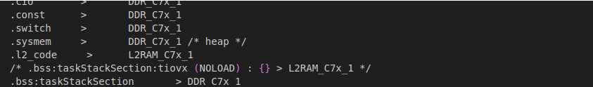

  • Hi Suman,
    Thanks for your feedback.
    Actually I'm trying to load the C7X code in the related L2, which means First C7X code -> First C7X L2.
    In the A72 point of view, we don't do anything except specifying the L2 address range in the device tree, and loading the core with remoteproc. Is it correct to proceed like that?
    I tried to relocate the code from the C7X linker, using the C7X local address you gave me, and there is the same problem. I replaced the address 0x64800000 by 0x00800000.
    Here is the new readelf -l output :

  • Hi Wissam,
    This still won't work if you are trying to load the L2SRAM from A72. Loading the L2SRAM from A72 is simply not possible as I mentioned in my previous response.
    You essentially need to ensure that your loadable segments do not have any contents in the C7x L2SRAM. This will boot your C7x successfully, and then you can relocate the code from DDR to L2SRAM from the C7x itself.
    regards
