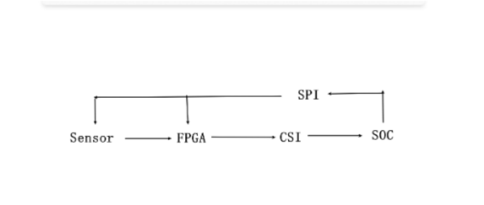

AM62A7-Q1: [AM62A7]The SOC receives the raw CSI data from the FPGA.
Part Number: AM62A7-Q1
The Linux system is already running on our custom board.
The following diagram shows our hardware connection.
Use CSI2 DPHY 1.5Gbps, 4 lane
I have a few questions I'd like to ask.
1.Is there a driver in the SDK that I can refer to?
2.How can I obtain the raw data from CSI?
I modified the driver based on the OV5640 driver for FPGA (removing IIC control,PM, Regulator,only reserve v4l2 subdev).
During the debugging phase, the FPGA continuously sends data and does not require control.
Our data format is custom-defined; I want to directly obtain the raw data.
The following links are already connected.

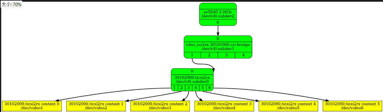

root@am62axx-evm:~# lsmod | grep "ov5640"
ov5640                 12288  0
root@am62axx-evm:~# media-ctl -d /dev/media0 -p
Media controller API version 6.12.35
Media device information
driver          j721e-csi2rx
model           TI-CSI2RX
serial
bus info        platform:30102000.ticsi2rx
hw revision     0x1
driver version  6.12.35
Device topology
- entity 1: 30102000.ticsi2rx (7 pads, 7 links, 1 route)
            type V4L2 subdev subtype Unknown flags 0
            device node name /dev/v4l-subdev0
        routes:
                0/0 -> 1/0 [ACTIVE]
        pad0: SINK
                [stream:0 fmt:UYVY8_1X16/640x480 field:none colorspace:srgb xfer:srgb ycbcr:601 quantization:lim-range]
                <- "cdns_csi2rx.30101000.csi-bridge":1 [ENABLED,IMMUTABLE]
        pad1: SOURCE
                -> "30102000.ticsi2rx context 0":0 [ENABLED,IMMUTABLE]
        pad2: SOURCE
                -> "30102000.ticsi2rx context 1":0 [ENABLED,IMMUTABLE]
        pad3: SOURCE
                -> "30102000.ticsi2rx context 2":0 [ENABLED,IMMUTABLE]
        pad4: SOURCE
                -> "30102000.ticsi2rx context 3":0 [ENABLED,IMMUTABLE]
        pad5: SOURCE
                -> "30102000.ticsi2rx context 4":0 [ENABLED,IMMUTABLE]
        pad6: SOURCE
                -> "30102000.ticsi2rx context 5":0 [ENABLED,IMMUTABLE]
- entity 9: cdns_csi2rx.30101000.csi-bridge (5 pads, 2 links, 1 route)
            device node name /dev/v4l-subdev1
        routes:
                0/0 -> 1/0 [ACTIVE]
        pad0: SINK
                <- "ov5640 2-003c":0 [ENABLED,IMMUTABLE]
        pad1: SOURCE
                -> "30102000.ticsi2rx":0 [ENABLED,IMMUTABLE]
        pad2: SOURCE
        pad3: SOURCE
        pad4: SOURCE
- entity 15: ov5640 2-003c (1 pad, 1 link, 0 routes)
             type V4L2 subdev subtype Sensor flags 0
             device node name /dev/v4l-subdev2
        pad0: SOURCE
                [stream:0 fmt:UYVY8_1X16/640x480@1/30 field:none colorspace:srgb xfer:srgb ycbcr:601 quantization:full-range
                 crop.bounds:(0,0)/0x0
                 crop:(0,0)/0x0
                 compose.bounds:(0,0)/0x0
                 compose:(0,0)/0x0]
                -> "cdns_csi2rx.30101000.csi-bridge":0 [ENABLED,IMMUTABLE]
    driver          j721e-csi2rx
    model           TI-CSI2RX
    serial
    hw revision     0x1
    Device topology
            routes:
                    0/0 -> 1/0 [ACTIVE]
            pad0: SINK
            pad1: SOURCE
            pad2: SOURCE
            pad3: SOURCE
            pad4: SOURCE
            pad5: SOURCE
            pad6: SOURCE
            routes:
                    0/0 -> 1/0 [ACTIVE]
            pad0: SINK
                    <- "imx219 spi2.1":0 [ENABLED,IMMUTABLE]
            pad1: SOURCE
            pad2: SOURCE
            pad3: SOURCE
            pad4: SOURCE
    - entity 15: imx219 spi2.1 (1 pad, 1 link, 0 routes)
            pad0: SOURCE
                    [stream:0 fmt:SRGGB10_1X10/3280x2464 field:none colorspace:raw xfer:none ycbcr:601 quantization:full-range
                     crop.bounds:(8,8)/3280x2464
                     crop:(8,8)/3280x2464]
    - entity 21: 30102000.ticsi2rx context 0 (1 pad, 1 link)
                 type Node subtype V4L flags 0
                 device node name /dev/video1
            pad0: SINK
                    <- "30102000.ticsi2rx":1 [ENABLED,IMMUTABLE]
    - entity 27: 30102000.ticsi2rx context 1 (1 pad, 1 link)
                 device node name /dev/video2
            pad0: SINK
                    <- "30102000.ticsi2rx":2 [ENABLED,IMMUTABLE]
    - entity 33: 30102000.ticsi2rx context 2 (1 pad, 1 link)
                 device node name /dev/video3
            pad0: SINK
                    <- "30102000.ticsi2rx":3 [ENABLED,IMMUTABLE]
    - entity 39: 30102000.ticsi2rx context 3 (1 pad, 1 link)
                 device node name /dev/video4
            pad0: SINK
                    <- "30102000.ticsi2rx":4 [ENABLED,IMMUTABLE]
    - entity 45: 30102000.ticsi2rx context 4 (1 pad, 1 link)
                 device node name /dev/video5
            pad0: SINK
                    <- "30102000.ticsi2rx":5 [ENABLED,IMMUTABLE]
    - entity 51: 30102000.ticsi2rx context 5 (1 pad, 1 link)
                 device node name /dev/video6
            pad0: SINK
                    <- "30102000.ticsi2rx":6 [ENABLED,IMMUTABLE]

  • Hi Slowby,
    Could you please confirm have you modified the CSI driver with your custom datatype?
    Dilna K
  • Hello, Dilna
    re:I had the FPGA transmitter change the data type to 0x2a (MIPI_CSI2_DT_RAW8 0x2a),but it still the frame-*.bin file was not generated, and yavta the process appears to be stuck.Is this normal?
    We set the connection parameters to 1.5G*4, and the clock speed to 750MHz.
    We also measured CSI data and Clock lane using an oscilloscope.
    The measured clock is 750Mhz, Data lane have varying electrical levels.
    Below is my device tree configuration.
        spidev@1 {
            compatible =  "sony,imx219";
            reg = <1>;
            spi-max-frequency = <12000000>;
            clocks = <&clk_24M_fixed>;
            clock-names = "xclk";
            port {
                csi2_cam0: endpoint {
                    remote-endpoint = <&csi2rx0_in_sensor>;
                    link-frequencies = /bits/ 64 <750000000>;
                    clock-lanes = <0>;
                    data-lanes = <1 2 3 4>;
  • Hi Slowby,
    1. As per my understanding you are using camera sensor with custom datatye(0x13) and the FPGA unit which translate it to RAW8 format and feed it to the SOC CSI.
    both sensor and FPGA is clock controlled by SPI right? please confirm.
           which camera sensor you are using?
    2. The error "__vb2_wait_for_done_vb: sleep was interrupted" is  your application is entering a "sleep" state because it is waiting for the hardware to finish a frame, but that frame never arrives.
    My assumption is the problem is in the Data Link between your FPGA and the TI CSI-2 Receiver. the hardware is likely failing at the Physical (D-PHY) layer.

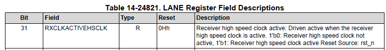

    3. Could you please check the D-PHY register 0x30111000 to check if the CSI-2 lanes are detecting the "High Speed" state?
    # Read the register value
    devmem2 0x30111000
    If the value is 0 (1'b0): The receiver high-speed clock is not active. This means the AM62A doesn't "see" the 750 MHz clock from the FPGA, or the signal is so poor that it cannot be detected as an HS signal.
    4. Also please check the STREAM0_STATUS register.
    0x30101104:
    • bits[1:0]: should be 0 when not receiving data, and should be either 1, 2, or 3 when receiving data.
    • bits[7:4]: should be 0 when not receiving data, and should be non-zero (1, 3, etc) when receiving data
    • bit 31: should be 0 when not receiving data and should be 1 when receiving data
    Note:-
    imx219 is an I2C based driver . so please confirm you have modified your driver with respect to SPI configurations.
    Dilna K
  • Hello,Dilna
    yes, and FPGA send the RAW8(0x2a),but it is actually data of character not raw8, like 0x2e 0x5d 0x2d 0x5e or 0xAA33BB66CC44 so on.
    sony imx459 and sigmastar ss901
    root@am62axx-evm:~# devmem2 0x30111000
    /dev/mem opened.
    Memory mapped at address 0xffff94b52000.
    Read at address  0x30111000 (0xffff94b52000): 0x40800000
    root@am62axx-evm:~# devmem2 0x30101104
    /dev/mem opened.
    Memory mapped at address 0xffff8e435000.
    Read at address  0x30101104 (0xffff8e435104): 0x00000000
    0x30111000 0x40800000:01000000100000000000000000000000
    0x30101104 0x00000000
    We are now trying to change the clock to 200MHz and data lane 400Mbps*4, and it is not work, too.
    4.Note:- imx219 is an I2C based driver . so please confirm you have modified your driver with respect to SPI configurations.
    I also posted the link diagram and media-ctl -p above.it display the link and connect,and dev is exist
    In fact, soc do not control the FPGA and sensor. Just receive csi data,

        printk("imx219 imx219_probe %s %d\n", __FUNCTION__, __LINE__);
    	imx219 = devm_kzalloc(&client->dev, sizeof(*imx219), GFP_KERNEL);
    	if (!imx219)
    		return -ENOMEM;
        spi_set_drvdata(client, imx219);
    	v4l2_spi_subdev_init(&imx219->sd, client, &imx219_subdev_ops);
    	imx219->sd.internal_ops = &imx219_internal_ops;
        imx219->sd.dev = dev;
    	/* Check the hardware configuration in device tree */
    	if (imx219_check_hwcfg(dev, imx219))
    		return -EINVAL;
    	/* Get system clock (xclk) */
    	imx219->xclk = devm_clk_get(dev, NULL);
    	if (IS_ERR(imx219->xclk))
    		return dev_err_probe(dev, PTR_ERR(imx219->xclk),
    				     "failed to get xclk\n");
    	imx219->xclk_freq = clk_get_rate(imx219->xclk);
    	if (imx219->xclk_freq != IMX219_XCLK_FREQ)
    		return dev_err_probe(dev, -EINVAL,
    				     "xclk frequency not supported: %d Hz\n",
    				     imx219->xclk_freq);
    	 * The sensor must be powered for imx219_identify_module()
    	 * to be able to read the CHIP_ID register
    	ret = imx219_power_on(dev);
    	if (ret)
    		return ret;
    	ret = imx219_init_controls(imx219);
    	if (ret)
    		goto error_power_off;
    	/* Initialize subdev */
    	imx219->sd.flags |= V4L2_SUBDEV_FL_HAS_DEVNODE |
    			    V4L2_SUBDEV_FL_HAS_EVENTS;
    	imx219->sd.entity.function = MEDIA_ENT_F_CAM_SENSOR;
    	/* Initialize source pad */
    	imx219->pad.flags = MEDIA_PAD_FL_SOURCE;
    	ret = media_entity_pads_init(&imx219->sd.entity, 1, &imx219->pad);
    	if (ret) {
    		dev_err_probe(dev, ret, "failed to init entity pads\n");
    		goto error_handler_free;
    	imx219->sd.state_lock = imx219->ctrl_handler.lock;
    	ret = v4l2_subdev_init_finalize(&imx219->sd);
    	if (ret < 0) {
    		dev_err_probe(dev, ret, "subdev init error\n");
    		goto error_media_entity;
    	pm_runtime_set_active(dev);
    	pm_runtime_enable(dev);
    	ret = v4l2_async_register_subdev(&imx219->sd);
    	if (ret < 0) {
    			      "failed to register sensor sub-device\n");
    		goto error_subdev_cleanup;
    	pm_runtime_idle(dev);
    	dev_info(dev, "IMX219 sensor driver loaded (CSI %d lanes, no I2C)\n", imx219->lanes);
    	return 0;
    error_subdev_cleanup:
    	v4l2_subdev_cleanup(&imx219->sd);
    	pm_runtime_disable(dev);
    	pm_runtime_set_suspended(dev);
    error_media_entity:
    	media_entity_cleanup(&imx219->sd.entity);
    error_handler_free:
    	imx219_free_controls(imx219);
    error_power_off:
    	imx219_power_off(dev);
    	return ret;
    Or is there any way to directly obtain the most basic raw data, like phy?

  • Hi Slowby,
    Could you please change the link frequency to 200MHz and try?
    1. During testing repeatedly check the status of the register 0x30111000 (whether the 31st bit is changing to 1 ie, The receiver high-speed clock is getting active.)
    2. and also please check the error_irqs register 0x30101028
    Dilna k
