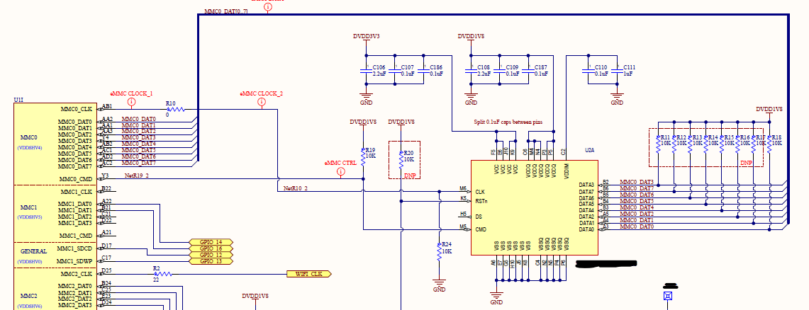

AM623: eMMC boot issue at -40C
Part Number: AM623

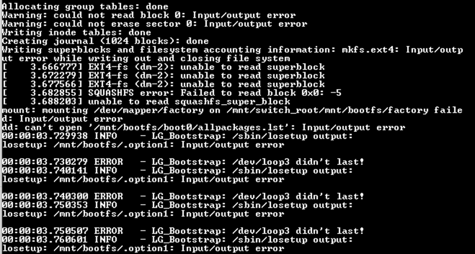

We are using an AM6231ASGGHAALW custom board w/ 6.12.35 and experiencing eMMC boot issues at -40C.  This failure recently surfaced as schematic/BOM have been frozen for 2+ yrs.
eMMC is Skyhigh mpn S40FC004C1B1I.
Snippet below shows error message.  Full boot log is attached.
Boot Error at -40C.txt
  • Hi Kevin,
    From the kernel log, the problem seems to be hardware/board related, our hardware engineers might comment on this later. But you could apply the following kernel patch which would recover from the eMMC error and ensure the data integrity, Linux will operate normally.

  • Hi Bin,
    Thanks for providing the CQE recovery patch - it successfully resolved the cold boot issue with SkyHigh S40FC004C1B1I and Macronix MX52LM04A11XSI eMMCs.  Unfortunately, the issue persists with ISSI IS21EF08G-JCLI. Aside from the eMMC, the HW and FW are identical.  Please refer to the attached boot logs for all three devices.
    Although the product is rated for an operating temperature range of -40 to 85C, validation was performed at -50C to assess margin.

    Writing superblocks and filesystem accounting information: mkfs.ext4: Input/output error while writing out and closing file system
    [    3.929382] EXT4-fs (dm-2): unable to read superblock
    [    3.934913] EXT4-fs (dm-2): unable to read superblock
    [    3.940145] EXT4-fs (dm-2): unable to read superblock
    [    3.945396] SQUASHFS error: Failed to read block 0x0: -5
    [    3.950737] unable to read squashfs_super_block
    mount: mounting /dev/mapper/factory on /mnt/switch_root/mnt/bootfs/factory failed: Input/output error
    dd: can't open '/mnt/bootfs/boot0/allpackages.lst': Input/output error
    00:00:03.992866 INFO    - LG_Bootstrap: /sbin/losetup output:
    losetup: /mnt/bootfs/.option1: Input/output error
    00:00:03.993203 ERROR   - LG_Bootstrap: /dev/loop4 didn't last!
    00:00:04.003188 INFO    - LG_Bootstrap: /sbin/losetup output:
    00:00:04.003347 ERROR   - LG_Bootstrap: /dev/loop4 didn't last!
    00:00:04.013608 INFO    - LG_Bootstrap: /sbin/losetup output:
    00:00:04.013764 ERROR   - LG_Bootstrap: /dev/loop4 didn't last!
    00:00:04.024209 INFO    - LG_Bootstrap: /sbin/losetup output:
    00:00:04.024368 ERROR   - LG_Bootstrap: /dev/loop4 didn't last!
    00:00:04.034651 INFO    - LG_Bootstrap: /sbin/losetup output:
    00:00:04.034814 ERROR   - LG_Bootstrap: /dev/loop4 didn't last!
    00:00:04.044913 INFO    - LG_Bootstrap: /sbin/losetup output:
    00:00:04.045184 ERROR   - LG_Bootstrap: /dev/loop4 didn't last!
    00:00:04.055312 INFO    - LG_Bootstrap: /sbin/losetup output:
    00:00:04.055467 ERROR   - LG_Bootstrap: /dev/loop4 didn't last!
    00:00:04.066433 INFO    - LG_Bootstrap: /sbin/losetup output:
    00:00:04.066594 ERROR   - LG_Bootstrap: /dev/loop4 didn't last!
    00:00:04.076744 INFO    - LG_Bootstrap: /sbin/losetup output:
    00:00:04.076901 ERROR   - LG_Bootstrap: /dev/loop4 didn't last!
    00:00:04.086986 INFO    - LG_Bootstrap: /sbin/losetup output:
    00:00:04.087271 ERROR   - LG_Bootstrap: /dev/loop4 didn't last!
    00:00:04.097598 INFO    - LG_Bootstrap: /sbin/losetup output:
    00:00:04.097760 ERROR   - LG_Bootstrap: /dev/loop4 didn't last!
    00:00:04.107818 INFO    - LG_Bootstrap: /sbin/losetup output:
  • Hi Kevin,
    Thanks for the update with the test result and I am glad to hear the patch resolves the issues for 2 eMMC devices.
    From the kernel log, it appears the ISSI IS21EF08G-JCLI device doesn't support CQE unlike the other 2 eMMC devices. The patch recovers the eMMC transfer failure with CQE enabled, so it won't help the error with the ISSI device.
    I don't have a patch ready for the case without CQE. Let me discuss with Blake Carpenter for your project schedule and I will when I can work on the implementation based on my work schedule.
  • (bump up the thread to avoid auto-lock due to inactive.)
  • Hi Kevin,
    Please apply the additional kernel patch attached below. It should fix the eMMC write error on the ISSI devices which do not support CQE.
    Once you validated the patch fixes the issue, you can remove the pr_info() line in the patch in your production kernel build. I added this line to just confirm the patch is in the code path.
    diff --git a/drivers/mmc/core/block.c b/drivers/mmc/core/block.c
    index 8c5dd87a3666..6f7bc4a1121a 100644
    --- a/drivers/mmc/core/block.c
    +++ b/drivers/mmc/core/block.c
    @@ -2126,6 +2126,10 @@ static void mmc_blk_mq_complete_rq(struct mmc_queue *mq, struct request *req)
            } else if (!blk_rq_bytes(req)) {
                    __blk_mq_end_request(req, BLK_STS_IOERR);
            } else if (mqrq->retries++ < MMC_MAX_RETRIES) {
    +               if (rq_data_dir(req) == WRITE) {
    +                       pr_info("emmc write failure, recovering...\n");
    +                       req->rq_flags |= RQF_XFER_SINGLE_BLK;
                    blk_mq_requeue_request(req, true);
            } else {
                    if (mmc_card_removed(mq->card))
  • Hi Bin,
    The patch resolved the issue with ISSI IS21EF08G-JCLI (non-CQE) eMMC. Although our product is rated for an operating temperature range of -40 to 85C, validation was performed at -50C to assess margin.

    [    2.733041] emmc write failure, recovering...
    Pass 1: Checking inodes, blocks, and sizes
    Pass 2: Checking directory structure
    Pass 3: Checking directory connectivity
    Pass 4: Checking reference counts
    Pass 5: Checking group summary information
    /dev/mmcblk0p1: ***** FILE SYSTEM WAS MODIFIED *****
    /dev/mmcblk0p1: 26/102400 files (3.8% non-contiguous), 33463/128000 blocks[    2.841242] EXT4-fs: Warning: mounting with data=journal disables delayed allocation, dioread_nolock, O_DIRECT and fast_commit support!
    [    2.876581] EXT4-fs (mmcblk0p1): mounted filesystem 4307c165-b2ad-4ad7-ae62-e7a0cf3819f2 r/w with journalled data mode. Quota mode: none.
    00:00:02.887238 DEBUG   - LG_Bootstrap: Command line found bootdir = boot0
    00:00:02.887481 WARNING - LG_Bootstrap: packageconfig not on command line.
    00:00:02.887506 WARNING - LG_Bootstrap: Assuming unlocked (for now).
    [    2.908015] loop0: detected capacity change from 0 to 16
    00:00:02.947562 DEBUG   - LG_Bootstrap: Command line found scpi_diag = 1
    00:00:02.947759 DEBUG   - LG_Bootstrap: Command line found lgplatform = TI_AM62_EIC
    00:00:02.947789 DEBUG   - LG_Bootstrap: Command line found bootdir = boot0
    00:00:02.947823 WARNING - LG_Bootstrap: packageconfig not on command line.
    00:00:02.947845 WARNING - LG_Bootstrap: Assuming unlocked (for now).
    [    2.991038] loop0: detected capacity change from 0 to 143352
    [    3.020190] loop1: detected capacity change from 0 to 16
    [    3.085061] loop1: detected capacity change from 0 to 1152
    00:00:03.088733 INFO    - LG_Bootstrap: No FEC file found, using standard verity
    [    3.099070] device-mapper: verity: sha256 using shash "sha256-ce"
    00:00:03.105481 DEBUG   - LG_Bootstrap: Command line found overlay = 0
    [    3.150039] loop2: detected capacity change from 0 to 20000
    [    3.179166] loop3: detected capacity change from 0 to 16
    e2fsck 1.47.2 (1-Jan-2025)
    /dev/mapper/factory: recovering journal
    [    3.245863] emmc write failure, recovering...
    [    3.314511] emmc write failure, recovering...
    [    3.519368] emmc write failure, recovering...
    /dev/mapper/factory: ***** FILE SYSTEM WAS MODIFIED *****
    /dev/[    3.702071] emmc write failure, recovering...
    mapper/factory: 14/2512 files (7.1% non-contiguous), 1226/2500 blocks
    [    3.741011] emmc write failure, recovering...
    [    3.767447] EXT4-fs (dm-2): mounted filesystem 2ebb1be2-ba6f-4473-aabc-6462fb7979ff r/w with ordered data mode. Quota mode: none.
    11+1 records in
    11+1 records out
    [    3.818169] loop3: detected capacity change from 0 to 16
    /dev/mapper/rootfs: recovering journal
    [    3.907930] emmc write failure, recovering...
    [    3.919704] emmc write failure, recovering...
    [    3.932517] emmc write failure, recovering...
    [    3.941923] emmc write failure, recovering...
    [    3.946563] emmc write failure, recovering...
    [    3.951308] emmc write failure, recovering...
    [    4.351974] emmc write failure, recovering...
    [    4.370997] emmc write failure, recovering...
    [    4.375835] emmc write failure, recovering...
    [    4.380318] emmc write failure, recovering...
    [    4.390748] emmc write failure, recovering...
    [    4.398229] emmc write failure, recovering...
    [    4.402999] emmc write failure, recovering...
    [    4.407797] emmc write failure, recovering...
    [    4.417508] emmc write failure, recovering...
    [    4.422179] emmc write failure, recovering...
    [    4.433930] emmc write failure, recovering...
    [    4.440040] emmc write failure, recovering...
    [    4.452232] emmc write failure, recovering...
    [    4.456934] emmc write failure, recovering...
    [    5.250920] usb 2-1: new full-speed USB device number 2 using xhci-hcd
    /dev/mapper/rootfs: ***** FILE SYSTEM WAS MODIFIED *****
