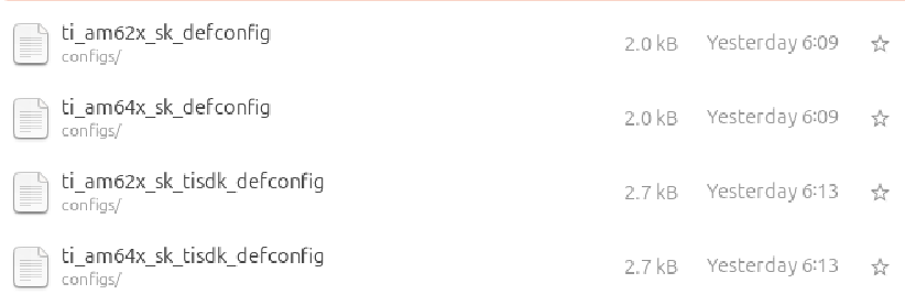

I am using AM64 evm board (green color) and trying to build uboot & kernel using buildroot for the same. I am referring the procedure from below FAQ
https://e2e.ti.com/support/processors-group/processors/f/processors-forum/1226815/faq-buildroot-support-for-sitara-am62x-am62ax-am62px-am64x-devices
I have doubt on taking which device config for AM64 boards. Buildroot have default config files as shown in below image
Whats the difference between sk_defconfig and sk_tisdk_defconfig, and when should i use both?
Also same config i can use for sk & evm boards?
I have tried to build it with ti_am64x_sk_defconfig and output got generated but during boot i get below errors,
So in this case we need to modify dts file & build again ?

  • Hi Shraddha,
    sk_defconfig would be the basic configuration intended to boot the hardware with standard kernel, u-boot, ATF etc.
    sk_tisdk_defconfig is based in the existing defconfig, but is customised with
    * TI Kernel 6.1.80 (w/ TI config-pruning step applied)
    * TI U-Boot 2023.04
    * ATF 2.10 (public tree)
    * OPTEE 4.1 (public tree)
    * TIFS/DM/DMSC Device Firmwares 9.2
    Also the patch given in the FAQ (https://e2e.ti.com/support/processors-group/processors/f/processors-forum/1226815/faq-buildroot-support-for-sitara-am62x-am62ax-am62px-am64x-devices) only creates the sk_tisdk_defconfig files.
    Please try to rebuild using the ti_am64x_sk_tisdk_defconfig config as mentioned in the FAQ.
    The differences between AM64 SK and EVM boards are on the expandibility and additional interfaces. (https://e2e.ti.com/support/processors-group/processors/f/processors-forum/1179454/sk-am64b-sk-am64b-vs-tmds64evm--main-differences)
    The same config should work for both SK and EVM boards.

    shraddha
  • Hi Shraddha,
    Can you confirm if BR2_TARGET_TI_K3_R5_LOADER_TIBOOT3_BIN is changed to tiboot3-am64x-gp-evm.bin?
    Also, it looks like the FDT,  '/boot/dtb/ti/k3-am642-evm.dtb' is not found.
    Can you try replacing the DTB at boot/dtb/ti/ on the SD card with buildroot/output/build/linux-09.02.00.009/arch/arm64/boot/dts/ti/k3-am642-evm.dtb?
    Vinu
  • Hi  ,
    In which file i need to modify this? becai=use I cannot find this command in ti_am64x_sk_tisdk_defconfig file.
    But i tried to use  ti_am64x_sk_defconfig file and modified this file as below:
    BR2_ROOTFS_POST_BUILD_SCRIPT_ARGS to take k3-am642-evm.dtb
    and BR2_LINUX_KERNEL_INTRESS_DTS_NAME to "ti/ k3-am642-evm"
    and Genimage.cfg file to take  k3-am642-evm.dtb
    with this i was able to boot device in LInux.
    Now my concern is the built images is of size 193MB, how we can reduce this within 10MB using buildroot for basic functionality using UART, USB, SPI etc
    shraddha
  • Hi Shraddha,
    I'm sharing a patch file with the changes required for AM64x EVM.
    From bcc74429b6881feee0337576652d17f6b87a5a5f Mon Sep 17 00:00:00 2001
    From: Vinuchandran <x1123550@ti.com>
    Date: Tue, 13 Jan 2026 15:45:30 +0530
    Subject: [PATCH] Update configs for AM64 EVM
     board/ti/am64x-sk/genimage.cfg       |  2 +-
     boot/ti-k3-r5-loader/Config.in       |  2 +-
     configs/ti_am64x_evm_tisdk_defconfig | 57 ++++++++++++++++++++++++++++
     3 files changed, 59 insertions(+), 2 deletions(-)
     create mode 100644 configs/ti_am64x_evm_tisdk_defconfig
    diff --git a/board/ti/am64x-sk/genimage.cfg b/board/ti/am64x-sk/genimage.cfg
    index 88dff8fe23..a37559a257 100644
    --- a/board/ti/am64x-sk/genimage.cfg
    +++ b/board/ti/am64x-sk/genimage.cfg
    @@ -4,7 +4,7 @@ image boot.vfat {
     			"tiboot3.bin",
     			"tispl.bin",
     			"u-boot.img",
    -			"k3-am642-sk.dtb",
    +			"k3-am642-evm.dtb",
     			"Image"
     		file extlinux/extlinux.conf {
    diff --git a/boot/ti-k3-r5-loader/Config.in b/boot/ti-k3-r5-loader/Config.in
    index c276528fad..d450a649e3 100644
    --- a/boot/ti-k3-r5-loader/Config.in
    +++ b/boot/ti-k3-r5-loader/Config.in
    @@ -106,7 +106,7 @@ config BR2_TARGET_TI_K3_R5_LOADER_CUSTOM_DTS_PATH
     config BR2_TARGET_TI_K3_R5_LOADER_TIBOOT3_BIN
     	string "tiboot3.bin binary name"
    -	default "tiboot3.bin"
    +	default "tiboot3-am64x-gp-evm.bin"
     	help
     	  Name of the TI K3 tiboot3.bin binary to use.
    diff --git a/configs/ti_am64x_evm_tisdk_defconfig b/configs/ti_am64x_evm_tisdk_defconfig
    new file mode 100644
    index 0000000000..17e9b98184
    --- /dev/null
    +++ b/configs/ti_am64x_evm_tisdk_defconfig
    @@ -0,0 +1,57 @@
    +BR2_aarch64=y
    +BR2_PACKAGE_HOST_LINUX_HEADERS_CUSTOM_6_1=y
    +BR2_GLOBAL_PATCH_DIR="board/ti/am64x-sk/patches"
    +BR2_DOWNLOAD_FORCE_CHECK_HASHES=y
    +BR2_ROOTFS_POST_BUILD_SCRIPT="board/ti/common/am6xx/post-build-ti.sh"
    +BR2_ROOTFS_POST_IMAGE_SCRIPT="support/scripts/genimage.sh"
    +BR2_ROOTFS_POST_BUILD_SCRIPT_ARGS="-d k3-am642-evm.dtb"
    +BR2_ROOTFS_POST_IMAGE_SCRIPT_ARGS="-c board/ti/common/am6xx/genimage_ti.cfg"
    +BR2_LINUX_KERNEL=y
    +BR2_LINUX_KERNEL_CUSTOM_GIT=y
    +BR2_LINUX_KERNEL_CUSTOM_REPO_URL="https://git.ti.com/git/ti-linux-kernel/ti-linux-kernel.git"
    +BR2_LINUX_KERNEL_CUSTOM_REPO_VERSION="09.02.00.009"
    +BR2_LINUX_KERNEL_USE_ARCH_DEFAULT_CONFIG=y
    +BR2_LINUX_KERNEL_CONFIG_FRAGMENT_FILES="board/ti/common/am6xx/ti_arm64_prune.config"
    +BR2_LINUX_KERNEL_DTS_SUPPORT=y
    +BR2_LINUX_KERNEL_INTREE_DTS_NAME="ti/k3-am642-evm"
    +BR2_PACKAGE_LINUX_FIRMWARE=y
    +BR2_PACKAGE_LINUX_FIRMWARE_TI_WL18XX=y
    +BR2_TARGET_ROOTFS_EXT2=y
    +BR2_TARGET_ROOTFS_EXT2_4=y
    +BR2_TARGET_ROOTFS_EXT2_SIZE="120M"
    +BR2_TARGET_ARM_TRUSTED_FIRMWARE=y
    +BR2_TARGET_ARM_TRUSTED_FIRMWARE_CUSTOM_GIT=y
    +BR2_TARGET_ARM_TRUSTED_FIRMWARE_CUSTOM_REPO_URL="https://git.trustedfirmware.org/TF-A/trusted-firmware-a.git"
    +BR2_TARGET_ARM_TRUSTED_FIRMWARE_CUSTOM_REPO_VERSION="00f1ec6b8740ccd403e641131e294aabacf2a48b"
    +BR2_TARGET_ARM_TRUSTED_FIRMWARE_PLATFORM="k3"
    +BR2_TARGET_ARM_TRUSTED_FIRMWARE_TARGET_BOARD="lite"
    +BR2_TARGET_ARM_TRUSTED_FIRMWARE_BL32_OPTEE=y
    +BR2_TARGET_OPTEE_OS=y
    +BR2_TARGET_OPTEE_OS_CUSTOM_GIT=y
    +BR2_TARGET_OPTEE_OS_CUSTOM_REPO_URL="https://github.com/OP-TEE/optee_os.git"
    +BR2_TARGET_OPTEE_OS_CUSTOM_REPO_VERSION="012cdca49db398693903e05c42a254a3a0c0d8f2"
    +BR2_TARGET_OPTEE_OS_NEEDS_PYTHON_CRYPTOGRAPHY=y
    +BR2_TARGET_OPTEE_OS_PLATFORM="k3-am64x"
    +BR2_TARGET_TI_K3_R5_LOADER=y
    +BR2_TARGET_TI_K3_R5_LOADER_CUSTOM_GIT=y
    +BR2_TARGET_TI_K3_R5_LOADER_CUSTOM_REPO_URL="https://git.ti.com/git/ti-u-boot/ti-u-boot.git"
    +BR2_TARGET_TI_K3_R5_LOADER_CUSTOM_REPO_VERSION="09.02.00.009"
    +BR2_TARGET_TI_K3_R5_LOADER_BOARD_DEFCONFIG="am64x_evm_r5"
    +BR2_TARGET_UBOOT=y
    +BR2_TARGET_UBOOT_BUILD_SYSTEM_KCONFIG=y
    +BR2_TARGET_UBOOT_CUSTOM_GIT=y
    +BR2_TARGET_UBOOT_CUSTOM_REPO_URL="https://git.ti.com/git/ti-u-boot/ti-u-boot.git"
    +BR2_TARGET_UBOOT_CUSTOM_REPO_VERSION="09.02.00.009"
    +BR2_TARGET_UBOOT_BOARD_DEFCONFIG="am64x_evm_a53"
    +BR2_TARGET_UBOOT_NEEDS_DTC=y
    +BR2_TARGET_UBOOT_NEEDS_OPENSSL=y
    +BR2_TARGET_UBOOT_NEEDS_ATF_BL31=y
    +BR2_TARGET_UBOOT_USE_BINMAN=y
    +# BR2_TARGET_UBOOT_FORMAT_BIN is not set
    +BR2_TARGET_UBOOT_FORMAT_IMG=y
    +BR2_TARGET_UBOOT_SPL=y
    +BR2_TARGET_UBOOT_SPL_NAME="tispl.bin"
    +BR2_TARGET_UBOOT_CUSTOM_MAKEOPTS="TEE=$(BINARIES_DIR)/tee-pager_v2.bin"
    +BR2_PACKAGE_HOST_DOSFSTOOLS=y
    +BR2_PACKAGE_HOST_GENIMAGE=y
    +BR2_PACKAGE_HOST_MTOOLS=y
    2.43.0
    You can use the newly created ti_am64x_evm_tisdk_defconfig config to create the image for EVM.
    It contains the BR2_TARGET_TI_K3_R5_LOADER_TIBOOT3_BIN change as well.
    Also, to reduce the image size, you'll have to disable unwanted packages using make menuconfig, strip binaries, remove debug symbols, increase optimisation level etc.
    These are standard Buildroot optimisations working on upstream/generic builds which are out of the scope of this forum.
    Vinu
