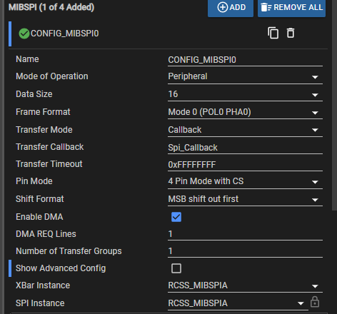

I use the RCSS_SPIA interface as slave in the AM2732 device. The AM2732 device is connected through j1 connector with a FPGA device that sends SPI master frame on RCSS every 10 ms (a simulations of the data send is shown below).
The problem is that in the AM2732 device I only get one interrupt in the beginning with the right data written in memory and then I do not get any more interrupts.
The syscfg and the code used is shown below.

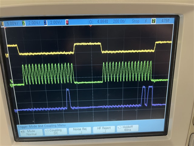

  • Hello Ming,
    I verified with an oscilloscope the SPI bus. As you can see in the captures below the first 6 packets are not empty.
    The green signal is the clock and the blue one MOSI. I verified also the CS but I had a problem with the 3rd probe and could not have all three signals together (verified that it works fine).
    Does that mean the issue is in the AM273x? Is there maybe something wrong in the AM273x configuration?
    Dimitra

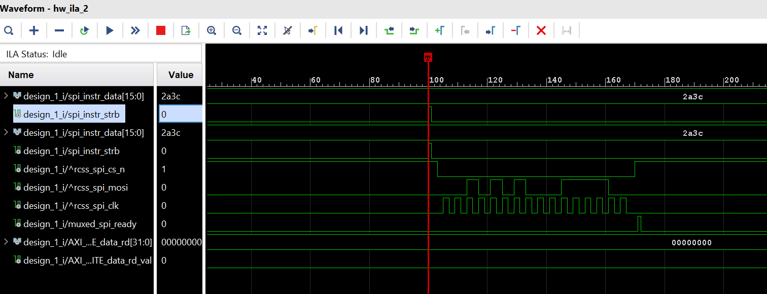

  • Hello again,
    I managed to get all SPI bus signals in the oscilloscope. In the pictures below are shown CS(yellow), CLK(green) and MOSI(purple).
    The picture below shows one part of the first data that were received in the same run where the oscilloscope pictures have been taken.
    The problem insists. Why does that happen?
    Dimitra

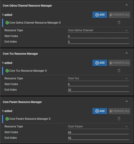

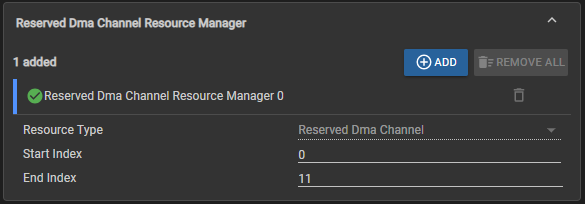

    Can you please confirm that my EDMA configurations are correct? Maybe the problem is there.
    These are the EDMA configs from my syscfg:
    Thank you in advance!
    Dimitra
  • Hi Dimitra,
    Here are my syscfg settings for MIBSPI & EDMA:
    Note Region ID is Region 0 (yours is region 2)
    Ming

    uint16_t gMibspiRxBuffer[SPI_TRANSFER_SIZE/2];
    int32_t SPI_createtasks(void)
        xTaskCreate(spi_slave, "SPI_slave", SPI_SLAVE_TASK_SIZE, NULL, SPI_SLAVE_TASK_PRI, &gSPI_slave_Task);
        if(gSPI_slave_Task != NULL)
      return SystemP_SUCCESS;
     else
      return SystemP_FAILURE;
    void Spi_Callback(MIBSPI_Handle handle, MIBSPI_Transaction *transaction)
        BaseType_t TaskWoken = pdFALSE;
        vTaskNotifyGiveFromISR(gSPI_slave_Task, &TaskWoken);
        portYIELD_FROM_ISR(TaskWoken);
    void spi_slave(void *args)
        int32_t transferOK;
        MIBSPI_Transaction spiTransaction;
        uint32_t ulEventsToProcess;
        Drivers_open();
        Board_driversOpen();
        memset(gMibspiRxBuffer, 0xFF, SPI_TRANSFER_SIZE);
        spiTransaction.count = SPI_TRANSFER_SIZE;
        spiTransaction.txBuf = NULL;
        spiTransaction.rxBuf = (void *)gMibspiRxBuffer;
        spiTransaction.peripheralIndex = 0U;
        spiTransaction.arg = NULL;
        while(1){
            transferOK = MIBSPI_transfer(gMibspiHandle[CONFIG_MIBSPI0], &spiTransaction);
            if(SystemP_SUCCESS != transferOK)
                DebugP_assert(FALSE); /* MIBSPI transfer failed!! */
            ulEventsToProcess = ulTaskNotifyTake(pdFALSE, portMAX_DELAY);
            CacheP_inv(gMibspiRxBuffer, SPI_TRANSFER_SIZE, CacheP_TYPE_ALLD); // also seems to work with CacheP_wbInv
            if (ulEventsToProcess > 1){ ; }
