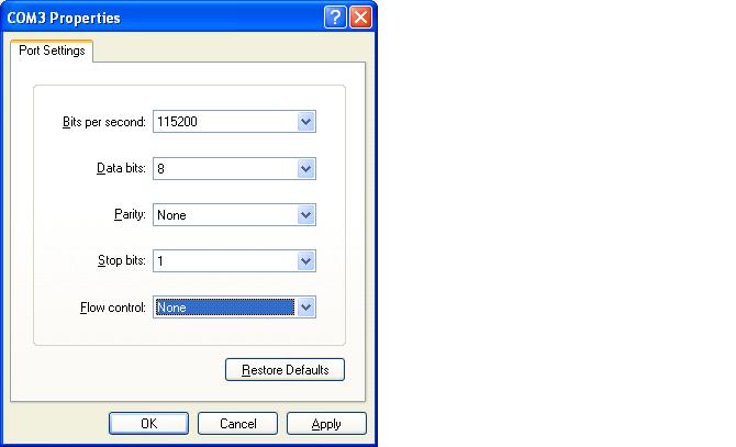

I have problem when trying to connect my DAVINCI TMS320DM6467 EVM to a console window (Tera-Term).
I followed instructions in TMS320DM6467 DVEVM Getting Started Guide (spruf88d.pdf) and tried to connect to EVM using UART (Console Window).
But after I set up the hardware (section 2.1 in the User Guide) and powered on the EVM, Console Window displayed nothing.
I make sure that the RS-232 cable works correctly and serial setting is followed the instruction in User Guide.

    3> Make sure Serial terminal settings are as per attached.
