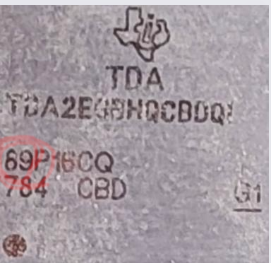

(1) Is the part number TDA2EGBHQCBDQ1 = TDA2EG-17?
(2) here are two different lot code w/ TDA2EGBHQCBDQ1. Customer claimed LOT code 69P16CQ can boot on customerized board, but 26P1N8Q can not boot. Does both of them have the same ROM code version?

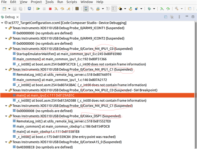

  • Gibbs,
    If I understand correctly from this comment that you are actually booting one of these parts but not the other?
    They are both TDAEGBHQCBDQ1, only difference being the lot number?

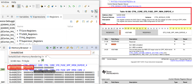

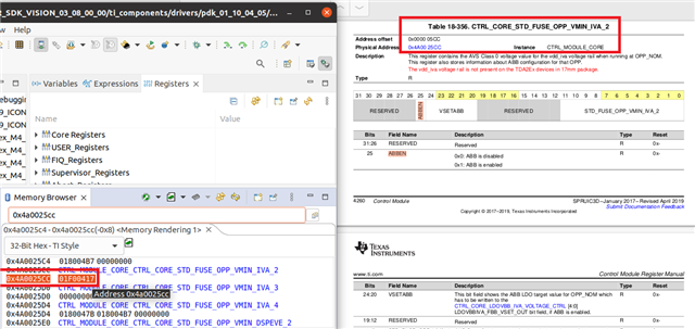

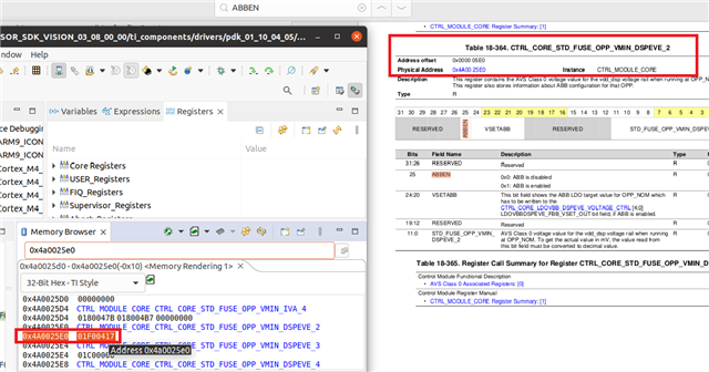

    Second, could you please check for both parts the DIE_ID, JTAG ID, and AVS EFuse values?
    -Josue
  • Hi, Josue
    Thanks your replies.
    I also prefer to dump IE_ID, JTAG ID, and AVS EFuse from register reading, but there is still a JTAG connection issue on customerized board. so base on current status, it's only support SD boot w/ SBL , and then use "printf function" (SBLLibPrintf)  in code for debugging.
    Here are some debug updates.
    (1) Customer's board can boot with "OPP NOM" SBL binary, but we still face some init failed issues. build(boot) binary path as below,
    /home/gibbs/work/TDA2EG-17/PROCESSOR_SDK_VISION_03_08_00_00/vision_sdk/binaries/apps/tda2ex_evm_bios_all/sbl/sd/opp_nom/tda2ex-evm/MLO
    (2) I think SBL correct recogized device "TDA2EG-17" , because this function return "TRUE" as below.
    SBLLIB_SILICON_PACKAGE_TYPE_17X17 == SBLLibGetSiliconPackageType()

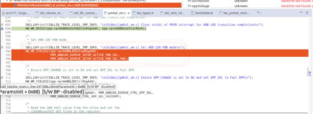

    (3) Initial failed in this function "SBLUtilsConfigAllVoltageRails(oppId)", and I found boot crash in "ABB LDO FBB setting", code crash location as below.
             * Set ABB LDO FBB mode.
            SBLLibPrintf(SBLLIB_TRACE_LEVEL_IMP_INFO, "\n[Gibbs][pmhal_vm.c] Set ABB LDO FBB mode\n");
            HW_WR_FIELD32(opp->prmABBLDOSetupRegAddr,
                          PRM_ABBLDO_DSPEVE_SETUP_ACTIVE_FBB_SEL,
                          PRM_ABBLDO_DSPEVE_SETUP_ACTIVE_FBB_SEL_FBB);
    Few question & support need :
    (1) Beside JTAG debugging, do we have another way to dump E_ID, JTAG ID, and AVS EFuse value from register? becase this function "SBLLibPrintf" only support string output W/O additional arguments.

  • HI, Josue
    Replies as below.
    Q1/A1 : Is one getting further than the other? So both lots are booting now?
    Customer claim they do not do any HW & SW design change on their customerizes board, so the only different is TDA2 "LOT code".
    Customer use ROCESSOR_SDK_VISION_03_07_x, it can boot on LOT code "69P16CQ ", but it "can not" boot for LOT code "26P1N8Q"
    Because I suspect it may be "SW compatible problem" between TDA2 ROM code and vision SDK, so I try to update to the latest SDK version (ROCESSOR_SDK_VISION_03_08_x) for testing.
    I only make a boot testing for ROCESSOR_SDK_VISION_03_08_x and LOT code "26P1N8Q". I try to add some print function in code, and then it boots even boot still crash finally.

    Share some code that I modificiation before (as attachment) , you can see only add "SBLLibPrintf"
    Sorry, because JTAG do not work, so I use print function to diagnostic the issue.
    https://e2e.ti.com/cfs-file/__key/communityserver-discussions-components-files/791/tda2eg_5F00_test_5F00_code.tgz
    Boot log as below, boot crash may be in "PMHALVMInitABB()" function, so far I have no idea.
    You can search key word "Gibbs" to trace these log.
    program stops (crash) in this string "[Gibbs][pmhal_vm.c] Set ABB LDO FBB mode".

    I try to dump some register, ref as below.  (ex, Die_ID)
    SR 2.1 version,
    Pls let me know if you need more related register information.
    Thank You.
    Gibbs

    debug is ongoing, this is debug status update.
    I use CCS for debuging, recording as below.
    This video show some clues,
    (1) We use JTAG dynamic load/run SBL, it seems SBL boot completely even we still found SBL config  init failed.
    (2) SBL boot from SD, SBL crash in set ABB LDO FBB mode
    Gibbs
  • Gibbs,
    From video, on number 8 you can just click on bypass option for all the cores that you don't want to be initialized with the GEL file.
    Can you please try this with all cores? and see if that makes a difference?
    So if I understand correctly the part number that boots all the way is the one with Lot code 89P16CQ? (Our team checked internally and the lot code starting with a 6 does not exist).
    Also, I believe there is not any difference in ROM code, so this would not be the issue.
    Can you share logs of a successful boot of lot code 89P16CQ?
    -Josue
  • Hi, Jouse.
    Thanks your replies, update as below.
    (1) Your understanding is correct. "89P16CQ" is correct boot LOT code. this is my mistake.
    (2) Sorry I don not have device  LOT code "89P16CQ" on my hand, I can only test on LOT code "26P1N8Q"
    (3) Base on lot code "26P1N8Q" device, I initialized TDA2EG-17 with CCS by default GEL, and load program for each cores, its seems fine.
    May I say there is no issues on SoC which w/ ROM code?  so we need to dedicated debug Board PCBA (schematic) or SBL source code?

    I think SBL should be boot complete, but we still watch two failed,
    (1) --> [Gibbs][sbl_utils_tda2xx.c] SblUtilsConfigGangedVdRails failed
                retVal = SblUtilsConfigGangedVdRails(&gangedVdRails[0],
                                                      numGangedRails,
                                                      oppId);
                SBLLibPrintf(SBLLIB_TRACE_LEVEL_IMP_INFO, "\n[Gibbs] ENTER_17\n");
                if(retVal == PM_SUCCESS){
                    SBLLibPrintf(SBLLIB_TRACE_LEVEL_IMP_INFO, "\n[Gibbs][sbl_utils_tda2xx.c] SblUtilsConfigGangedVdRails success\n");
                else{
                    SBLLibPrintf(SBLLIB_TRACE_LEVEL_IMP_INFO, "\n[Gibbs][sbl_utils_tda2xx.c] SblUtilsConfigGangedVdRails failed\n");
    (2) --> [Gibbs][sbl_tda2ex_main.c] SBLUtilsConfigAllVoltageRails failed
        retVal = SBLUtilsConfigAllVoltageRails(oppId);
        if (PM_SUCCESS != retVal)
            SBLLibPrintf(SBLLIB_TRACE_LEVEL_IMP_INFO, "\n[Gibbs][sbl_tda2ex_main.c] SBLUtilsConfigAllVoltageRails failed\n");
            gSetVoltRailsStatus = STW_EFAIL;
    I am not sure we should deep dive these two failed (SblUtilsConfigGangedVdRails / SBLUtilsConfigAllVoltageRails  failed), becuase it only happens when SBL loads by JTAG.

  • Hi, Jouse.
    CCS Console as below.
    Cortex_M4_IPU1_C0: GEL Output: --->>> TDA2Ex Cortex M4 Startup Sequence In Progress... <<<---
    Cortex_M4_IPU1_C0: GEL Output: --->>> TDA2Ex Cortex M4 Startup Sequence DONE! <<<---
    Cortex_M4_IPU1_C1: GEL Output: --->>> TDA2Ex Cortex M4 Startup Sequence In Progress... <<<---
    Cortex_M4_IPU1_C1: GEL Output: --->>> TDA2Ex Cortex M4 Startup Sequence DONE! <<<---
    Cortex_M4_IPU2_C0: GEL Output: --->>> TDA2xx Cortex M4 Startup Sequence In Progress... <<<---
    Cortex_M4_IPU2_C0: GEL Output: --->>> TDA2Ex Cortex M4 Startup Sequence DONE! <<<---
    Cortex_M4_IPU2_C1: GEL Output: --->>> TDA2xx Cortex M4 Startup Sequence In Progress... <<<---
    Cortex_M4_IPU2_C1: GEL Output: --->>> TDA2Ex Cortex M4 Startup Sequence DONE! <<<---
    C66xx_DSP1: GEL Output: --->>> TDA2Ex C66x DSP Startup Sequence In Progress... <<<---
    C66xx_DSP1: GEL Output: --->>> TDA2Ex C66x DSP Startup Sequence DONE! <<<---
    CortexA15_0: GEL Output: --->>> TDA2Ex Cortex A15 Startup Sequence In Progress... <<<---
    CortexA15_0: GEL Output: --->>> TDA2Ex Cortex A15 Startup Sequence DONE! <<<---
    IcePick_D: GEL Output: Ipu RTOS is released from Wait-In-Reset.
    IcePick_D: GEL Output: Ipu SIMCOP is released from Wait-In-Reset.
    IcePick_D: GEL Output: IVAHD C66 is released from Wait-In-Reset.
    IcePick_D: GEL Output: IVAHD ICONT1 is released from Wait-In-Reset.
    IcePick_D: GEL Output: IVAHD ICONT2 is released from Wait-In-Reset.
    CS_DAP_DebugSS: GEL Output: --->>> CONFIGURE DEBUG DPLL settings to 1.9 GHZs  <<<---
    CS_DAP_DebugSS: GEL Output: > Setup DebugSS 1.9GHz in progress...
    CS_DAP_DebugSS: GEL Output: < Done with Setup DebugSS Trace export clock (TPIU) to 97MHz
    CS_DAP_DebugSS: GEL Output: < Done with Setup DebugSS PLL Clocking 1.9GHz
    CS_DAP_DebugSS: GEL Output: < Done with Setup DebugSS ATB Clocking 380MHz

    (4) I try to download (+execute) SBL by JTAG on device LOT code "26P1N8Q", uart log output as below.

    (1) Customer has two different kinds of lot code device, Both of them are TDA2EG-17. One is 69P16CQ , and the other is 26P1N8Q. 69P16CQ w/SD SBL boots well, but 26P1N8Q is not. Both of two lot code test on "same design" PCBA and SBL binary.
    (2) 69P16CQ device is on customer side, I do not bring it back to TI office for testing, but 26P1N8Q does. So all of test and discussion in under 26P1N8Q in TI office.
    (3) Customer have second DVT build for 26P1N8Q, total 10 pcs with failed rate 100%, each board boot failed.

    So I try to use JTAG to "load symbols" in CCS, and find crash happen in this code.
    (10) Base on SDK (03_08_00), I use JTAG to download SBL to customized board and run it.  (CCS Load program & runs--> sbl_sd_opp_nom_a15_0_release.xa15fg)

    [Gibbs][sbl_utils_tda2xx.c]PMHALVMEnableABB() start
    [Gibbs][pmhal_vm.c] PMHALVMEnableABB() -> PmhalVmGetVoltageDomai()
    [Gibbs][pmhal_vm.c] PMHALVMEnableABB() -> PmhalVmGetOppVoltage()
    [Gibbs][pmhal_vm.c] PMHALVMEnableABB() -> PMHALVMInitABB()
    [Gibbs][pmhal_vm.c] Clear retVal of PRCM interrupt for ABB LDO transition completion
    [Gibbs][pmhal_vm.c] Ensure OPP_CHANGE is set to 0U and set OPP_SEL to Fast OPP
    [Gibbs][pmhal_vm.c] Read the ABB VSET value from the efuse
    [Gibbs][pmhal_vm.c] PM_TIMEOUT
    [Gibbs][pmhal_vm.c] Clear interrupt retVal
    [Gibbs][sbl_utils_tda2xx.c] PMHALVMEnableABB failed, break
    [Gibbs] ENTER_17

    (11) Base on item (9) and item (10), I think there should be no chip issues on TDA2.
    (12) You already tell us, the ROM code version are the same for 26P1N8Q and 69P16CQ
    (13) SBL crash in Set ABB LDO FBB mode in item (9)
    (14) Base on item (10),  altough it can brings up appImage, there is still have "PMHALVMEnableABB() failed".
    It seems have some problems for ABB LDO setting, but I am not sure where the root cause.
    Do you have any idea to debug ABB LDO setting? Is it HW or SW issue?
    Base on item (9) & (10), Why test result is different ?
    Thank You
    Gibbs

    Are these the only two LOT codes the customer uses? Would it be possible for them to share working logs of their other devices?

    I try to "hard code" disable any adaptive body biasing (ABB) register setting, modify as below.
    pmErrCode_t PMHALVMEnableABB(pmhalPrcmVdId_t voltDomId, pmhalVmOppId_t oppId)
        pmErrCode_t retVal                = PM_SUCCESS;
        //uint32_t    timeout               = 0U;
        //uint32_t    intOccurred           = 0U;
        const pmhalVmVoltageDomain_t *vd  = NULL;
        const pmhalVmOppVoltage_t    *opp = NULL;
         * Check if the voltage domain id is valid and the OPP ID is valid
         * for this voltage domain.
         * PmhalVmGetVoltageDomain will return null if voltDomId is out of range.
         * PmhalVmGetOppVoltage will return null if vd is null or oppId
         * is out of range.
        SBLLibPrintf(SBLLIB_TRACE_LEVEL_IMP_INFO, "\n[Gibbs][pmhal_vm.c] PMHALVMEnableABB() -> PmhalVmGetVoltageDomai() \n");
        vd = PmhalVmGetVoltageDomain(voltDomId);
        SBLLibPrintf(SBLLIB_TRACE_LEVEL_IMP_INFO, "\n[Gibbs][pmhal_vm.c] PMHALVMEnableABB() -> PmhalVmGetOppVoltage() \n");
        opp = PmhalVmGetOppVoltage(vd, oppId);
        if (opp == NULL)
            SBLLibPrintf(SBLLIB_TRACE_LEVEL_IMP_INFO, "\n[Gibbs][pmhal_vm.c] PMHALVMEnableABB() -> PmhalVmGetOppVoltage() get opp failed \n");
            retVal = PM_BADARGS;
        else
             * ABB Programming Overview:
             * ABB LDO supports two modes, namely bypass mode and FBB mode.
             * The mode name FBB is used for historical reason but enabling
             * the FBB mode can result in Forward Body Bias (FBB) or
             * Reverse Body Bias (RBB) depending on the VSET_OUT value programmed.
             * The following two registers are involved in ABB Programming:
             * PRM_ABBLDO_<VD>_SETUP:
             *    Bits     Field
             *     0U       SR2EN: Enable/Disable ABB power management.
             *                    This is setup as part of the ABB initialization.
             *               0x0: ABB LDO is put in bypass mode
             *               0x1: ABB is enabled
             *     1       Reserved
             *     2       ACTIVE_FBB_SEL: Defines ABB LDO mode. This is programmed
             *                             as part of enable/disable ABB.
             *               0x0: ABB LDO is in bypass mode
             *               0x1: ABB LDO is in FBB mode
             *     3       Reserved
             *     4       NO CAP: Wheter ABB LDO is cap-less or not
             *               0x0: ABB LDO uses an external capacitor
             *               0x1: ABB LDO doesn't use an external capacitor
             *     5-7     Reserved
             *     8-15    SR2_WTCNT_VALUE: LDO Settling time for active-mode OPP
             *             change. Target is 40 uSec for TDA2xx. This value is in
             *             16 system clock cycles.
             *     16-31   Reserved
             * PRM_ABBLDO_<VD>_CTRL:
             *    Bits     Field
             *     0U-1     OPP_SEL: Select the OPP at which the voltage domain is
             *                      operating. Only the following values are valid
             *                      for TDA2xx
             *               0x0: Nominal (default)
             *               0x1: Fast OPP
             *               0x2: Nominal
             *     2       OPP_CHANGE: When set to 1, initiate an OPP-based ABBLDO
             *                         setting change
             *     3-4     SR2_STATUS: Indicate the current retVal
             *               0x2: ABB LDO is in FBB active mode
             *     5       Reserved
             *     6       SR2_IN_TRANSITION: ABB LDO is in transition state or not
             *               0x0: Not in transition
             *               0x1: Is in transition and SR2_STATUS bits
             *                    are not stable.
             *     7-31    Reserved
             * ABB Initialization:
             * See PMHALVMInitABB() for details.
             * NOTE: The initialization steps need to be performed only once
             *       at the system initialization; however, since we don't
             *       want to maintain state, we do the initialization every time.
             * ABB Enable:
             * To basic steps to enable ABB are:
             * 1. Set the ACTIVE_FBB_SEL bit to 1
             * 2. Set the OPP_SEL to 1 (to indicate Fast OPP)
             * 3. Program the ABB voltage in the LDOVBB<VD>_FBB_VSET_OUT field.
             * 4. Set the LDOVBB<VD>_FBB_MUX_CTRL to 1. The ABB voltage setting can
             *    be read from the efuse or the override value in the VOLTAGE_CTRL
             *    register. Setting this bit to 1 ensures the value from the
             *    VOLTAGE_CTRL register is used.
             * 5. Finally trigger the ABB LDO OPP change by setting OPP_CHANGE to 1
             * Additionally the following needs to be ensured:
             * 1. Clear the ABB LDO transition completion interrupt before starting
             *    the enable sequence.
             * 2. Ensure OPP_CHANGE is zero (override if not) before setting the
             *    OPP_SEL.
             * 3. After triggering the OPP Change (step 5 above) wait for the
             *    transition to complete by checking the transition interrupt.
            //uint32_t abbVsetOut = 0U;
            //uint32_t irqStatus  = 0U;
            SBLLibPrintf(SBLLIB_TRACE_LEVEL_IMP_INFO, "\n[Gibbs][pmhal_vm.c] PMHALVMEnableABB() -> PMHALVMInitABB() \n");
            PMHALVMInitABB(voltDomId, oppId);
             * Clear retVal of PRCM interrupt for ABB LDO transition completion.
            SBLLibPrintf(SBLLIB_TRACE_LEVEL_IMP_INFO, "\n[Gibbs][pmhal_vm.c] Clear retVal of PRCM interrupt for ABB LDO transition completion\n");
            //HW_WR_REG32(opp->prmABBDoneIRQStatRegAddr, opp->prmABBDoneStatMask);
            //HW_WR_FIELD32(opp->prmABBLDOSetupRegAddr,
            //              PRM_ABBLDO_DSPEVE_SETUP_ACTIVE_FBB_SEL,
            //              PRM_ABBLDO_DSPEVE_SETUP_ACTIVE_FBB_SEL_FBB);
             * Ensure OPP_CHANGE is set to 0U and set OPP_SEL to Fast OPP.
            SBLLibPrintf(SBLLIB_TRACE_LEVEL_IMP_INFO, "\n[Gibbs][pmhal_vm.c] Ensure OPP_CHANGE is set to 0U and set OPP_SEL to Fast OPP\n");
            //HW_WR_FIELD32(opp->prmABBLDOCtrlRegAddr,
            //              PRM_ABBLDO_DSPEVE_CTRL_OPP_CHANGE,
            //              0x0U);
            //HW_WR_FIELD32(opp->prmABBLDOCtrlRegAddr, PRM_ABBLDO_DSPEVE_CTRL_OPP_SEL,
            //              PRM_ABBLDO_DSPEVE_CTRL_OPP_SEL_FASTOPP);
             * Read the ABB VSET value from the efuse and set the
             * LDOVBBxxxVSET_OUT filed in the register
             * CTRL_<CORE|WKUP>_LDOVBB_<domain>_VOLTAGE_CTRL.
             * Also ensure that this override VSET value is used by setting the
             * MUX.
            SBLLibPrintf(SBLLIB_TRACE_LEVEL_IMP_INFO, "\n[Gibbs][pmhal_vm.c] Read the ABB VSET value from the efuse\n");
            HW_RD_FIELD32(opp->fuseOPPVminRegAddr,
                                       PMHAL_VM_STD_FUSE_OPP_VMIN_VSETABB);
            //abbVsetOut = HW_RD_FIELD32(opp->fuseOPPVminRegAddr,
            //                           PMHAL_VM_STD_FUSE_OPP_VMIN_VSETABB);
            SBLLibPrintf(SBLLIB_TRACE_LEVEL_IMP_INFO, "\n[Gibbs][pmhal_vm.c] Read the abbVsetOut\n");
            //HW_WR_FIELD32(opp->ctrlLDOVBBVoltageCtrlRegAddr,
            //              PMHAL_VM_LDOVBB_VOLTAGE_CTRL_FBB_VSET_OUT,
            //              abbVsetOut);
            //HW_WR_FIELD32(
            //    opp->ctrlLDOVBBVoltageCtrlRegAddr,
            //    PMHAL_VM_LDOVBB_VOLTAGE_CTRL_FBB_MUX_CTRL,
            //    PMHAL_VM_LDOVBB_VOLTAGE_CTRL_FBB_MUX_CTRL_OCP);
             * Start the ABB LDO OPP Change.
            //              PRM_ABBLDO_DSPEVE_CTRL_OPP_CHANGE, 0x1U);
             * Wait till the transition is complete by checking the DONE bit.
             * The transition takes 50us; use 100us timeout delay to gives some
             * buffer.
            //timeout     = 100U;
            //intOccurred = 0U;
            //while ((intOccurred == 0U) && (timeout != 0U))
            //    PMUtilsMinDelayUS((uint32_t) 1U);
            //    intOccurred = HW_RD_REG32(opp->prmABBDoneIRQStatRegAddr) &
            //                  opp->prmABBDoneStatMask;
            //    timeout = timeout - 1U;
            //if (timeout == 0U)
            //    SBLLibPrintf(SBLLIB_TRACE_LEVEL_IMP_INFO, "\n[Gibbs][pmhal_vm.c] PM_TIMEOUT\n");
                retVal = PM_TIMEOUT;
             * Clear interrupt retVal.
            SBLLibPrintf(SBLLIB_TRACE_LEVEL_IMP_INFO, "\n[Gibbs][pmhal_vm.c] Clear interrupt retVal\n");
            //irqStatus  = HW_RD_REG32(opp->prmABBDoneIRQStatRegAddr);
            //irqStatus |= opp->prmABBDoneStatMask;
            //HW_WR_REG32(opp->prmABBDoneIRQStatRegAddr, irqStatus);
        return retVal;

    My question.
    (1) Base on my test result, I think the issue should be very clear. Why SBL crash in ABB register setting? (ex:HW_WR_FIELD32)
    (2) Is it necessary to enable ABB for TDA2EG-17?
    Need you provide debug suggestion.
    Thank You.
    Gibbs

    Anyhow, I've heard back from the HW team and ABB can be disabled.
    Can you compare the following once you have a working sample:
    Can you compare these registers:
    The ABB LDO target value can be read from CTRL_CORE_STD_FUSE_OPP_VMIN_xxx_y[24:20] VSETABB bits, if  CTRL_CORE_STD_FUSE_OPP_VMIN_xxx_y[25] ABBEN is set to 0x1.
    ABBEN defines whether ABB should be used and this is dependent upon the specific OPP and voltage domain.
    -Josue

    Q1/A1 : What is the failure rate? 100% of this LOT code only?
    Feed back from customer
    Here are failed LOT code SoC : 89P16CQ / 36P11VQ / 26P1RLQ / 26P1N8Q * 4 PCS
    Build 7 PCS, all of them boot failed. so far, I do not see any boot failed reason with specific LOT code.
    Q2/A2 : Can you compare the following once you have a working sample
    So we use same SBL "w/ ABB enable" binary, the only different is that one runs on "old board", and another runs on "new board".
    "new board" have boot failed issue
    Old & new board almost have the same schematic deign and layout, but the different is that new board remove eMMC/OSPI flash.

    We found old board detect "ABB support = false", so I guess that's why it can boot success.
    New board detect "ABB support = true", so I that is why  boot crash happens when ABB enable.
    So far I do not have idea why SBL detect ABB support is true.

    Q3/A3 : Can you compare these registers
    So base on Q2/A2, I assume SBL detect "ABB Support  or not" which is depend on "ABBEN" bit.
    Related register for TDA2EG_17.
    Al of them "ABBEN" bit is false.
    Curious to know :
    (1) Which register define "oppVoltage->isABBSupported" or not?
