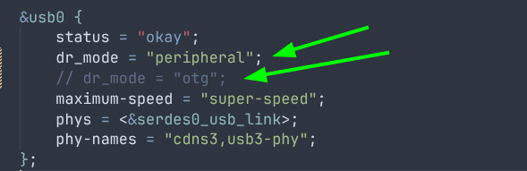

I've been working on making a custom board with AM69A. And I would like to set the AP as USB 3.0 device(peripheral) mode so that I can transfer message in high bps.
According to the TRM document, the AP's USB 3.0 interface supports DRD(Dual Role) feature. I got some questions relate to this feature :

Test procedure I did on SK-AM69:
1. Change device tree
Set dr_mode to "peripheral" on k3-am69-sk.dts
2. Run scripts & test program

3. Connect Host PC with to the board. (Type A to C)
Nothig showed up on Host PC. (used lsusb)
