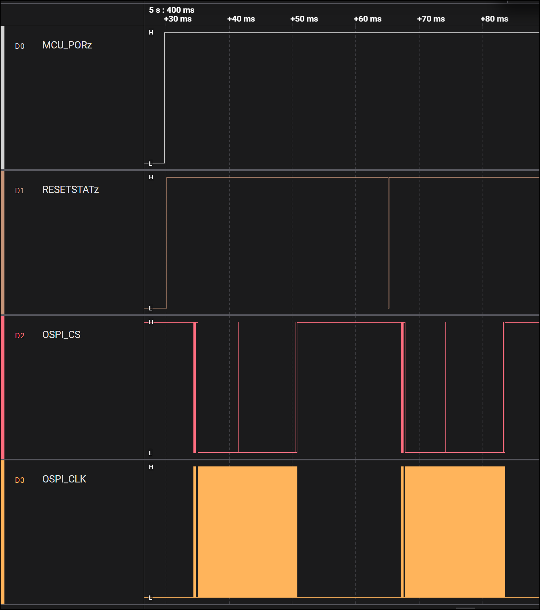

During a successful QSPI boot, I have captured the following signals: MCU_PORz, RESETSTATz, OSPI_CLK, OSPI_CS.  I'm observing that roughly 35mS after RESETSTATz goe high it has a 160uS period where it drops low.  Looking at the logic capture and identical timing characteristics it appears that ROM boot occurs twice.  Is this expected behavior?
