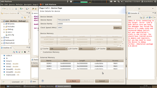

  • Hello Uday,
    I have tried but while Configuring memory I have done everything as shown in video of RTSC as as you stated, but it is giving me some message like Check Code memory like that. I think I am missing something here. Is there any Video or tutorial I can go through for that. I will appreciate your help.
    Thanks.
  • Hi Arun,
    You can go through the SYS/BIOS guide (especially chapter on Memory) at http://www.ti.com/lit/ug/spruex3j/spruex3j.pdf for more details.
    For your reference, I have also attached an example RTSC platform package for 6678 that we used for one of our demo projects. 2337.evm6678.zip. You can unzip 'evm6678.zip' and view it in CCS by going to Tools --> RTSC Tools --> Platform --> Edit/View.
  • Hello Uday,
    Thanks for your reply. It give me some sort of clear picture what actually is going on. Well, I have tried with one 3 *3 matrix multiplication and I am trying to get some time elapsed in that computation by each core or on combining cores together at different memory locations and then profile it. But, Same program is running fine on different IDE's, but on CCSv5.1, When I include  #include <sys/time.h>,  on compilation it is giving me an error message that could not open source file "sys/time.h". is this problem with eclipse, or i am missing something here.
    Thanks.

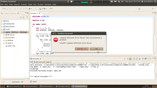

  • Replace "#include <sys/time.h>" with "#include <time.h>". With that, it should pick up the file from "ccsv5/tools/compiler/c6000/include/time.h"
  • Hello Uday,

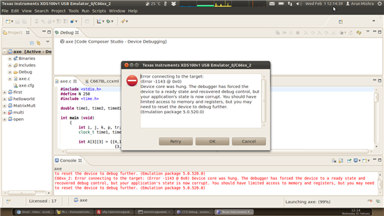

    Thanks for the reply. I have tried that. Well, new problem has been arisen when I am trying to debug my Program on CCS, It is giving me an error message:
    This I am getting on every debug and I have reset the board, I have restarted the System But no help.
    I am also getting one more Error, Like this.:
    Any Help? Thanks.
  • Hello Uday, I think By mistake I have not attached original Error message which I am getting on every Debugging. Here it is:
    Thanks.
  • Arun,
    About the 'target connect' issue, can you ensure you have the latest emilation drivers :
    http://software-dl.ti.com/sdoemb/sdoemb_public_sw/bios_mcsdk/latest/index_FDS.html
  • Hello Varada,
    Yes, I have the latest emulation drivers installed.
    Thanks.
  • Arun,
    There are multiple reasons for this type of issue. Maybe, your executable is accessing memory that is not mapped. Where are your data buffers stored ?
    One way to isolate the issue is to run your test on a simulator. You can use either C6678 Functional /Cycle accurate Simulator.
    Let us know so that we can assist further.
  • Hello Varada,
    I have Just tried with Simulator and It gives me Same error message. As far as Memory mapping is concerned, I was using default one, at this moment because I am trying to run only one simple Matrix multiplication of 3*3 Matrix and trying to see the time elapsed during that on various front. I have attached snapshot of memory thing for You:
    Thanks.
