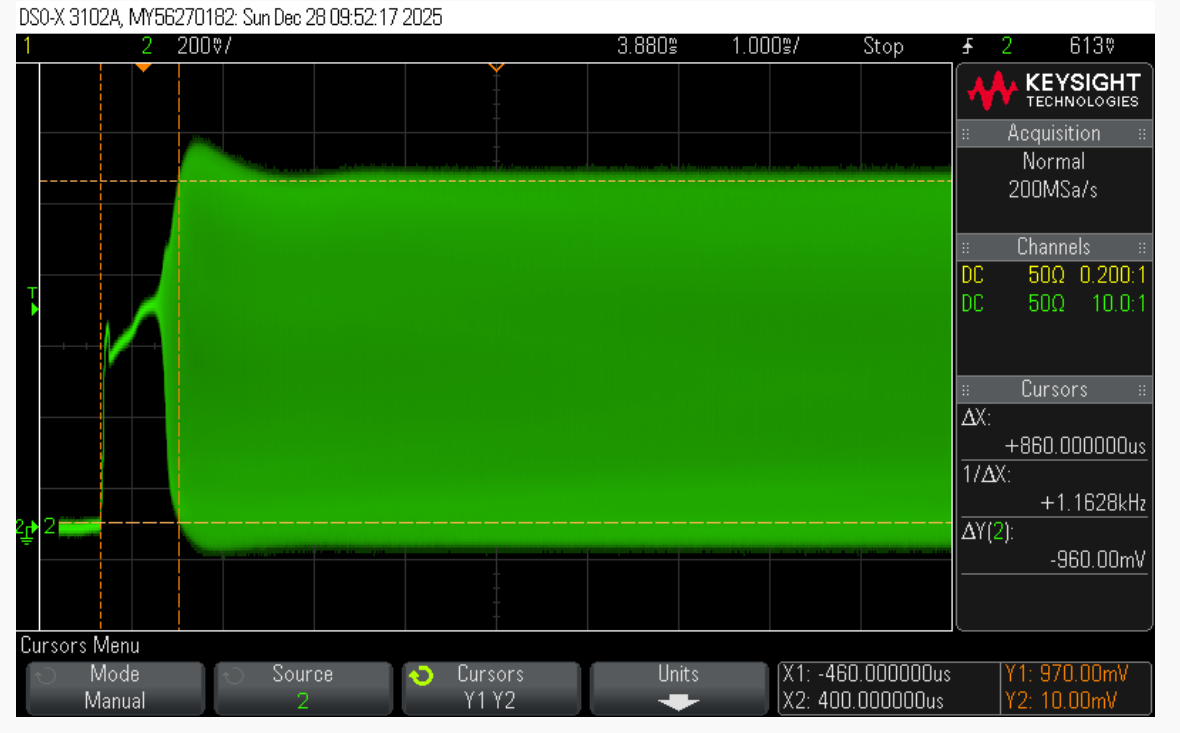

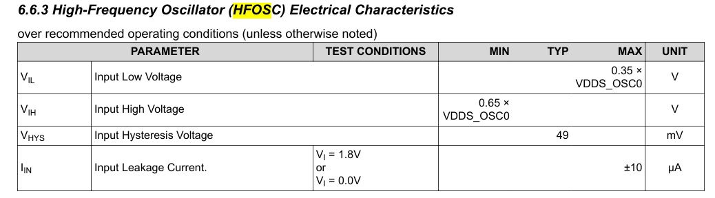

1. When we tested the 25MHz crystal waveform of the TDA4VEN-Q1, VIH was 1.034V, which failed and does not meet the electrical characteristics requirement of 0.65*VDDS_OSC0 = 1.17V specified in section 6.6.3 High-Frequency Oscillator (HFOSC) of the manual.
2. In addition, VIL was -0.53V, which exceeds the MCU_OSC0_XI IO tolerance of -0.3V. Is there a risk?
3. Can we refer to the answer on E2E that for the crystal, we do not need to pay attention to the actual VIH & VIL values, only the Vpp is important?

4. The digital levels provided in the datasheet only apply when sourcing a reference clock from an LVCMOS clock source. They are not applicable to the VIH & VIL requirements of a crystal circuit?
