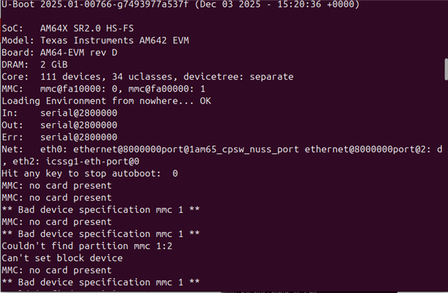

I am working with an AM64x EVM and trying to boot Linux completely from eMMC (no SD card), following the Processor SDK documentation.
        What works
  • Linux boots correctly from SD card
  • Kernel, DTB, and rootfs are present and verified on eMMC
  • SPL and U-Boot load successfully when boot mode is set to eMMC
    What I did
    1. Booted Linux from SD card
    2. Flashed tiboot3.bin, tispl.bin, u-boot.img to eMMC boot0
    3. Created ext4 partition on eMMC user area (mmcblk0p1)
    4. Copied kernel, DTB, and full rootfs to eMMC
    5. Set: mmc partconf 0 1 1 1
               mmc bootbus 0 2 0 0
      Problem

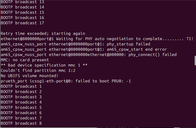

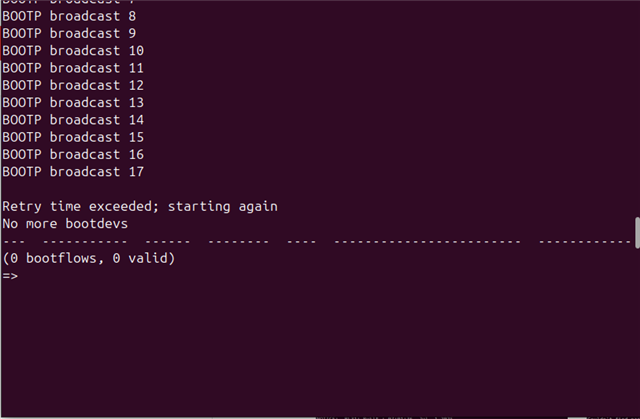

      When SD card is removed and boot mode is set to eMMC:
      • SPL and U-Boot start correctly
      • U-Boot keeps trying to boot from mmc1 (SD) and fails:
        MMC: no card present Couldn't find partition mmc 1:2
      • Linux never boots from eMMC
      • The complete boot logs is attaching here:
        So can you help me to get rid of this isssue.
