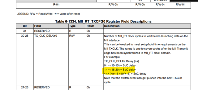

Follow the TRM 0x300B2010 setting those delay. customer has setting bit28-31 to 1 and TRM introduce this will delay 15-20us. But compare change or no change 0x300B2010 the wave doesn't change anything.

  • Now they want delay data signal ~20 us.
    20us? This setting only allows ns range tweaks. Why do they need to delay this ?

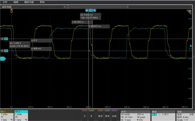

  • Can you try a higher value like 6 or 7 and see whether this is taking effect. Also for testing purposes, you can always update this from memory browser if you have access to DUT via JTAG.
  • Hi Pratheesh:
    Has changed bit30-28 to 0x6. but probe the PRG1_PRU0 ball do not delay. Below is the pin V9/pin AA8 capture wave. clock falling edge and data just 1.19999us delay.

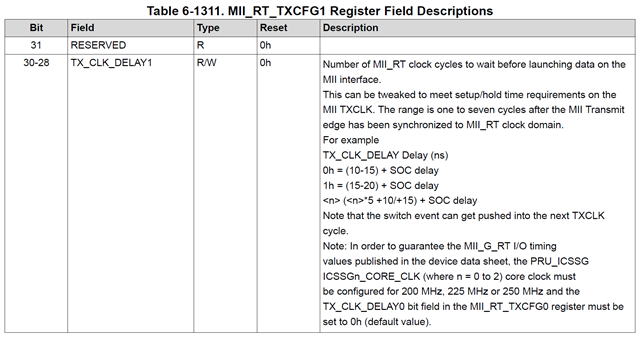

  • Hi Experts:

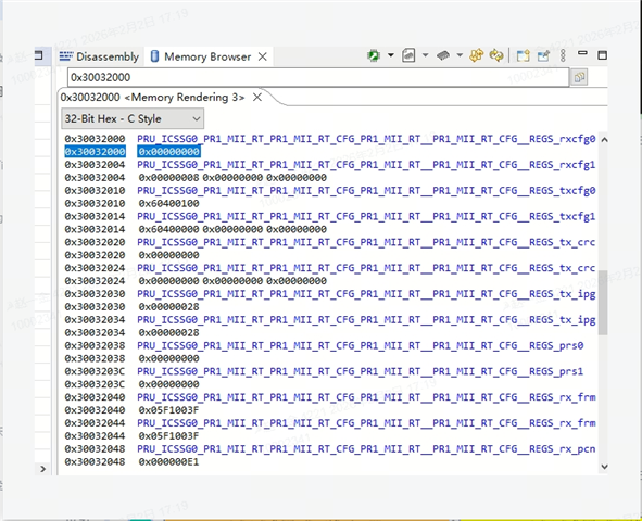

    As you suggest that we try changing MII_RT_TXCFG1 register instead? Reason is due to Port swap in MII mode. _TXCFG1 controls PHY0 delay and _TXCFG0 controls PHY1 delay.
    Looks like change 0x30032012 register bit 30-28 value to 0x01 and 0x06 test ball pin V9 PRG1_PRU0_GPO16 and ball pin AA8 PRG1_PRU0_GPO11. The MII clock/data do not add 20ns delay. Below are the capture wave.
    Could you please check except change TXCFG1/TXCFG0 whether has another register need modified?
    Best Regards!
    0x30032012 bit 30-28 =0x1
    0x30032012 bit 30-28 =0x6
  • Hi experts:
    This is 0x30032012 value. FYI
    Han Tao
  • Hi Tao,
    Just to clarify, is the customer using ICSSG1 instance or ICSSG0 instance? From the conversations above, ICSSG1 (0x300B2012) is being used. Is there any specific reason why 0x30032012 (ICSSG0 offset) is modified?
    The customer will have to try changing 0x300B2014 (MII_RT_TXCFG1):

  • Apologies for the confusion in my previous reply.
    2. Last week Pratheesh told us that AM24x is Port swap. TXCFG1 control PHY0 delay we change 0x30032012 again. You can see that capture wave several minutes ago.
    0x30032000 to 0x3003206C is the location for ICSSG0 PRU_MII_RT_MII_RT Registers.
    In your case, the setup is using ICSSG1 instance, for which the corresponding registers are from 0x300B2000 to 0x300B206C.
    So, as per the previous suggestion, in order to change MII_RT_TXCFG1 of ICSSG1 instance, the customer will have to modify 0x300B2014.bit30-28.

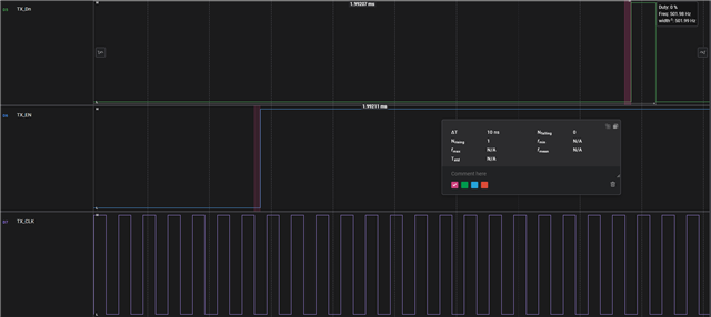

  • Hi Tao,
    I tested the following topology:
    TwinCAT <> ET2000 <> AM243x-LP (SubDevice)
    I modified 0x300B2017 (bit28-30) Register to 0x01, 0x02 and 0x03.
    The observation is that at values 0x01 and 0x02, the TwinCAT reports lost frame continously until the TX_CLK_DELAY0 is reverted back to 0. At 0x03, the SubDevice goes into INIT_ERR state.
    Do note that I used logic analyzer (saleae) to probe the TX_CLK, TXD0, TXD1, TXD2 and TXD3 of PHY0 (ICSSG1 Port0) but the delay wasn't visible much. I will have to use an oscilloscope to check for the presence of the delay in the TX data line.
    My follow-up question is that is the customer seeing this MainDevice behavior (Lost frame and INIT_ERR) when updating the corresponding TX_CLK_DELAY0 ?
    Aaron

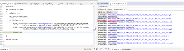

  • Hi Aaron:
    Appreciate help us verify those wave at EVM board. From your result maybe those 0x300B2017 just affect AM64/AM24x internal delay, do not change hardware waveform level delay.
    Because this register customer feedback that they just can 0x300B2017 before load ind_comms_sdk_am243x_2025_00_00_08 PRU firmware, the register value will be changed by PRU firmware. They just can change it through JTAG. So the lost frame rate at YT8522 whether change 0x300B2017 to 0x1 or 0x6 they can not confirm it.
    Below two pictures are the register change at customer code. FYI
    Best Regards!
    Han Tao
  • Hi Tao,
    If 0x300B2017 is modified before PRU firmware is loaded, then the firmware will over-write it with the default value.
    Can I get details on the topology you are testing for the TX_CLK_DELAY impact, more specifically, the MainDevice used? Updating 0x300B2017 through JTAG after PRU should be good enough for understanding and debugging the impact.

  • Hi Han,
    So I was able to successfully program TX_CLK_DELAY1 with the above mentioned topology and following is my observation:
    • TX_CLK_DELAY1 = 0x1
      • The observation is that a delay of 4-6ns is seen with respect to TX_CLK
    • TX_CLK_DELAY1 = 0x2
      • The observation is that a delay of 8-10ns is seen with respect to TX_CLK
    • TX_CLK_DELAY1 = 0x3
      • The observation is that a delay of 12-14ns is seen with respect to TX_CLK
    Do note that the above tests are done by modifying the register from the Memory Browser available in the CCS workspace. I will also try similar by modifying it from the EtherCAT driver as well to see if it is getting overwritten by the firmware during firmware initialization.
    Aaron

  • hi Aaron:
    Confirmed with customer. They change those register can get same results like you.
    When AM24x board start up and after PRU firmware start run. Software change those register the packet loss will disappear.
    Customer will continue optimize their software with us and this case we can close it.
