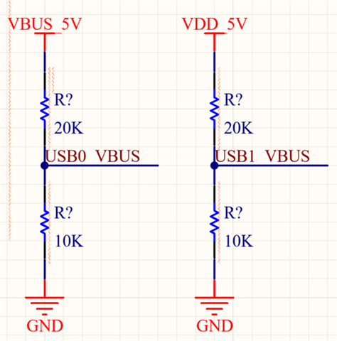

We are working on AM6254 based custom design and want some clarification regarding the USB interface pins usage.
Use-case:
  • USB0 port will be used for USB DFU boot only.
  • USB1 port will be used to connect the cellular module (M.2 form factor).
List of queries:

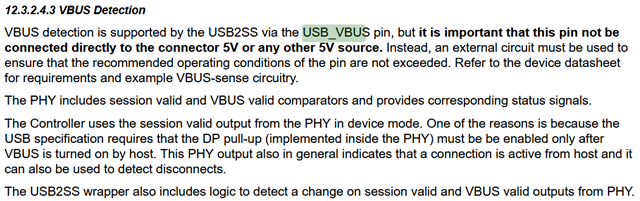

  1. As per our understanding, for both the USB ports, a voltage divider of 20K and 10K is sufficient (reference from the schematic checklist), as per the use-case as shown in the image below. Please confirm.
    For Port 0, AM6254 will be in the USB device mode and for Port 1, AM6254 will be in USB host mode.
2. As per our understanding, as per our use-case, we won't require the USBx_DRVVBUS pin to be connected, so we have Test points on that pin. Please confirm.
Please provide your input for both points.
Thanks & Regards,
Sahil Nayak
