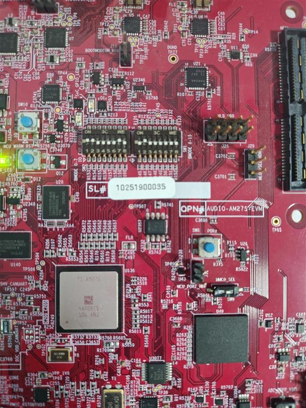

AM2754-Q1: Need help with SD boot mode setup on AUDIO-AM275-EVM
Part Number: AM2754-Q1
Hello Team,
I tried to switch to SD boot mode by setting the SW1 and SW2 as shown in AM275-AWE-SDK_11.01.16.06/mcu_plus_sdk/am275x/docs/api_guide_am275x/EVM_SETUP_PAGE.html (also the attachment here)
and copying the files app_dsp0_0, app_r50_0 and tiboot3.bin to the SD card. However, I see the below error on JTAG UART console:
[BOOTLOADER_PROFILE] Boot Media       : SD Card
[BOOTLOADER_PROFILE] Boot Image Size  : 2429 KB
[BOOTLOADER_PROFILE] Cores present    :

Assertion @ Line: 1033 in /nightlybuilds/mcupsdk_internal/jenkins/freertos_sdk_am275x_11_01_00_16/source/networking/enet/core/src/per/V1/cpsw.c: hCpsw->hRxRsvdFlow != NULL
Did I miss something or do something wrong here? Can you please help fix this?
  • Hi Sreekanth,
    Can you try to use the tiboot3.bin I have sent in this thread -
    RE: AM275-AWE-SDK: Unable to boot the AUDIO-AM275-EVM board with AWE SDK v11.01.16.06
    I remember in the older SDK, there was some problem. Can you try once with the tiboot3.bin here - v11.01.16.6.zip
    Or maybe you can give a try with the new awe sdk v11.2
    Ritapravo
  • Hi Ritapravo,
    Thanks for the response and sharing the files. With both the versions you have shared above, I'm seeing a successful boot!
    1. With 0820.tiboot3.bin, I see:

    2. With the tiboot3.bin in v11.01.16.6.zip, I see:

    So, I can use either of these? Unfortunately, moving to the latest SDK is not an option for now (though we will do so in the near future). Since we are working with AM275-AWE-SDK_11.01.16.06, which of the tiboot3.bin versions you shared above do you recommend using (unless they are one and the same)?
    Sreekanth
  • Hi Sreekanth,
    I don't think there is any difference between the tiboot3.bin files. Either one of these should work without any issues.
    Ritapravo
  • Hi Ritapravo,
    Thanks for the confirmation and support. Will do.
    Sreekanth
