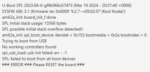

I am using am62a7 EVM and i am trying to boot from USB MSC method.
I have generated tiboot3.bin, tispl.bin, u-boot.img by using "am62ax_evm_r5_usbmsc_defconfig".
Bootmode pin conf for USB MSC "SW2 [1-8] --> 11001010    SW3 [1-8] --> 10000000"
It is binaries build successfully. When i tried to boot from USB MSC boot mode it is showing below error message.
Can you please see why stack overflow and USB controller not initialize.

  • Hi Pankaj,
    Some additional changes are required to get the USB-MSC working.
    The k3-am62a7-sk.dts need to be updated to enable the USB controller and PHY nodes required for USB MSC boot on AM62Ax.
    diff --git a/arch/arm/dts/k3-am62a7-sk.dts b/arch/arm/dts/k3-am62a7-sk.dts
    index 8b5c25431d4..28b11ffa183 100644
    --- a/arch/arm/dts/k3-am62a7-sk.dts
    +++ b/arch/arm/dts/k3-am62a7-sk.dts
    @@ -327,7 +327,9 @@
     &usb0 {
    -	dr_mode = "peripheral";
    +	usb-role-switch;
    +	bootph-all;
    +	dr_mode = "host"; /* Changed from peripheral to host */
     &main_i2c0 {
    Also, if you are getting the FAT cluster size error
    Error: FAT cluster size too big (cs=32768, max=16384)
    update the am62ax defconfigs as below, to make the cluster size 32K.

    With these changes, you should be able to get the USB MSC working.
    I'm sharing the working logs below.

  • Hi Vinu,
    I have done the changes at my end as you suggested. but the problem is still same.
    I have made the changes in u-boot dts  k3-am62a7-sk.dts
    and also in defconfig files sharing with you and build with changes in local.conf file "am62ax_evm_r5_usbmsc_defconfig".

    I am getting the same error. Is i am missing something please let me know
    Pankaj Verma
  • Hi Pankaj,
    Are you trying this out on the EVM or a custom board?
    Can you try changing the USB stick? Please try with a USB2.0 stick?
    Vinu
  • HI Vinu,
    I am trying this on evm am62a7. I am using yocto image sdk 9.02.
    I have tried with 2 different usb stick which is 2.0 only. result is same. "no working controller found".
    Is i am missing something. Or anything else i need to modify.
    Can you please share me the full path of u-boot k3-am62a7-sk.dts so i will verify at my end also.
    Pankaj Verma
  • Hi Pankaj,
    It would either be because of the DTS changes not coming into effect, or the USB stick not getting partitioned correctly.
    To partition the USB stick, there is a script given along with the mcu_plus_sdk at <mcu_plus_sdk>/tools/boot/scripts/sd_partitioner/partition.sh which should be run as below
    sudo ./partition.sh --device <device>
    Once it creates the partitions, copy the tiboot3.bin, tispl.bin and u-boot.img to the boot partition.
    Can you also describe how you have patched the sources and rebuilt the u-boot?
    It is given in the patch - workspace/sources/u-boot-ti-staging/arch/arm/dts/k3-am62a7-sk.dts
    Vinu
  • HI Vinu,
    Thanks for quick reply,
    I have converted uboot k3-am62a7-sk.dtb file into k3-am62a7-sk.dts file and it showing that the changes are reflected. i am sharing with you doe your reference.

    i didn't find any ./partition.sh file in my "mcu_plus_sdk_am62ax_10_01_00_33" sdk in window system.
    if possible can you share the boot file with me also so i can test in my EVM.
    I have clean full sdk and build again but still facing the issue.
    Can you suggest where i can look into.
    Thank
    Pankaj Verma
  • Hi Pankaj,
    I'm sharing a script to partition the disk correctly.
    Please try it out. (From a Linux host PC)
    # Define your target device
    export DEV=/dev/<device>
    sudo umount ${DEV}* 2>/dev/null
    sudo dd if=/dev/zero of=$DEV bs=1M count=10 conv=notrunc
    sudo fdisk $DEV << EOF
    o
    n
    p
    1
    +62M
    n
    p
    2
    t
    1
    c
    a
    1
    w
    EOF
    sudo partprobe $DEV
    sleep 2
    # Format Partitions
    sudo mkfs.vfat -F 32 -n "boot" ${DEV}1
    sudo mkfs.ext4 -L "rootfs" ${DEV}2
    sync
    lsblk -f $DEV
    I'm sharing the working tiboot3.bin below.
     7612.tiboot3.zip
    Vinu
  • Hi Vinu,
    Thanks for tiboot3.bin file.
    After replacing your boot file, boot is started but it is not jumping into kernel image.
    logs for your reference.
    U-Boot SPL 2023.04-ti-g94b9fba1d4cc (Jan 29 2026 - 09:56:51 +0000)
    SYSFW ABI: 3.1 (firmware rev 0x0009 '9.2.7--v09.02.07 (Kool Koala)')
    am62a_init: board_init_f done
    SPL initial stack usage: 13568 bytes
    SPL possible initial stack overflow detected!!
    am62a_init: spl_boot_device: devstat = 0x153 bootmedia = 0x2a bootindex = 0
    Trying to boot from USB
    Bus usb@31000000: Register 1000840 NbrPorts 1
    Starting the controller
    USB XHCI 1.10
    scanning bus usb@31000000 for devices... 2 USB Device(s) found
           scanning usb for storage devices... 1 Storage Device(s) found
    Authentication passed
    Starting ATF on ARM64 core...
    NOTICE:  BL31: v2.10.0(release):v2.10.0-367-g00f1ec6b87-dirty
    NOTICE:  BL31: Built : 16:09:05, Feb  9 2024

    I have put some log in usb driver and it is showing that uc_drv id is not matching with actual id.
    start uclass_get
    uclass_get uclass_find 117
    start uclass_find
    uclass_find outside uc->uc_drv->id -442503144 key 117
    end uclass_find
    usb_init enter
    start uclass_get
    start uclass_find
    uclass_find if uc->uc_drv->id 117 key 117
    uclass_get end
    usb_init ret 0 UCLASS_USB 117usb_init else
    usb_init uc_priv =uclass_get_priv(uc)
    after foreach_dev controllers_initialized 0 usb_started 0
    start uclass_get
    uclass_get uclass_find 119
    start uclass_find
    uclass_find outside uc->uc_drv->id -442503144 key 119
    end uclass_find
    No working controllers found
    end usb init
    spl_usb_load: usb init failed: err - -1
    SPL: failed to boot from all boot devices
    ### ERROR ### Please RESET the board ###
    I think driver not initialized in this sdk can you please suggest how to enable usb driver.
    In dts file having change which is suggested by you.
    Pankaj Verma
  • Hi Pankaj,
    In the R5 SPL environment, the memory is extremely limited.
    There is already a stack overflow warning being printed (even from my tiboot3.bin). The additional debug prints can contribute more to this.
    The value -442503144 looks like a memory corruption.
    Try the following
    1. Remove debug prints
    2. Remove unnecessary configs from the r5 defconfig.
    3. Increase the size of stack within the SRAM limits.
    Also, please answer the queries and try out the suggestions in my previous responses.
    I wouldn't be able to help you better without getting proper responses.
    Vinu

    we have 2 different instance where we downloaded 2 different sdk 9.02 with ubuntu linux 22.04.
    here we are using command line in which we can edit source file using vim editor, save and build file.
    Have you tested on separate host PC's with Yocto? Can you try from SDK build too?
    As i have mentioned that we are using We are using GCP (Google Cloud Platform). here we are build sdk as i have explained previously.
    Any other information do you want from my side please let me know.
    Pankaj Verma
  • Hi Pankaj,
    Can you share the path in which you are editing the source file?
    Vinu
  • HI Vinu,
    for uboot dts
    /home/satyajeet_singh/sdk9.02/yocto-build/build/arago-tmp-default-glibc/work/am62axx_evm-oe-linux/u-boot-ti-staging/1_2023.04+gitAUTOINC+f9b966c674-r0_tisdk_3_edgeai_4/git/arch/arm/dts/k3-am62a7-sk.dts
    for local.conf
    /home/satyajeet_singh/sdk9.02/yocto-build/build/conf/local.conf
    for defconfig
    /home/satyajeet_singh/sdk9.02/yocto-build/build/arago-tmp-default-glibc/work/am62axx_evm-oe-linux/u-boot-ti-staging/1_2023.04+gitAUTOINC+f9b966c674-r0_tisdk_3_edgeai_4/git/configs
    thanks
    Pankaj Verma
  • Hi Pankaj,
    The temp directory hack is usually not recommented as Yocto might ignore the changes and may re-fetch the files again.
    It is also inconsistent and unpredictable.
    The right way to update the the sources are either using Yocto devtool or by creating bbappend files.
    Please try the changes with either
    1. Yocto devtool package modification (https://docs.yoctoproject.org/dev-manual/devtool.html#use-devtool-modify-to-modify-the-source-of-an-existing-component), or
    2. Linux SDK build (https://software-dl.ti.com/processor-sdk-linux-rt/esd/AM62AX/09_02_00/exports/docs/linux/Foundational_Components/U-Boot/UG-General-Info.html)
    Also, I was able to boot the prebuilt Linux (latest) using the USB MSC with u-boot from SDK 9.02.
    But the same DT changes are required for Linux as well. So you'll have to recompile the Linux DTB, so that the port is set as host.

    Please find the complete log along with the u-boot commands below.
    U-Boot SPL 2023.04 (Jan 29 2026 - 10:36:45 +0530)
    USB XHCI 1.10
    U-Boot SPL 2023.04 (Jan 29 2026 - 10:35:58 +0530)
    USB XHCI 1.10
    U-Boot 2023.04 (Jan 29 2026 - 10:35:58 +0530)
    SoC:   AM62AX SR1.0 HS-FS
    Model: Texas Instruments AM62A7 SK
    DRAM:  2 GiB (effective 4 GiB)
    Core:  58 devices, 28 uclasses, devicetree: separate
    MMC:   mmc@fa10000: 0, mmc@fa00000: 1
    Loading Environment from nowhere... OK
    In:    serial@2800000
    Out:   serial@2800000
    Err:   serial@2800000
    Net:   eth0: ethernet@8000000port@1
    Hit any key to stop autoboot:  0
    => usb start
    starting USB...
    USB XHCI 1.10
    => load usb 0:2 ${kernel_addr_r} /boot/Image
    21029376 bytes read in 552 ms (36.3 MiB/s)
    => load usb 0:2 ${fdt_addr_r} /boot/dtb/ti/k3-am62a7-sk.dtb
    61923 bytes read in 24 ms (2.5 MiB/s)
    => setenv bootargs "console=ttyS2,115200 root=/dev/sda2 rw rootwait"
    => booti ${kernel_addr_r} - ${fdt_addr_r}
    ## Flattened Device Tree blob at 88000000
       Booting using the fdt blob at 0x88000000
    Working FDT set to 88000000
       Loading Device Tree to 000000008ffed000, end 000000008ffff1e2 ... OK
    Working FDT set to 8ffed000
    Starting kernel ...

    [    2.514872] mmc0: CQHCI version 5.10
    [    2.559815] mmc0: SDHCI controller on fa10000.mmc [fa10000.mmc] using ADMA 64-bit
    [    2.638583] mmc0: Command Queue Engine enabled
    [    2.643048] mmc0: new HS200 MMC card at address 0001
    [    2.648481] mmcblk0: mmc0:0001 G1M15L 29.6 GiB
    [    2.654516] mmcblk0boot0: mmc0:0001 G1M15L 31.5 MiB
    [    2.660363] mmcblk0boot1: mmc0:0001 G1M15L 31.5 MiB
    [    2.666134] mmcblk0rpmb: mmc0:0001 G1M15L 4.00 MiB, chardev (239:0)
    [    2.707980] usb 1-1: new high-speed USB device number 2 using xhci-hcd
    [    2.800695] tps6594-rtc tps6594-rtc.6.auto: registered as rtc1
    [    2.807190] pca953x 1-0022: supply vcc not found, using dummy regulator
    [    2.813913] pca953x 1-0022: using AI
    [    2.824656] mmc1: CQHCI version 5.10
    [    2.825052] clk: Disabling unused clocks
    [    2.836632] ALSA device list:
    [    2.839598]   No soundcards found.
    [    2.865497] usb-storage 1-1:1.0: USB Mass Storage device detected
    [    2.871940] scsi host0: usb-storage 1-1:1.0
    [    3.904472] scsi 0:0:0:0: Direct-Access      USB      SanDisk 3.2Gen1 1.00 PQ: 0 ANSI: 7
    [    3.913697] sd 0:0:0:0: [sda] 120164352 512-byte logical blocks: (61.5 GB/57.3 GiB)
    [    3.922341] sd 0:0:0:0: [sda] Write Protect is off
    [    3.927446] sd 0:0:0:0: [sda] Write cache: disabled, read cache: enabled, doesn't support DPO or FUA
    [    3.939920]  sda: sda1 sda2
    [    3.943216] sd 0:0:0:0: [sda] Attached SCSI removable disk
    [    4.350118] sdhci-am654 fa00000.mmc: Power on failed
    [    4.385685] mmc1: SDHCI controller on fa00000.mmc [fa00000.mmc] using ADMA 64-bit
    [    4.445497] EXT4-fs (sda2): recovery complete
    [    4.453109] EXT4-fs (sda2): mounted filesystem 4c180f2c-a2bb-49bb-8343-d42b274c119d r/w with ordered data mode. Quota mode: none.
    [    4.464819] VFS: Mounted root (ext4 filesystem) on device 8:2.
    [    4.472000] devtmpfs: mounted
    [    4.475594] Freeing unused kernel memory: 2496K
    [    4.480194] Run /sbin/init as init process
    [    4.802929] systemd[1]: System time before build time, advancing clock.
    [    4.849171] NET: Registered PF_INET6 protocol family
    [    4.855011] Segment Routing with IPv6
    [    4.858715] In-situ OAM (IOAM) with IPv6
    [    4.902410] systemd[1]: systemd 255.13^ running in system mode (+PAM -AUDIT -SELINUX -APPARMOR +IMA -SMACK +SECCOMP -GCRYPT -GNUTLS -OPENSSL +ACL +BLKID -CURL -ELFUTILS -FIDO2 -IDN2 -IDN -IPTC +KMOD -LIBCRYPTSETUP +LIBFDISK -PCRE2 -PWQUALITY -P11KIT -QRENCODE -TPM2 -BZIP2 -LZ4 -XZ -ZLIB +ZSTD -BPF_FRAMEWORK -XKBCOMMON +UTMP +SYSVINIT default-hierarchy=unified)
    [    4.934314] systemd[1]: Detected architecture arm64.
    Welcome to Arago 2023.10!
    [    4.952728] systemd[1]: Hostname set to <am62axx-evm>.
    [    5.309079] systemd[1]: /etc/systemd/system/sync-clocks.service:11: Standard output type syslog is obsolete, automatically updating to journal. Please update your unit file, and consider removing the setting altogether.
    [    5.380948] systemd[1]: Queued start job for default target Multi-User System.
    [    5.427799] systemd[1]: Created slice Slice /system/getty.
    [  OK  ] Created slice Slice /system/getty.
    [    5.449839] systemd[1]: Created slice Slice /system/modprobe.
    [  OK  ] Created slice Slice /system/modprobe.
    [    5.473665] systemd[1]: Created slice Slice /system/serial-getty.
    [  OK  ] Created slice Slice /system/serial-getty.
    [    5.497272] systemd[1]: Created slice User and Session Slice.
    [  OK  ] Created slice User and Session Slice.
    [    5.520383] systemd[1]: Started Dispatch Password Requests to Console Directory Watch.
    [  OK  ] Started Dispatch Password Requests to Console Directory Watch.
    [    5.544272] systemd[1]: Started Forward Password Requests to Wall Directory Watch.
    [  OK  ] Started Forward Password Requests to Wall Directory Watch.
    [    5.568113] systemd[1]: Expecting device /dev/ttyS2...
    [    5.588166] systemd[1]: Reached target Path Units.
    [  OK  ] Reached target Path Units.
    [    5.608065] systemd[1]: Reached target Remote File Systems.
    [  OK  ] Reached target Remote File Systems.
    [    5.628044] systemd[1]: Reached target Slice Units.
    [  OK  ] Reached target Slice Units.
    [    5.648079] systemd[1]: Reached target Swaps.
    [  OK  ] Reached target Swaps.
    [    5.674359] systemd[1]: Listening on Process Core Dump Socket.
    [  OK  ] Listening on Process Core Dump Socket.
    [    5.696485] systemd[1]: Listening on initctl Compatibility Named Pipe.
    [  OK  ] Listening on initctl Compatibility Named Pipe.
    [    5.721125] systemd[1]: Listening on Journal Audit Socket.
    [  OK  ] Listening on Journal Audit Socket.
    [    5.744713] systemd[1]: Listening on Journal Socket (/dev/log).
    [  OK  ] Listening on Journal Socket (/dev/log).
    [    5.768676] systemd[1]: Listening on Journal Socket.
    [  OK  ] Listening on Journal Socket.
    [    5.788855] systemd[1]: Listening on Network Service Netlink Socket.
    [  OK  ] Listening on Network Service Netlink Socket.
    [    5.813413] systemd[1]: Listening on udev Control Socket.
    [  OK  ] Listening on udev Control Socket.
    [    5.836592] systemd[1]: Listening on udev Kernel Socket.
    [  OK  ] Listening on udev Kernel Socket.
    [    5.856632] systemd[1]: Listening on User Database Manager Socket.
    [  OK  ] Listening on User Database Manager Socket.
    [    5.908284] systemd[1]: Mounting Huge Pages File System...
    [    5.931433] systemd[1]: Mounting POSIX Message Queue File System...
    [    5.955505] systemd[1]: Mounting Kernel Debug File System...
    [    5.976585] systemd[1]: Kernel Trace File System was skipped because of an unmet condition check (ConditionPathExists=/sys/kernel/tracing).
    [    5.993625] systemd[1]: Mounting Temporary Directory /tmp...
    [    6.016358] systemd[1]: Create List of Static Device Nodes was skipped because of an unmet condition check (ConditionFileNotEmpty=/lib/modules/6.6.58-ti-01497-ga7758da17c28-dirty/modules.devname).
    [    6.054193] systemd[1]: Starting Load Kernel Module configfs...
    [    6.080285] systemd[1]: Starting Load Kernel Module drm...
    [    6.104207] systemd[1]: Starting Load Kernel Module fuse...
    [    6.128308] systemd[1]: File System Check on Root Device was skipped because of an unmet condition check (ConditionPathIsReadWrite=!/).
    [    6.148075] systemd[1]: Starting Journal Service...
    [    6.174068] systemd[1]: Load Kernel Modules was skipped because no trigger condition checks were met.
    [    6.187265] systemd[1]: Starting Generate network units from Kernel command line...
    [    6.220296] systemd[1]: Starting Remount Root and Kernel File Systems...
    [    6.251417] systemd-journald[122]: Collecting audit messages is enabled.
    [    6.276584] systemd[1]: Starting Apply Kernel Variables...
    [    6.315882] systemd[1]: Starting Create Static Device Nodes in /dev gracefully...
             Starting Create Static Device Nodes in /dev gr[    6.328227] systemd[1]: Starting Coldplug All udev Devices...
    acefully...
    [    6.337214] EXT4-fs (sda2): re-mounted 4c180f2c-a2bb-49bb-8343-d42b274c119d r/w. Quota mode: none.
    [    6.362859] systemd[1]: Started Journal Service.
    [  OK  ] Started Journal Service.
    [  OK  ] Mounted Huge Pages File System.
    [  OK  ] Mounted POSIX Message Queue File System.
    [  OK  ] Mounted Kernel Debug File System.
    [  OK  ] Mounted Temporary Directory /tmp.
    [  OK  ] Finished Load Kernel Module configfs.
    [  OK  ] Finished Load Kernel Module drm.
    [  OK  ] Finished Load Kernel Module fuse.
    [  OK  ] Finished Generate network units from Kernel command line.
    [  OK  ] Finished Remount Root and Kernel File Systems.
    [  OK  ] Finished Apply Kernel Variables.
    [  OK  ] Finished Create Static Device Nodes in /dev gracefully.
    [  OK  ] Reached target Preparation for Network.
             Mounting Kernel Configuration File System...
             Starting Flush Journal to Persistent Storage...
             Starting Create Static Device Nodes in /dev...
    [    6.684098] systemd-journald[122]: Received client request to flush runtime journal.
    [  OK  ] Mounted Kernel Configuration File System.
    [  OK  ] Finished Flush Journal to Persistent Storage.
    [  OK  ] Finished Create Static Device Nodes in /dev.
    [  OK  ] Reached target Preparation for Local File Systems.
             Mounting /var/volatile...
    [    6.797986] audit: type=1334 audit(1728487093.992:2): prog-id=6 op=LOAD
    [    6.804849] audit: type=1334 audit(1728487094.000:3): prog-id=7 op=LOAD
             Starting Rule-based Manager for Device Events and Files...
    [  OK  ] Mounted /var/volatile.
             Starting Load/Save OS Random Seed...
    [  OK  ] Reached target Local File Systems.
             Starting Create System Files and Directories...
    [  OK  ] Finished Load/Save OS Random Seed.
    [  OK  ] Finished Create System Files and Directories.
    [  OK  ] Started Rule-based Manager for Device Events and Files.
    [    7.031940] audit: type=1334 audit(1728487094.224:4): prog-id=8 op=LOAD
             Starting Network Configuration...
    [    7.092001] audit: type=1334 audit(1728487094.284:5): prog-id=9 op=LOAD
             Starting Network Name Resolution...
    [    7.139539] audit: type=1334 audit(1728487094.332:6): prog-id=10 op=LOAD
             Starting Network Time Synchronization...
    [    7.187641] mtdblock: MTD device 'ospi_nand.env' is NAND, please consider using UBI block devices instead.
    [    7.198952] mtdblock: MTD device 'ospi_nand.tispl' is NAND, please consider using UBI block devices instead.
    [    7.201628] mtdblock: MTD device 'ospi_nand.phypattern' is NAND, please consider using UBI block devices instead.
    [    7.220150] mtdblock: MTD device 'ospi_nand.env.backup' is NAND, please consider using UBI block devices instead.
             Starting Record System Boot/Shutdown in UTMP...
    [  OK  ] Finished Coldplug All udev Devices.
    [    7.274294] mtdblock: MTD device 'ospi_nand.rootfs' is NAND, please consider using UBI block devices instead.
    [    7.276557] mtdblock: MTD device 'ospi_nand.u-boot' is NAND, please consider using UBI block devices instead.
    [    7.289806] mtdblock: MTD device 'ospi_nand.tiboot3' is NAND, please consider using UBI block devices instead.
    [  OK  ] Finished Record System Boot/Shutdown in UTMP.
    [  OK  ] Found device /dev/ttyS2.
    [    7.648843] audit: type=1334 audit(1728487094.844:7): prog-id=11 op=LOAD
    [    7.658282] audit: type=1334 audit(1728487094.852:8): prog-id=12 op=LOAD
    [    7.666010] audit: type=1334 audit(1728487094.852:9): prog-id=13 op=LOAD
             Starting User Database Manager...
             Starting Virtual Console Setup...
    [  OK  ] Started User Database Manager.
    [  OK  ] Finished Virtual Console Setup.
    [  OK  ] Started Network Time Synchronization.
    [  OK  ] Started Network Name Resolution.
    [  OK  ] Started Network Configuration.
    [  OK  ] Reached target Network.
    [    8.085644] am65-cpsw-nuss 8000000.ethernet eth0: PHY [8000f00.mdio:00] driver [TI DP83867] (irq=POLL)
    [    8.099399] am65-cpsw-nuss 8000000.ethernet eth0: configuring for phy/rgmii-rxid link mode
    [  OK  ] Reached target Host and Network Name Lookups.
    [  OK  ] Reached target System Initialization.
    [  OK  ] Started Daily Cleanup of Temporary Directories.
    [  OK  ] Reached target System Time Set.
    [  OK  ] Reached target Timer Units.
    [  OK  ] Listening on D-Bus System Message Bus Socket.
    [  OK  ] Reached target Socket Units.
    [  OK  ] Reached target Basic System.
             Starting D-Bus System Message Bus...
    [    8.254831] audit: type=1334 audit(1728488207.424:10): prog-id=14 op=LOAD
    [    8.261704] audit: type=1334 audit(1728488207.432:11): prog-id=15 op=LOAD
             Starting User Login Management...
             Starting Permit User Sessions...
    [  OK  ] Finished Permit User Sessions.
    [  OK  ] Started Getty on tty1.
    [  OK  ] Started Serial Getty on ttyS2.
    [  OK  ] Reached target Login Prompts.
             Starting Synchronize System and HW clocks...
    [  OK  ] Started D-Bus System Message Bus.
    [  OK  ] Started User Login Management.
    [FAILED] Failed to start Synchronize System and HW clocks.
    See 'systemctl status sync-clocks.service' for details.
    [  OK  ] Reached target Multi-User System.
             Starting Record Runlevel Change in UTMP...
    [  OK  ] Finished Record Runlevel Change in UTMP.
     _____                    _____           _         _
    |  _  |___ ___ ___ ___   |  _  |___ ___  |_|___ ___| |_
    |     |  _| .'| . | . |  |   __|  _| . | | | -_|  _|  _|
    |__|__|_| |__,|_  |___|  |__|  |_| |___|_| |___|___|_|
                  |___|                    |___|
    Arago Project am62axx-evm ttyS2
    Arago 2023.10 am62axx-evm ttyS2
    am62axx-evm login: [   13.024614] platform 2b300050.target-module: deferred probe pending
    am62axx-evm login:
    The u-boot commands needed to boot Linux from USB drive is given separately below.
    usb start
    Vinu
  • HI Vinu,
    Now i have tried to setup devtool in my GCP yocto sdk 9.02 environment. i am facing some issues. like machine name invalid and dts folder empty or missing dts file.
    for setup devtool is another task for me, can you share me the steps so can try on my GCP linux environment.
    Is there any otherway also to check and verify the changes are reflected or not.
    we did all the peripheral build and changes modify in kernel and uboot with bitbake only.
    thanks
    Pankaj verma
  • Hi Pankaj,
    The support for general openEmbedded/Yocto toolchains and setup is outside the primary scope of this forum. Ideally it should work out of the box.
    To ensure you get the most accurate assistance for build system specific issues, I recomment consulting official Yocto Project documentation or their community forums.
    To validate the changes, you can try out the changes in the Linux SDK build setup.

    After lot of searching and brainstorming for yocto devtool.
    I have tried with yocto devtool to build and run uboot  through USM MSC as per your suggestion also.
    uboot is working fine on evm. Thanks
    Now i am trying to generate full image and build to check on evm.
    Currently facing some issue regarding image generate.
    Once i generate and run image through USB MSC i will let you know.
    Thanks for your support.
    Pankaj Verma
  • HI Vinu,
    I have made a devtool environment and generate tisdk-edgeai-image properly,
    After boot on evm it is going to uboot properly and i have stopped on uboot argument.
    After that when i run a command as suggested by you it is jump to load kernel and stop on specific place.
    logs are below for your reference.
    usb start
    error logs file below

    What i am missing on that can you please see.
    Pankaj Verma

    The kernel boot log doesn't have any USB/xHCI related message. It appears the USB related drivers are not built in the kernel Image.
    BTY, why the kernel cmdline has root=/dev/sdb2? Is the first block device should be /dev/sda by default?

    CONFIG_SPL_SERIAL=y
    CONFIG_SPL_STACK_R_ADDR=0x82000000
    CONFIG_SPL_FS_FAT=y
    CONFIG_SPL_LIBDISK_SUPPORT=y
    CONFIG_SPL_SPI=y
    # CONFIG_SYS_MALLOC_CLEAR_ON_INIT is not set
    CONFIG_SPL_LOAD_FIT=y
    CONFIG_SPL_LOAD_FIT_ADDRESS=0x81000000
    CONFIG_DISTRO_DEFAULTS=y
    CONFIG_BOOTCOMMAND="run envboot; run distro_bootcmd;"
    CONFIG_SPL_MAX_SIZE=0x58000
    CONFIG_SPL_PAD_TO=0x0
    CONFIG_SPL_HAS_BSS_LINKER_SECTION=y
    CONFIG_SPL_BSS_START_ADDR=0x80a00000
    CONFIG_SPL_BSS_MAX_SIZE=0x80000
    CONFIG_SPL_SYS_MALLOC_SIMPLE=y
    CONFIG_SPL_BOARD_INIT=y
    CONFIG_SPL_STACK_R=y
    CONFIG_SYS_MMCSD_RAW_MODE_U_BOOT_USE_SECTOR=y
    CONFIG_SYS_MMCSD_RAW_MODE_U_BOOT_SECTOR=0x1400
    CONFIG_SPL_ENV_SUPPORT=y
    CONFIG_SPL_FS_LOAD_PAYLOAD_NAME="u-boot.img"
    CONFIG_SPL_I2C=y
    CONFIG_SPL_DM_MAILBOX=y
    CONFIG_SPL_MTD_SUPPORT=y
    CONFIG_SPL_MTD_LOAD=y
    CONFIG_SYS_MTD_U_BOOT_OFFS=0x280000
    CONFIG_SPL_NAND_SPI_SUPPORT=y
    CONFIG_SPL_DM_SPI_FLASH=y
    CONFIG_SPL_POWER_DOMAIN=y
    CONFIG_SPL_RAM_SUPPORT=y
    CONFIG_SPL_USB_GADGET=y
    CONFIG_SPL_DFU=y
    CONFIG_SPL_YMODEM_SUPPORT=y
    CONFIG_SYS_MAXARGS=64
    CONFIG_CMD_MMC=y
    CONFIG_CMD_CLK=y
    CONFIG_CMD_DDRSS=y
    CONFIG_CMD_DFU=y
    CONFIG_CMD_DM=y
    CONFIG_CMD_GPIO=y
    CONFIG_CMD_GPT=y
    CONFIG_CMD_I2C=y
    CONFIG_SUPPORT_EMMC_BOOT=y
    CONFIG_MMC_HS200_SUPPORT=y
    CONFIG_SPL_MMC_HS200_SUPPORT=y
    CONFIG_CMD_MTD=y
    CONFIG_CMD_USB=y
    CONFIG_CMD_USB_MASS_STORAGE=y
    CONFIG_CMD_TIME=y
    CONFIG_CMD_EXT4_WRITE=y
    CONFIG_CMD_MTDPARTS=y
    CONFIG_CMD_UBI=y
    CONFIG_OF_CONTROL=y
    CONFIG_SPL_OF_CONTROL=y
    CONFIG_MULTI_DTB_FIT=y
    CONFIG_SPL_MULTI_DTB_FIT=y
    CONFIG_SPL_MULTI_DTB_FIT_NO_COMPRESSION=y
    CONFIG_SPL_DM=y
    CONFIG_SPL_DM_DEVICE_REMOVE=y
    CONFIG_SPL_DM_SEQ_ALIAS=y
    CONFIG_REGMAP=y
    CONFIG_SPL_REGMAP=y
    CONFIG_SYSCON=y
    CONFIG_SPL_SYSCON=y
    CONFIG_SPL_OF_TRANSLATE=y
    CONFIG_CLK=y
    CONFIG_SPL_CLK=y
    CONFIG_CLK_TI_SCI=y
    CONFIG_DFU_MMC=y
    CONFIG_DFU_RAM=y
    CONFIG_DFU_SF=y
    CONFIG_DFU_MTD=y
    CONFIG_SYS_DFU_DATA_BUF_SIZE=0x40000
    CONFIG_SYS_DFU_MAX_FILE_SIZE=0x800000
    CONFIG_DMA_CHANNELS=y
    CONFIG_TI_K3_NAVSS_UDMA=y
    CONFIG_USB_FUNCTION_FASTBOOT=y
    CONFIG_FASTBOOT_BUF_ADDR=0xC0000000
    CONFIG_FASTBOOT_BUF_SIZE=0x2F000000
    CONFIG_TI_SCI_PROTOCOL=y
    CONFIG_SPL_DM_GPIO_LOOKUP_LABEL=y
    CONFIG_DA8XX_GPIO=y
    CONFIG_DM_PCA953X=y
    CONFIG_SPL_DM_PCA953X=y
    CONFIG_DM_I2C=y
    CONFIG_SYS_I2C_OMAP24XX=y
    CONFIG_DM_MAILBOX=y
    CONFIG_K3_SEC_PROXY=y
    CONFIG_SPL_MISC=y
    CONFIG_MMC_SDHCI=y
    CONFIG_MMC_SDHCI_ADMA=y
    CONFIG_SPL_MMC_SDHCI_ADMA=y
    CONFIG_MMC_SDHCI_AM654=y
    CONFIG_MTD=y
    CONFIG_DM_MTD=y
    CONFIG_MTD_SPI_NAND=y
    CONFIG_DM_SPI_FLASH=y
    CONFIG_PHY_TI_DP83867=y
    CONFIG_TI_AM65_CPSW_NUSS=y
    CONFIG_PINCTRL=y
    CONFIG_SPL_PINCTRL=y
    CONFIG_PINCTRL_SINGLE=y
    CONFIG_POWER_DOMAIN=y
    CONFIG_TI_SCI_POWER_DOMAIN=y
    CONFIG_K3_SYSTEM_CONTROLLER=y
    CONFIG_REMOTEPROC_TI_K3_ARM64=y
    CONFIG_REMOTEPROC_TI_K3_R5F=y
    CONFIG_REMOTEPROC_TI_K3_DSP=y
    CONFIG_RESET_TI_SCI=y
    CONFIG_DM_SERIAL=y
    CONFIG_SOC_DEVICE=y
    CONFIG_SOC_DEVICE_TI_K3=y
    CONFIG_SOC_TI=y
    CONFIG_SPI=y
    CONFIG_DM_SPI=y
    CONFIG_CADENCE_QSPI=y
    CONFIG_SYSRESET=y
    CONFIG_SPL_SYSRESET=y
    CONFIG_SYSRESET_TI_SCI=y
    CONFIG_DM_THERMAL=y
    CONFIG_USB=y
    CONFIG_DM_USB=y
    CONFIG_DM_USB_GADGET=y
    CONFIG_SPL_DM_USB_GADGET=y
    CONFIG_USB_XHCI_HCD=y
    CONFIG_USB_DWC3=y
    CONFIG_SPL_USB_DWC3_GENERIC=y
    CONFIG_USB_DWC3_GENERIC=y
    CONFIG_SPL_USB_DWC3_AM62=y
    CONFIG_USB_DWC3_AM62=y
    CONFIG_USB_GADGET=y
    CONFIG_USB_GADGET_MANUFACTURER="Texas Instruments"
    CONFIG_USB_GADGET_VENDOR_NUM=0x0451
    CONFIG_USB_GADGET_PRODUCT_NUM=0x6165
    CONFIG_USB_FUNCTION_MASS_STORAGE=y
    CONFIG_FS_FAT_MAX_CLUSTSIZE=16384
    CONFIG_OF_LIBFDT_OVERLAY=y
    CONFIG_CMD_REMOTEPROC=y
    CONFIG_SPL_USB_HOST=y
    CONFIG_SPL_USB_STORAGE=y
    CONFIG_USB_HOST=y
    CONFIG_USB_STORAGE=y
    am62ax_evm_r5_usbmsc_defconfig file
    CONFIG_ARM=y
    CONFIG_ARCH_K3=y
    CONFIG_TI_SECURE_DEVICE=y
    CONFIG_SPL_STACK_R_MALLOC_SIMPLE_LEN=0x200000
    CONFIG_SYS_MALLOC_F_LEN=0x8000
    CONFIG_SPL_GPIO_SUPPORT=y
    CONFIG_SPL_LIBCOMMON_SUPPORT=y
    CONFIG_SPL_LIBGENERIC_SUPPORT=y
    CONFIG_SOC_K3_AM62A7=y
    CONFIG_TARGET_AM62A7_R5_EVM=y
    CONFIG_HAS_CUSTOM_SYS_INIT_SP_ADDR=y
    CONFIG_CUSTOM_SYS_INIT_SP_ADDR=0x43c3a7f0
    CONFIG_ENV_SIZE=0x20000
    CONFIG_ENV_OFFSET=0x680000
    CONFIG_DM_GPIO=y
    CONFIG_SPL_TEXT_BASE=0x43c00000
    CONFIG_SPL_MMC_SUPPORT=y
    CONFIG_SPL_SERIAL=y
    CONFIG_SPL_DRIVERS_MISC_SUPPORT=y
    CONFIG_SPL_SIZE_LIMIT=0x3A7F0
    CONFIG_SPL_SIZE_LIMIT_SUBTRACT_MALLOC=y
    CONFIG_SPL_SIZE_LIMIT_SUBTRACT_GD=y
    CONFIG_SPL_SIZE_LIMIT_PROVIDE_STACK=0x3500
    CONFIG_SPL_FS_FAT=y
    CONFIG_DEFAULT_DEVICE_TREE="k3-am62a7-r5-sk"
    CONFIG_SPL_LOAD_FIT_ADDRESS=0x80080000
    CONFIG_SPL_FIT_IMAGE_POST_PROCESS=y
    # CONFIG_DISPLAY_CPUINFO is not set
    CONFIG_SPL_MAX_SIZE=0x3B000
    CONFIG_SPL_BSS_START_ADDR=0x43c3b000
    CONFIG_SPL_BSS_MAX_SIZE=0x3000
    CONFIG_SPL_SYS_REPORT_STACK_F_USAGE=y
    CONFIG_SPL_SEPARATE_BSS=y
    CONFIG_SPL_EARLY_BSS=y
    CONFIG_SYS_MMCSD_RAW_MODE_U_BOOT_SECTOR=0x400
    CONFIG_SPL_I2C_SUPPORT=y
    CONFIG_SPL_DM_RESET=y
    CONFIG_SPL_RAM_DEVICE=y
    CONFIG_SPL_REMOTEPROC=y
    CONFIG_HUSH_PARSER=y
    CONFIG_CMD_ASKENV=y
    CONFIG_CMD_GPT=y
    CONFIG_CMD_MMC=y
    # CONFIG_CMD_SETEXPR is not set
    CONFIG_CMD_TIME=y
    CONFIG_CMD_FAT=y
    CONFIG_OF_CONTROL=y
    CONFIG_SYS_RELOC_GD_ENV_ADDR=y
    CONFIG_DM=y
    CONFIG_SPL_DM=y
    CONFIG_REGMAP=y
    CONFIG_SPL_REGMAP=y
    CONFIG_SYSCON=y
    CONFIG_SPL_SYSCON=y
    CONFIG_CLK=y
    CONFIG_SPL_CLK=y
    CONFIG_SPL_CLK_CCF=y
    CONFIG_SPL_CLK_K3=y
    CONFIG_SPL_CLK_K3_PLL=y
    CONFIG_DFU_RAM=y
    CONFIG_DA8XX_GPIO=y
    CONFIG_DM_I2C=y
    CONFIG_DM_MAILBOX=y
    CONFIG_MISC=y
    CONFIG_PINCTRL=y
    # CONFIG_PINCTRL_GENERIC is not set
    # CONFIG_SPL_PINCTRL_GENERIC is not set
    CONFIG_TI_POWER_DOMAIN=y
    CONFIG_DM_RESET=y
    CONFIG_SPECIFY_CONSOLE_INDEX=y
    CONFIG_DM_SERIAL=y
    CONFIG_SOC_DEVICE=y
    CONFIG_SOC_TI=y
    CONFIG_TIMER=y
    CONFIG_SPL_TIMER=y
    CONFIG_OMAP_TIMER=y
    CONFIG_LIB_RATIONAL=y
    CONFIG_SPL_LIB_RATIONAL=y
    CONFIG_USB_HOST=y
    CONFIG_USB_GADGET=y
    CONFIG_USB=y
    CONFIG_DM_USB=y
    CONFIG_USB_DWC3=y
    CONFIG_USB_GADGET_DOWNLOAD=y
    am62ax_evm_r5_defconfig file
    CONFIG_ARM=y
    CONFIG_ARCH_K3=y
    CONFIG_SPL_DM_SPI=y
    CONFIG_DM_RESET=y
    CONFIG_SPL_MMC=y
    CONFIG_SPL_SERIAL=y
    CONFIG_SPL_DRIVERS_MISC=y
    CONFIG_SPL_SYS_MALLOC_F_LEN=0x7145
    CONFIG_SPL_SIZE_LIMIT_PROVIDE_STACK=0x4400
    CONFIG_SPL_FS_FAT=y
    CONFIG_SPL_SPI=y
    CONFIG_SYS_SPL_MALLOC=y
    CONFIG_HAS_CUSTOM_SPL_MALLOC_START=y
    CONFIG_CUSTOM_SYS_SPL_MALLOC_ADDR=0x84000000
    CONFIG_SPL_DMA=y
    CONFIG_SPL_THERMAL=y
    CONFIG_CMD_ASKENV=y
    CONFIG_CMD_DFU=y
    CONFIG_CMD_GPT=y
    CONFIG_CMD_MMC=y
    CONFIG_CMD_TIME=y
    CONFIG_CMD_FAT=y
    CONFIG_OF_CONTROL=y
    CONFIG_ENV_IS_NOWHERE=y
    CONFIG_ENV_IS_IN_MMC=y
    CONFIG_SYS_MMC_ENV_PART=1
    # CONFIG_NET is not set
    CONFIG_SPL_DM=y
    CONFIG_REGMAP=y
    CONFIG_SPL_REGMAP=y
    CONFIG_CLK=y
    CONFIG_SPL_CLK=y
    CONFIG_SPL_CLK_K3=y
    # CONFIG_GPIO is not set
    CONFIG_DM_I2C=y
    CONFIG_DM_MAILBOX=y
    CONFIG_SPL_MISC=y
    CONFIG_ESM_K3=y
    CONFIG_MMC_SDHCI=y
    CONFIG_MTD=y
    CONFIG_DM_MTD=y
    CONFIG_PINCTRL=y
    CONFIG_DM_SERIAL=y
    CONFIG_SOC_DEVICE=y
    CONFIG_SOC_TI=y
    CONFIG_SPI=y
    CONFIG_DM_SPI=y
    CONFIG_TIMER=y
    CONFIG_SPL_TIMER=y
    CONFIG_OMAP_TIMER=y
    k3-am62a7-sk.dts kernel dts file
    kernel dts file location "/sdk9.02/yocto-build/build-am62a/workspace/sources/linux-ti-staging/arch/arm64/boot/dts/ti/k3-am62a7-sk.dts"
    // SPDX-License-Identifier: GPL-2.0
     * AM62A SK: https://www.ti.com/lit/zip/sprr459
     * Copyright (C) 2022 Texas Instruments Incorporated - https://www.ti.com/
    /dts-v1/;
    #include <dt-bindings/leds/common.h>
    #include <dt-bindings/gpio/gpio.h>
    #include <dt-bindings/net/ti-dp83867.h>
    #include "k3-am62a7.dtsi"
    	compatible =  "ti,am62a7-sk", "ti,am62a7";
    	model = "Texas Instruments AM62A7 SK";
    	aliases {
    		serial0 = &mcu_uart0;
    		serial1 = &wkup_uart0;
    		serial2 = &main_uart0;
    		mmc0 = &sdhci0;
    		mmc1 = &sdhci1;
    		ethernet0 = &cpsw_port1;
    		spi0 = &ospi0;
    	chosen {
    		stdout-path = "serial2:115200n8";
    	memory@80000000 {
    		device_type = "memory";
    		/* 4G RAM */
    		reg = <0x00000000 0x80000000 0x00000000 0x80000000>,
    		      <0x00000008 0x80000000 0x00000000 0x80000000>;
    	dma_buf_phys {
    		compatible = "ti,dma-buf-phys";
    	reserved-memory {
    		#address-cells = <2>;
    		#size-cells = <2>;
    		ranges;
    		/* global cma region */
    		linux,cma {
    			compatible = "shared-dma-pool";
    			reusable;
    			size = <0x00 0x24000000>;
    			alloc-ranges = <0x00 0xc0000000 0x00 0x24000000>;
    			linux,cma-default;
    		secure_tfa_ddr: tfa@9e780000 {
    			reg = <0x00 0x9e780000 0x00 0x80000>;
    			alignment = <0x1000>;
    			no-map;
    		secure_ddr: optee@9e800000 {
    			reg = <0x00 0x9e800000 0x00 0x01800000>; /* for OP-TEE */
    			no-map;
    		wkup_r5fss0_core0_dma_memory_region: r5f-dma-memory@9c800000 {
    			reg = <0x00 0x9c800000 0x00 0x100000>;
    			no-map;
    		wkup_r5fss0_core0_memory_region: r5f-dma-memory@9c900000 {
    			reg = <0x00 0x9c900000 0x00 0x01e00000>;
    			no-map;
    		mcu_r5fss0_core0_dma_memory_region: r5f-dma-memory@9b800000 {
    			reg = <0x00 0x9b800000 0x00 0x100000>;
    			no-map;
    		mcu_r5fss0_core0_memory_region: r5f-dma-memory@9b900000 {
    			reg = <0x00 0x9b900000 0x00 0x0f00000>;
    			no-map;
    		c7x_0_dma_memory_region: c7x-dma-memory@99800000 {
    			reg = <0x00 0x99800000 0x00 0x100000>;
    			no-map;
    		c7x_0_memory_region: c7x-memory@99900000 {
    			reg = <0x00 0x99900000 0x00 0x01efffff>;
    			no-map;
    		edgeai_rtos_ipc_memory_region: edgeai-rtos-ipc-memory-region {
    			reg = <0x00 0xa0000000 0x00 0x01000000>;
    			no-map;
    		edgeai_memory_region: edgeai-dma-memory@a1000000 {
    			reg = <0x00 0xa1000000 0x00 0x02000000>;
    			no-map;
    		edgeai_shared_region: edgeai_shared-memories {
    			compatible = "dma-heap-carveout";
    			reg = <0x00 0xa3000000 0x00 0x0b000000>;
    		edgeai_core_heaps: edgeai-core-heap-memory@ae000000 {
    			reg = <0x00 0xae000000 0x00 0x12000000>;
    			no-map;
    	vmain_pd: regulator-0 {
    		/* TPS25750 PD CONTROLLER OUTPUT */
    		compatible = "regulator-fixed";
    		regulator-name = "vmain_pd";
    		regulator-min-microvolt = <5000000>;
    		regulator-max-microvolt = <5000000>;
    		regulator-always-on;
    		regulator-boot-on;
    	vcc_5v0: regulator-1 {
    		/* Output of TPS63070 */
    		regulator-name = "vcc_5v0";
    		vin-supply = <&vmain_pd>;
    		regulator-boot-on;
    	vcc_3v3_main: regulator-2 {
    		/* output of LM5141-Q1 */
    		regulator-name = "vcc_3v3_main";
    		regulator-min-microvolt = <3300000>;
    		regulator-max-microvolt = <3300000>;
    		regulator-boot-on;
    	vdd_mmc1: regulator-3 {
    		/* TPS22918DBVR */
    		regulator-name = "vdd_mmc1";
    		regulator-boot-on;
    		enable-active-high;
    		gpio = <&exp1 3 GPIO_ACTIVE_HIGH>;
    	vcc_3v3_sys: regulator-4 {
    		/* output of TPS222965DSGT */
    		regulator-name = "vcc_3v3_sys";
    		vin-supply = <&vcc_3v3_main>;
    		regulator-boot-on;
    	vddshv_sdio: regulator-5 {
    		compatible = "regulator-gpio";
    		regulator-name = "vddshv_sdio";
    		pinctrl-names = "default";
    		pinctrl-0 = <&vddshv_sdio_pins_default>;
    		regulator-min-microvolt = <1800000>;
    		regulator-boot-on;
    		vin-supply = <&ldo1>;
    		gpios = <&main_gpio0 31 GPIO_ACTIVE_HIGH>;
    		states = <1800000 0x0>,
    			 <3300000 0x1>;
    	leds {
    		compatible = "gpio-leds";
    		pinctrl-0 = <&usr_led_pins_default>;
    		led-0 {
    			label = "am62a-sk:green:heartbeat";
    			gpios = <&main_gpio1 49 GPIO_ACTIVE_HIGH>;
    			linux,default-trigger = "heartbeat";
    			function = LED_FUNCTION_HEARTBEAT;
    			default-state = "off";
    	tlv320_mclk: clk-0 {
    		#clock-cells = <0>;
    		compatible = "fixed-clock";
    		clock-frequency = <12288000>;
    	codec_audio: sound {
    		compatible = "simple-audio-card";
    		simple-audio-card,name = "AM62Ax-SKEVM";
    		simple-audio-card,widgets =
    			"Headphone",	"Headphone Jack",
    			"Line",		"Line In",
    			"Microphone",	"Microphone Jack";
    		simple-audio-card,routing =
    			"Headphone Jack",	"HPLOUT",
    			"Headphone Jack",	"HPROUT",
    			"LINE1L",		"Line In",
    			"LINE1R",		"Line In",
    			"MIC3R",		"Microphone Jack",
    			"Microphone Jack",	"Mic Bias";
    		simple-audio-card,format = "dsp_b";
    		simple-audio-card,bitclock-master = <&sound_master>;
    		simple-audio-card,frame-master = <&sound_master>;
    		simple-audio-card,bitclock-inversion;
    		simple-audio-card,cpu {
    			sound-dai = <&mcasp1>;
    		sound_master: simple-audio-card,codec {
    			sound-dai = <&tlv320aic3106>;
    			clocks = <&tlv320_mclk>;
    	hdmi0: connector {
    		compatible = "hdmi-connector";
    		label = "hdmi";
    		type = "a";
    		port {
    			hdmi_connector_in: endpoint {
    				remote-endpoint = <&sii9022_out>;
    &main_pmx0 {
    	main_uart0_pins_default: main-uart0-pins-default {
    		pinctrl-single,pins = <
    			AM62AX_IOPAD(0x1c8, PIN_INPUT, 0) /* (D14) UART0_RXD */
    			AM62AX_IOPAD(0x1cc, PIN_OUTPUT, 0) /* (E14) UART0_TXD */
    	main_i2c0_pins_default: main-i2c0-pins-default {
    			AM62AX_IOPAD(0x1e0, PIN_INPUT_PULLUP, 0) /* (B16) I2C0_SCL */
    			AM62AX_IOPAD(0x1e4, PIN_INPUT_PULLUP, 0) /* (A16) I2C0_SDA */
    	main_i2c1_pins_default: main-i2c1-pins-default {
    			AM62AX_IOPAD(0x1e8, PIN_INPUT_PULLUP, 0) /* (B17) I2C1_SCL */
    			AM62AX_IOPAD(0x1ec, PIN_INPUT_PULLUP, 0) /* (A17) I2C1_SDA */
    	main_i2c2_pins_default: main-i2c2-pins-default {
    			AM62AX_IOPAD(0x0b0, PIN_INPUT_PULLUP, 1) /* (K22) GPMC0_CSn2.I2C2_SCL */
    			AM62AX_IOPAD(0x0b4, PIN_INPUT_PULLUP, 1) /* (K24) GPMC0_CSn3.I2C2_SDA */
    	main_mmc1_pins_default: main-mmc1-pins-default {
    			AM62AX_IOPAD(0x23c, PIN_INPUT, 0) /* (A21) MMC1_CMD */
    			AM62AX_IOPAD(0x234, PIN_INPUT, 0) /* (B22) MMC1_CLK */
    			AM62AX_IOPAD(0x230, PIN_INPUT, 0) /* (A22) MMC1_DAT0 */
    			AM62AX_IOPAD(0x22c, PIN_INPUT, 0) /* (B21) MMC1_DAT1 */
    			AM62AX_IOPAD(0x228, PIN_INPUT, 0) /* (C21) MMC1_DAT2 */
    			AM62AX_IOPAD(0x224, PIN_INPUT, 0) /* (D22) MMC1_DAT3 */
    			AM62AX_IOPAD(0x240, PIN_INPUT, 0) /* (D17) MMC1_SDCD */
    	usr_led_pins_default: usr-led-pins-default {
    			AM62AX_IOPAD(0x244, PIN_OUTPUT, 7) /* (D18) MMC1_SDWP.GPIO1_49 */
    	main_usb1_pins_default: main-usb1-pins-default {
    			AM62AX_IOPAD(0x0258, PIN_OUTPUT, 0) /* (F18) USB1_DRVVBUS */
    	main_mdio1_pins_default: main-mdio1-pins-default {
    			AM62AX_IOPAD(0x160, PIN_OUTPUT, 0) /* (V12) MDIO0_MDC */
    			AM62AX_IOPAD(0x15c, PIN_INPUT, 0) /* (V13) MDIO0_MDIO */
    	main_rgmii1_pins_default: main-rgmii1-pins-default {
    			AM62AX_IOPAD(0x14c, PIN_INPUT, 0) /* (AB16) RGMII1_RD0 */
    			AM62AX_IOPAD(0x150, PIN_INPUT, 0) /* (V15) RGMII1_RD1 */
    			AM62AX_IOPAD(0x154, PIN_INPUT, 0) /* (W15) RGMII1_RD2 */
    			AM62AX_IOPAD(0x158, PIN_INPUT, 0) /* (V14) RGMII1_RD3 */
    			AM62AX_IOPAD(0x148, PIN_INPUT, 0) /* (AA16) RGMII1_RXC */
    			AM62AX_IOPAD(0x144, PIN_INPUT, 0) /* (AA15) RGMII1_RX_CTL */
    			AM62AX_IOPAD(0x134, PIN_INPUT, 0) /* (Y17) RGMII1_TD0 */
    			AM62AX_IOPAD(0x138, PIN_INPUT, 0) /* (V16) RGMII1_TD1 */
    			AM62AX_IOPAD(0x13c, PIN_INPUT, 0) /* (Y16) RGMII1_TD2 */
    			AM62AX_IOPAD(0x140, PIN_INPUT, 0) /* (AA17) RGMII1_TD3 */
    			AM62AX_IOPAD(0x130, PIN_INPUT, 0) /* (AB17) RGMII1_TXC */
    			AM62AX_IOPAD(0x12c, PIN_INPUT, 0) /* (W16) RGMII1_TX_CTL */
    	main_mcasp1_pins_default: main-mcasp1-pins-default {
    			AM62AX_IOPAD(0x090, PIN_INPUT, 2) /* (L19) GPMC0_BE0n_CLE.MCASP1_ACLKX */
    			AM62AX_IOPAD(0x098, PIN_INPUT, 2) /* (R18) GPMC0_WAIT0.MCASP1_AFSX */
    			AM62AX_IOPAD(0x08c, PIN_OUTPUT, 2) /* (K19) GPMC0_WEn.MCASP1_AXR0 */
    			AM62AX_IOPAD(0x084, PIN_INPUT, 2) /* (L18) GPMC0_ADVn_ALE.MCASP1_AXR2 */
    	main_gpio1_ioexp_intr_pins_default: main-gpio1-ioexp-intr-pins-default {
    			AM62AX_IOPAD(0x01d4, PIN_INPUT, 7) /* (C15) UART0_RTSn.GPIO1_23 */
    	main_dss0_pins_default: main-dss0-pins-default {
    			AM62AX_IOPAD(0x100, PIN_OUTPUT, 0) /* (V17) VOUT0_VSYNC */
    			AM62AX_IOPAD(0x0f8, PIN_OUTPUT, 0) /* (T18) VOUT0_HSYNC */
    			AM62AX_IOPAD(0x104, PIN_OUTPUT, 0) /* (AA22) VOUT0_PCLK */
    			AM62AX_IOPAD(0x0fc, PIN_OUTPUT, 0) /* (U17) VOUT0_DE */
    			AM62AX_IOPAD(0x0b8, PIN_OUTPUT, 0) /* (U22) VOUT0_DATA0 */
    			AM62AX_IOPAD(0x0bc, PIN_OUTPUT, 0) /* (U21) VOUT0_DATA1 */
    			AM62AX_IOPAD(0x0c0, PIN_OUTPUT, 0) /* (U20) VOUT0_DATA2 */
    			AM62AX_IOPAD(0x0c4, PIN_OUTPUT, 0) /* (U19) VOUT0_DATA3 */
    			AM62AX_IOPAD(0x0c8, PIN_OUTPUT, 0) /* (T19) VOUT0_DATA4 */
    			AM62AX_IOPAD(0x0cc, PIN_OUTPUT, 0) /* (U18) VOUT0_DATA5 */
    			AM62AX_IOPAD(0x0d0, PIN_OUTPUT, 0) /* (V22) VOUT0_DATA6 */
    			AM62AX_IOPAD(0x0d4, PIN_OUTPUT, 0) /* (V21) VOUT0_DATA7 */
    			AM62AX_IOPAD(0x0d8, PIN_OUTPUT, 0) /* (V19) VOUT0_DATA8 */
    			AM62AX_IOPAD(0x0dc, PIN_OUTPUT, 0) /* (V18) VOUT0_DATA9 */
    			AM62AX_IOPAD(0x0e0, PIN_OUTPUT, 0) /* (W22) VOUT0_DATA10 */
    			AM62AX_IOPAD(0x0e4, PIN_OUTPUT, 0) /* (W21) VOUT0_DATA11 */
    			AM62AX_IOPAD(0x0e8, PIN_OUTPUT, 0) /* (W20) VOUT0_DATA12 */
    			AM62AX_IOPAD(0x0ec, PIN_OUTPUT, 0) /* (W19) VOUT0_DATA13 */
    			AM62AX_IOPAD(0x0f0, PIN_OUTPUT, 0) /* (Y21) VOUT0_DATA14 */
    			AM62AX_IOPAD(0x0f4, PIN_OUTPUT, 0) /* (Y22) VOUT0_DATA15 */
    			AM62AX_IOPAD(0x05c, PIN_OUTPUT, 1) /* (P22) GPMC0_AD8.VOUT0_DATA16 */
    			AM62AX_IOPAD(0x060, PIN_OUTPUT, 1) /* (R19) GPMC0_AD9.VOUT0_DATA17 */
    			AM62AX_IOPAD(0x064, PIN_OUTPUT, 1) /* (R20) GPMC0_AD10.VOUT0_DATA18 */
    			AM62AX_IOPAD(0x068, PIN_OUTPUT, 1) /* (R22) GPMC0_AD11.VOUT0_DATA19 */
    			AM62AX_IOPAD(0x06c, PIN_OUTPUT, 1) /* (T22) GPMC0_AD12.VOUT0_DATA20 */
    			AM62AX_IOPAD(0x070, PIN_OUTPUT, 1) /* (R21) GPMC0_AD13.VOUT0_DATA21 */
    			AM62AX_IOPAD(0x074, PIN_OUTPUT, 1) /* (T20) GPMC0_AD14.VOUT0_DATA22 */
    			AM62AX_IOPAD(0x078, PIN_OUTPUT, 1) /* (T21) GPMC0_AD15.VOUT0_DATA23 */
    	main_mmc0_pins_default: main-mmc0-pins-default {
    			AM62AX_IOPAD(0x220, PIN_INPUT, 0) /* (Y3) MMC0_CMD */
    			AM62AX_IOPAD(0x218, PIN_INPUT, 0) /* (AB1) MMC0_CLKLB */
    			AM62AX_IOPAD(0x21c, PIN_INPUT, 0) /* (AB1) MMC0_CLK */
    			AM62AX_IOPAD(0x214, PIN_INPUT, 0) /* (AA2) MMC0_DAT0 */
    			AM62AX_IOPAD(0x210, PIN_INPUT_PULLUP, 0) /* (AA1) MMC0_DAT1 */
    			AM62AX_IOPAD(0x20c, PIN_INPUT_PULLUP, 0) /* (AA3) MMC0_DAT2 */
    			AM62AX_IOPAD(0x208, PIN_INPUT_PULLUP, 0) /* (Y4) MMC0_DAT3 */
    			AM62AX_IOPAD(0x204, PIN_INPUT_PULLUP, 0) /* (AB2) MMC0_DAT4 */
    			AM62AX_IOPAD(0x200, PIN_INPUT_PULLUP, 0) /* (AC1) MMC0_DAT5 */
    			AM62AX_IOPAD(0x1fc, PIN_INPUT_PULLUP, 0) /* (AD2) MMC0_DAT6 */
    			AM62AX_IOPAD(0x1f8, PIN_INPUT_PULLUP, 0) /* (AC2) MMC0_DAT7 */
    	vddshv_sdio_pins_default: vddshv-sdio-pins-default {
    			AM62AX_IOPAD(0x07c, PIN_OUTPUT, 7) /* (M19) GPMC0_CLK.GPIO0_31 */
    	ospi0_pins_default: ospi0-pins-default {
    			AM62AX_IOPAD(0x000, PIN_OUTPUT, 0) /* (H24) OSPI0_CLK */
    			AM62AX_IOPAD(0x02c, PIN_OUTPUT, 0) /* (F23) OSPI0_CSn0 */
    			AM62AX_IOPAD(0x00c, PIN_INPUT, 0) /* (E25) OSPI0_D0 */
    			AM62AX_IOPAD(0x010, PIN_INPUT, 0) /* (G24) OSPI0_D1 */
    			AM62AX_IOPAD(0x014, PIN_INPUT, 0) /* (F25) OSPI0_D2 */
    			AM62AX_IOPAD(0x018, PIN_INPUT, 0) /* (F24) OSPI0_D3 */
    			AM62AX_IOPAD(0x01c, PIN_INPUT, 0) /* (J23) OSPI0_D4 */
    			AM62AX_IOPAD(0x020, PIN_INPUT, 0) /* (J25) OSPI0_D5 */
    			AM62AX_IOPAD(0x024, PIN_INPUT, 0) /* (H25) OSPI0_D6 */
    			AM62AX_IOPAD(0x028, PIN_INPUT, 0) /* (J22) OSPI0_D7 */
    			AM62AX_IOPAD(0x008, PIN_INPUT, 0) /* (J24) OSPI0_DQS */
    &mcu_pmx0 {
    	status = "okay";
    	pmic_irq_pins_default: pmic-irq-pins-default {
    			AM62AX_MCU_IOPAD(0x000, PIN_INPUT, 7) /* (E11) MCU_GPIO0_0 */
    &mcu_gpio0 {
    	status = "okay";
    &main_i2c0 {
    	status = "okay";
    	pinctrl-0 = <&main_i2c0_pins_default>;
    	clock-frequency = <400000>;
    	typec_pd0: usb-power-controller@3f {
    		compatible = "ti,tps6598x";
    		reg = <0x3f>;
    		connector {
    			compatible = "usb-c-connector";
    			label = "USB-C";
    			self-powered;
    			data-role = "dual";
    			power-role = "sink";
    			port {
    				usb_con_hs: endpoint {
    					remote-endpoint = <&usb0_hs_ep>;
    	tps659312: pmic@48 {
    		compatible = "ti,tps6593-q1";
    		reg = <0x48>;
    		ti,primary-pmic;
    		system-power-controller;
    		gpio-controller;
    		#gpio-cells = <2>;
    		pinctrl-0 = <&pmic_irq_pins_default>;
    		interrupt-parent = <&mcu_gpio0>;
    		interrupts = <0 IRQ_TYPE_EDGE_FALLING>;
    		buck123-supply = <&vcc_3v3_sys>;
    		buck4-supply = <&vcc_3v3_sys>;
    		buck5-supply = <&vcc_3v3_sys>;
    		ldo1-supply = <&vcc_3v3_sys>;
    		ldo2-supply = <&vcc_3v3_sys>;
    		ldo3-supply = <&buck5>;
    		ldo4-supply = <&vcc_3v3_sys>;
    		regulators {
    			buck123: buck123 {
    				regulator-name = "vcc_core";
    				regulator-min-microvolt = <715000>;
    				regulator-max-microvolt = <895000>;
    				regulator-boot-on;
    			buck4: buck4 {
    				regulator-name = "vcc_1v1";
    				regulator-min-microvolt = <1100000>;
    				regulator-max-microvolt = <1100000>;
    				regulator-boot-on;
    			buck5: buck5 {
    				regulator-name = "vcc_1v8_sys";
    				regulator-max-microvolt = <1800000>;
    				regulator-boot-on;
    			ldo1: ldo1 {
    				regulator-name = "vddshv5_sdio";
    				regulator-boot-on;
    			ldo2: ldo2 {
    				regulator-name = "vpp_1v8";
    				regulator-boot-on;
    			ldo3: ldo3 {
    				regulator-name = "vcc_0v85";
    				regulator-min-microvolt = <850000>;
    				regulator-max-microvolt = <850000>;

    Could you please support me on this why USB kernel driver not up.

  • Hi Pankaj,
    I was able to configure the kernel and boot from MSC, with Yocto 9.02 itself.
    Please find the boot logs.
    USB XHCI 1.10
    USB XHCI 1.10
    In:    serial@2800000
    Out:   serial@2800000
    Err:   serial@2800000
    Hit any key to stop autoboot:  2  0
    => usb start
    starting USB...
    USB XHCI 1.10
    19509760 bytes read in 525 ms (35.4 MiB/s)
    58284 bytes read in 28 ms (2 MiB/s)
