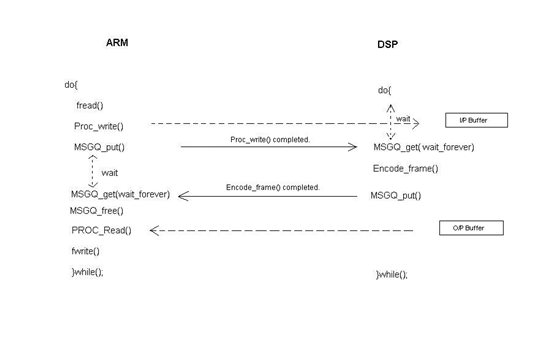

I modified the 'read write ' program for my encoder application(For DM6467 evm).
But there is a problem in dsp side, that not executing after a particular line of my program.
I gave enough space for code/data in DDR memory.
This is my memory map configuration,

Corresponding to this I also modified the .tci file(Increased DDR memory size).
My program using 34KB of shared memory in 'DSPLINKMEM1' memory area.
My dsp executable size is 856KB.
But still my application not working after some lines in dsp side application.
I don't know whether I have to modify any other configuration files, corresponding to .tci file.
I am compiling the dsp program in linux environment using the make files provided with the examples.
Please help me to solve the problem.
Thanks in advance.

     3. I don't see a memory entry for pool. Are you not using any pools?
       I am not using any memory pools but  PROC and MSGQ.
    4.You can look at the memory section table to confirm the section placement agrees with the DSPLink's memory map.
      I checked it and got confirmed.
    5.Has the DSP crashed or is it simply spinning in the idle loop waiting for a command from the host?
       When I try to put return statement before the codec lines causing problem,its working.Initially I thought the problem might be in shortage of code space.
       But even when I  increased the DDR length where the code space is been allocated,problem is still there.For the control structures and the input/output buffers
      I am using 'DSPLINKMEM1'(34KB).Please verify the attached files  for any memory conflicts.
    6. How much memory are you giving to the Linux kernel (i.e. what is the MEM boot arg)?
          120MB memory space is given.
    Expecting your reply .Thanks in advance.

  • Hi Ramsey,
                      Thank you for your reply.
              I was able to run the code.For that I had to put  a delay in my dsp side program. I am attaching a simplified flow diagram of my application.
              After the MSGQ_put() which follows the Encode_frame() call, I put a delay .Then the  program runs smoothly.But the actual code cannot afford such a delay . Can you figure out the problem causing this.
  • Paul,
    My only thought is that the message queue interrupt from ARM to DSP is not working. Without the delay on the DSP side, I'm guessing that the task calls MSGQ_get before the next message arrives. This would cause the task to suspend and the idle task starts running (assuming there are no other tasks ready on the DSP). When the host calls MSGQ_put, it would raise the ARM to DSP interrupt which is supposed to wake up the suspended task which had called MSGQ_get. Maybe this is not working. Would you check the DSP's IFR register to see if there is a pending interrupt which was not taken?
    When you add the delay, maybe this gives the ARM sufficient time to send the message so when the DSP finally calls MSGQ_get there is already a message in the queue. In this case, the task would not suspend, and the call would return with the message.
    One easy way to test this is to call MSGQ_get with a timeout of zero. This will cause MSGQ_get to never block (it is polling), it will return immediately with or without a message. Do this in a loop until MSGQ_get returns with DSP_SOK. If this fixes the problem, then there must be something wrong with the interrupt configuration.
    ~ Ramsey
  • Hi Ramsey,
         Thanks for your reply.As you have suggested the problem is in MSGQ_get(). So I tried it with in a 'do while' loop and with a time out of zero.
         Is there any issue in using this idea?? since your last statement confuses me.
         "If this fixes the problem, then there must be something wrong with the interrupt configuration".
          Is there anyway to put  a timeout for the MSGQ_get rather than using the 'do while' loop??

  • Paul,
    You can pass a timeout value to MSGQ_get() as the second argument; the timeout value is in milliseconds.
    My comment suggests that your original use of MSGQ_get should also be working. If the DSP calls MSGQ_get before the message arrives, the task should block. When the message is delivered by the transport, it should signal the block task which would then resume execution. It seems that this is not working for you. This points to a problem with either the transport configuration or the interrupt configuration.
    It is more efficient to use the blocking call to MSGQ_get instead of using a timeout. However, as long as you try again when there is no message, it should be functionally equivalent.

  • Hi Ramsey,
       Thank you  for your reply,
       As you said the problem was with the MSGQ_get() function in the dsp side. Since the MSGQ_get() functios fails , dsp side remains in the idle state. Initially I didn't put any code for handling such a condition. Any way using timeout in the MSGQ_get() function works fine for me .
    I am using DSPLink 1.5. Is there any issue with this ?.
    Since my application is running fine, with timeout in MSGQ_get(), whether it needed to change the transport configuration ?
