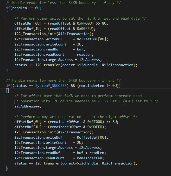

Using mcu_plus_sdk_am64x_10_01_00_32 and modify the i2c_memory_read.c for FILE write and read back to  compare.
Using the I2C device @0x50 physical address to test the file write/read and compare. The routine was using page write/read of 256 Byte page. Test condition of initial address of two cases 0x400 as per example and changed to start at 0x0. The results are the same. Here is the issue :
  1. If the file size is equal or less than 64KB (65536), then the file write and read back and compare passed.
  2. If the file size is just more than 64KB even 1 byte or 2 bytes, the test would fail. Remember it fails either starting address:   #define EEPROM_MEM_ADDRESS = 0x0  or 0x400
So what is likely the problem ?

    Some [I2C] tests have failed!!
    I believe the address is wrap-around when terminal count of 16-bit address. Initial write at [0] = 0x53 and later [10000] = 0x30. On the read both location have the same value 0x30 and so on.

    • If the file size is equal or less than 64KB (65536), then the file write and read back and compare passed.
    • If the file size is just more than 64KB even 1 byte or 2 bytes, the test would fail. Remember it fails either starting address:   #define EEPROM_MEM_ADDRESS = 0x0  or 0x400
    Looks like this is the expected behavior. Please refer  RE: AM6422: sdk8.6 iic write error for details.
  • Well, other people has the similar issue and still having no resolution other than the limitation of the low level driver itself as per section 4.4.2.1.1.2 of TRM.
    Do we expect this to be fixed in the next SDK release for AM64x-EVM board? I am very sure that this is the limitation of the driver now as it shows the assignment of only 16-bit in "board.c" here :
    uint16_t Board_i2cGetEepromMemAddr();   and as I indicted it is no avail even when change it to 32-bit     uint32_t Board_i2cGetEepromMemAddr()
    But the device itself AT24CM01 is 128KB. Do you expect the user to guard the boundary of 64KB and change the starting address from 0x0 to 65536 and continue for the next 64KB ?
    I could understand this phenomenon such as legacy in development when most of the devices supported are less than 64KB (example in SK64 board). However; there are more density devices such as :AT24CM02 (256KB) and if used will be a problem as well.
    Waiting for the right answer.
    Regards;
  • The low level driver for EEPROM handles the edge case also. Please try calling the low level EEPROM_AT24C_read() and EEPROM_AT24C_write() APIs.
    Please refer below image.
