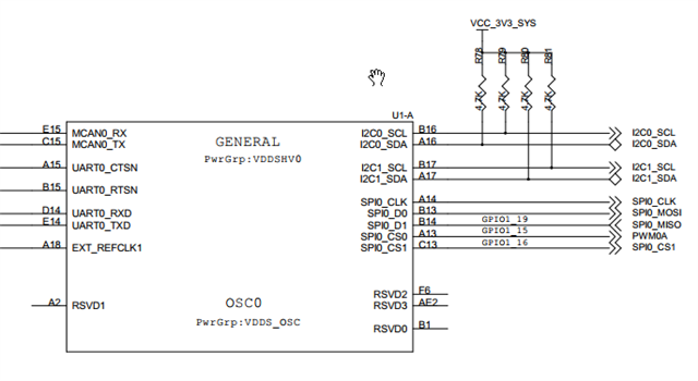

  • Hi Robert,
    Can you please review your board schematics once and check that you are probing pins according to following at your end:
    And also do cross check that you are not probing the MCU domain SPI0, but the MAIN domain SPI0.
    If the issue still persists, I'll try replicating your setup at my end.
  • Hi  ,
    Please see the snapshot of schematic:
    another observation is SPI2 also gets same issue to SPI0

    I can only think of 2 possible issues on your setup:
    1. S/W issue: The pins you are configuring for SPI are also actively pinmuxed for some other IP (GPIO/ePWM/etc).
    2. H/W issue: Something is affecting the direct SoC ball output on your board, either a switch or something else.
