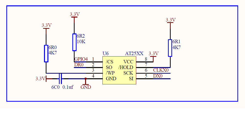

Recently I have been testing the EEPROM with SPI  control mode of the McBSP0 in 5509. But it seems that the data written in were quite rambling. I took the reference from the 5502 SPI example code posted before, and made some changes to the current 5509.
During my debugging, when I did step-by-step debugging, sometimes the data could be written in; however, when I run the whole program, the EEPROM would not refresh its data.
One more strange thing, when I checked the MCBSP, the DRR10 and DRR20 there never changed. But the EEPROM could sometimes read the data correctly then... I don't know whether it was just by chance
I attached my code and schematic as follows. Could anyone give me some help? Thanks a lot!

  • This is very good for you to convert codes from C5502 to VC5509A. I would like to point out that they are in 2 different families of product lines.
    Have you looked into the generic5509 McBSP example code in sprc133?
    Regards.

  • Have got a solution as follows. Now it can run.

    MCBSP_RSETH(hMcbsp,SPCR1,0);
    MCBSP_RSETH(hMcbsp,SPCR2,0);
    MCBSP_RSETH(hMcbsp,RCR1,0);
    MCBSP_RSETH(hMcbsp,RCR2,0);
    MCBSP_RSETH(hMcbsp,XCR1,0);
    MCBSP_RSETH(hMcbsp,XCR2,0);
    MCBSP_RSETH(hMcbsp,SRGR1,1);
    MCBSP_RSETH(hMcbsp,SRGR2,0x2000);
    MCBSP_RSETH(hMcbsp,MCR1,0);
    MCBSP_RSETH(hMcbsp,MCR2,0);
    MCBSP_RSETH(hMcbsp,PCR,0);
    // Configure registers
    MCBSP_RSETH(hMcbsp,SRGR1,0x00F0);
    MCBSP_RSETH(hMcbsp,SPCR1,0x1800);
    // MCBSP_RSETH(hMcbsp,SPCR2,0x0300);
    MCBSP_RSETH(hMcbsp,PCR,0x0F0D);
    MCBSP_RSETH(hMcbsp,RCR1,0x0000);
    MCBSP_RSETH(hMcbsp,RCR2,0x0001);
    MCBSP_RSETH(hMcbsp,XCR1,0x0000);
    MCBSP_RSETH(hMcbsp,XCR2,0x0001);
    // Enable sample rate generator
    MCBSP_FSETH(hMcbsp, SPCR2, GRST,1);
    for(i=0;i<60;i++){}
    // Enable transmitter and receiver
    MCBSP_FSETH(hMcbsp, SPCR2, XRST,1);
    MCBSP_FSETH(hMcbsp, SPCR1, RRST,1);
    // Enable frame sync generator
    MCBSP_FSETH(hMcbsp, SPCR2,FRST,1);
    for(i=0;i<60;i++){}
    void SPI_WriteEN()
    hMcbsp = MCBSP_open(MCBSP_PORT0,MCBSP_OPEN_RESET);
    SPI_init(hMcbsp);
    GPIO_RSET(IODATA,0x00); // chip select
    //Send WREN command
    while(!MCBSP_xrdy(hMcbsp)){}; //wait for XRDY
    MCBSP_write16(hMcbsp,SPI_WRITE_EN);
    while(!MCBSP_rrdy(hMcbsp)){}; //wait for RRDY to indicate write completed
    MCBSP_read16(hMcbsp); // throw away dummy data
    GPIO_RSET(IODATA,0x10); // deselect the chip
    MCBSP_close(hMcbsp);
    void SPI_WriteStatusReg(Uint16 data)
    SPI_init(hMcbsp);
    //Send WRSR command
    MCBSP_write16(hMcbsp,SPI_WRITE_REG);
    MCBSP_write16(hMcbsp,data);
    Uint16 SPI_ReadStatusReg()
    Uint16 value;
    SPI_init(hMcbsp);
    //Send RDSR command
    MCBSP_write16(hMcbsp,SPI_READ_REG);
    //Read Status Reg
    MCBSP_write16(hMcbsp,0);
    value= MCBSP_read16(hMcbsp); // throw away dummy data
    return value;
    void SPI_WriteSignal(Uint32 address, Uint32 data)
    Uint16 EEPROM_status=0;
    SPI_WriteEN();
      	EEPROM_status = SPI_ReadStatusReg();
    while(!(EEPROM_status & 0x2)){};
    SPI_init(hMcbsp);
    //Send WRITE command
    MCBSP_write16(hMcbsp,SPI_WRITE);
    MCBSP_write16(hMcbsp,address>>8);
    MCBSP_write16(hMcbsp,address);
    //EEPROM_status = SPI_ReadStatusReg();
    //while(!(EEPROM_status & 0x1)){};
    Delay();
    Uint32 SPI_ReadSignal(Uint32 address)
    Uint32 value = 0;
    SPI_init(hMcbsp);
    MCBSP_write16(hMcbsp,SPI_READ);
    return value;
