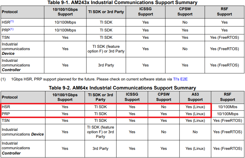

Could you please tell me the speeds supported for PRP and HSR using PSDK Linux?
The information in the documents is as follows.
Industrial Communication Protocol Support for Arm®-based Microcontrollers and Processors
www.ti.com/.../sprt769.pdf
DECEMBER 2023
6 PRP Support
"The AM243x SDK includes support for 100Mbps PRP and the AM64x SDK includes support for 1Gbps PRP."
7 HSR Support
"The AM243x SDK includes support for 100Mbps HSR and the AM64x SDK includes support for 1Gbps HSR."
Industrial Communication Protocols Supported on TI Processors and MCUs (Rev. F)
www.ti.com/.../sprach6f.pdf
REVISED SEPTEMBER 2025
2.5 Parallel Redundancy Protocol (PRP)
"The AM64x/AM243x can support 100M/1G PRP"
2.6 High-Availability Seamless Redundancy (HSR)
"The AM64x/AM243x version can support 100M/1G HSR"
Does the latest PSDK Linux support all speeds of 10/100/1Gbps for PRP and HSR with ICSSG?
Does the latest PSDK Linux support all speeds of 10/100/1Gbps for PRP with CPSW?

  • Hello Daisuke,
    Yes, the latest Linux SDK supports up to 1Gbps HSR and PRP with ICSSG.
    While we don't advertise CPSW for HSR and PRP, in theory HSR and PRP nonoffload mode (up to 1Gbps) can be run on CPSW Ethernet. We have not extensively tested this.
    -Daolin

    I checked the firmware files in the prebuilt image below for SDK 11.1.
    https://www.ti.com/tool/download/PROCESSOR-SDK-LINUX-AM64X/11.01.05.03
    tisdk-default-image-am64xx-evm-11.01.05.03.rootfs.wic.xz
    Daisuke
  • Hello Daisuke,
    I ran the HSR offload test on SDK 11.2 between two AM64x EVMs connected to each other and noticed that ping was able to reach when both paths are connected. When disconnecting one path/cable at a time, I did see some packet loss
    I want correct my statement here. I realized that I did not configure eth1 for ICSSG in my test leading to what appeared to be packet loss with cable disconnect. I've corrected this by enabling the ICSSG dtbo as specified in https://software-dl.ti.com/processor-sdk-linux/esd/AM64X/latest/exports/docs/linux/Foundational_Components/PRU-ICSS/Linux_Drivers/PRU_ICSSG_Ethernet.html#cpsw-pru-ethernet-selection and I do not see ping issues anymore with SDK 11.2. Apologies for the confusion.
    In regards to the ping connection issue with 10Mbps on SDK 11.2 the customer saw, has the customer verified that eth1 is configured for ICSSG on the AM64x EVM? They can run "ethtool -i eth1" to double check.
    It appears that SDK 11.1 does not include the PRUSS firmware for PRP that is included in SDK 11.2.
    My understanding is that PRP offload should be available for SDK 11.2 but the respective firmwares being missing doesn't align. There might be a chance the firmwares in https://git.ti.com/cgit/processor-firmware/ti-linux-firmware/commit/?h=ti-linux-firmware&id=29d948b63a48ec4ff7883d2e246dfb7b6c8153aa didn't get packaged into the SDK 11.1 by the time SDK 11.1 was released. Let me double check with our team about this.
    The customer can directly add the PRP firmwares from https://git.ti.com/cgit/processor-firmware/ti-linux-firmware/commit/?h=ti-linux-firmware&id=29d948b63a48ec4ff7883d2e246dfb7b6c8153aa to /usr/lib/firmware/ti-pruss/ and test PRP offload out.
    -Daolin
  • Hi Daolin-san,
    Thank you for your reply.
    I have created another thread about the gPTP with HSR and PRP.
    e2e.ti.com/.../am6442-gptp-support-using-psdk-linux
    By the way, I tried to test HSR and PRP offload and gPTP on TMDS64EVM, but I have not been able to test them because TMDS64EVM we own was broken due to power issues.
    Daisuke
  • Hi Daisuke,
    Apologies for the delayed response.
    It looks like JC was able to help you in the other thread you created. As JC mentioned, PTP over HSR/PRP is a new feature that is planned to be released next SDK and is not currently available on SDK 11.2.
    While we currently have support for PTP and HSR/PRP separately, supporting both together required some extensive driver, firmware, hsr stack changes. Additionally, the PTP stack/application code that is used should also support HSR/PRP. The example we currently give for Linux SDK uses the linuxptp stack which is open source. TI does not own the PTP stack and we leave that up to the customer to determine if they want to use linuxptp or another PTP stack. It is the responsibility of the customer to determine if the PTP stack they use has support for HSR/PRP.
    Please let me know if there are any further issues regarding the original questions in this thread.
    -Daolin
