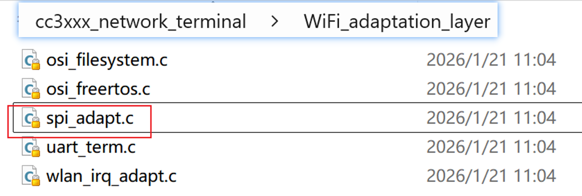

The AM2434 platform is connected to the CC3351 WiFi module via SDIO. Currently, the SDKs provided on the official website (e.g., cc33xx_rtos_mcu_package_R8_1) only support SPI communication.
The corresponding SPI adaptation layer code is as follows:
Items to be implemented as planned:

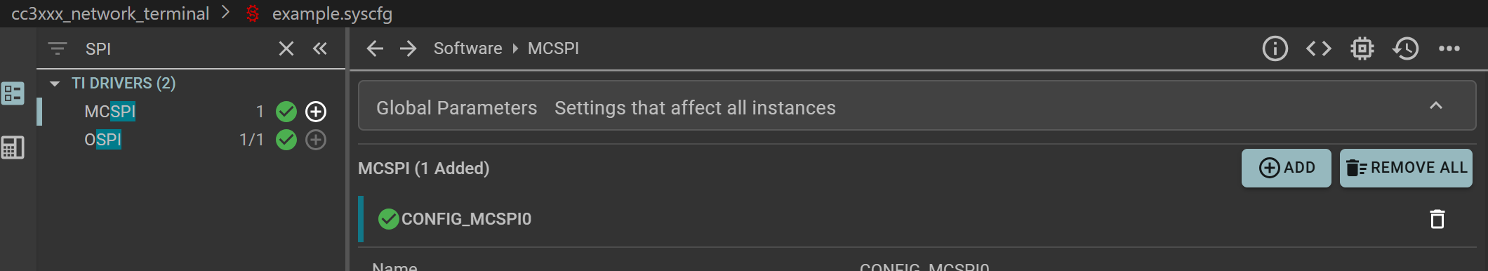

1.Configure the SDIO hardware (HW) settings.
It is intended to first disable MCSPI and then enable MMCSD, as SDIO and SPI share the same pins.
2.Whether the corresponding driver for MMCSD is compiled and enabled by default? If not, how to compile and make it take effect?
3.For the adaptation layer, are there any implementation examples for files such as spi_adapt.c (for the SPI bus) and mmc_adapt.c?
4.How to migrate the WiFi driver's SPI communication APIs to SDIO communication APIs?
Could you please provide guidance on the above matters? Additionally, if there are any relevant documents or patches available, could you please provide them as well?

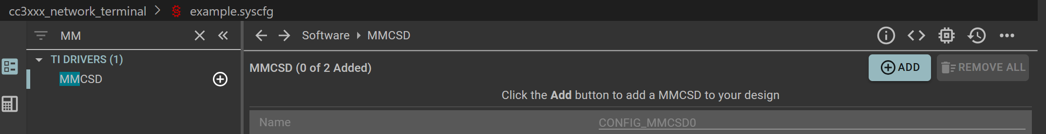

    Additionally, the SysConfig configurations are as follows:

  • Hi Lijun,
    For the SDIO protocol, you need to use AM243 MCU+SDK and not the CC33xx SDK.
    the MCU FreeRTOS only has implementations for eMMC and SD
    For SDIO, you would need to follow the same implementation as SD that is already present in the MCU+SDK. You would need to make changes to the sysconfig and the pinmux to enable the SDIO.

  • Hi Yashraj,
    I am currently using the AM2434 MCU paired with the CC3351 WiFi module, hence the need to utilize the CC33XX SDK.
    mcu_plus_sdk_am243x_08_05_00_24 + cc33xx_rtos_mcu_package_R8_1,
    The CC33XX SDK has already implemented SPI communication, and its code framework is compatible with SDIO/UART. If switching to SDIO communication, it appears that only the sdio_adapt.c file is currently missing. Of course, the init/read/write functions need to be implemented, and we can refer to the SD module code flow in mmcsd_v0.c (which only implements eMMC and SD modules). I have switched to SDIO mode as shown in the screenshot I attached earlier—are there any issues with this?

  • Hi Lijun,
    I do not think there will be any issue with the setup that you have done.
    Do refer to the User guide of the CC33xx SDK documentation regarding the setup for the CC3351 wifi chip: CC33XX-RTOS-MCU+SDK-Doc
