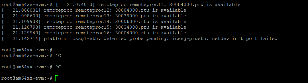

once the device boots i am unable to see eth2 port which is configured for icssg-prueth.
also i get below error
Also if i try to add  "name_overlays ti/k3-am642-evm-icssg1-dualemac.dtbo " on uboot prompt, my eth1 port also vanishes. Whats going wrong here?
Below are the logs attached,

[    0.094936] CPU1: Booted secondary processor 0x0000000001 [0x410fd034]
[    0.095168] smp: Brought up 1 node, 2 CPUs
[    0.124566] SMP: Total of 2 processors activated.
[    0.129378] CPU: All CPU(s) started at EL2
[    0.133583] CPU features: detected: 32-bit EL0 Support
[    0.138840] CPU features: detected: CRC32 instructions
[    0.144135] alternatives: applying system-wide alternatives
[    0.150476] Memory: 1881156K/2097152K available (10752K kernel code, 1122K rwdata, 3180K rodata, 2240K init, 615K bss, 175256K reserved, 32768K cma-reserved)
[    0.166290] devtmpfs: initialized
[    0.180753] clocksource: jiffies: mask: 0xffffffff max_cycles: 0xffffffff, max_idle_ns: 7645041785100000 ns
[    0.190763] futex hash table entries: 512 (order: 3, 32768 bytes, linear)
[    0.198875] 28224 pages in range for non-PLT usage
[    0.198905] 519744 pages in range for PLT usage
[    0.204266] pinctrl core: initialized pinctrl subsystem
[    0.214957] DMI not present or invalid.
[    0.221601] NET: Registered PF_NETLINK/PF_ROUTE protocol family
[    0.229449] DMA: preallocated 256 KiB GFP_KERNEL pool for atomic allocations
[    0.237688] DMA: preallocated 256 KiB GFP_KERNEL|GFP_DMA pool for atomic allocations
[    0.246938] DMA: preallocated 256 KiB GFP_KERNEL|GFP_DMA32 pool for atomic allocations
[    0.255173] audit: initializing netlink subsys (disabled)
[    0.261223] audit: type=2000 audit(0.196:1): state=initialized audit_enabled=0 res=1
[    0.269206] cpuidle: using governor menu
[    0.273442] hw-breakpoint: found 6 breakpoint and 4 watchpoint registers.
[    0.280459] ASID allocator initialised with 65536 entries
[    0.294590] /bus@f4000/interrupt-controller@1800000: Fixed dependency cycle(s) with /bus@f4000/interrupt-controller@1800000
[    0.319169] HugeTLB: registered 1.00 GiB page size, pre-allocated 0 pages
[    0.326155] HugeTLB: 0 KiB vmemmap can be freed for a 1.00 GiB page
[    0.332570] HugeTLB: registered 32.0 MiB page size, pre-allocated 0 pages
[    0.339510] HugeTLB: 0 KiB vmemmap can be freed for a 32.0 MiB page
[    0.345918] HugeTLB: registered 2.00 MiB page size, pre-allocated 0 pages
[    0.352856] HugeTLB: 0 KiB vmemmap can be freed for a 2.00 MiB page
[    0.359265] HugeTLB: registered 64.0 KiB page size, pre-allocated 0 pages
[    0.366203] HugeTLB: 0 KiB vmemmap can be freed for a 64.0 KiB page
[    0.374784] k3-chipinfo 43000014.chipid: Family:AM64X rev:SR2.0 JTAGID[0x1bb3802f] Detected
[    0.385813] iommu: Default domain type: Translated
[    0.390753] iommu: DMA domain TLB invalidation policy: strict mode
[    0.397557] SCSI subsystem initialized
[    0.402002] usbcore: registered new interface driver usbfs
[    0.407669] usbcore: registered new interface driver hub
[    0.413152] usbcore: registered new device driver usb
[    0.419001] pps_core: LinuxPPS API ver. 1 registered
[    0.424094] pps_core: Software ver. 5.3.6 - Copyright 2005-2007 Rodolfo Giometti <giometti@linux.it>
[    0.433444] PTP clock support registered
[    0.437585] scmi_core: SCMI protocol bus registered
[    0.444806] vgaarb: loaded
[    0.448175] clocksource: Switched to clocksource arch_sys_counter
[    0.464371] NET: Registered PF_INET protocol family
[    0.469706] IP idents hash table entries: 32768 (order: 6, 262144 bytes, linear)
[    0.479356] tcp_listen_portaddr_hash hash table entries: 1024 (order: 2, 16384 bytes, linear)
[    0.488239] Table-perturb hash table entries: 65536 (order: 6, 262144 bytes, linear)
[    0.496183] TCP established hash table entries: 16384 (order: 5, 131072 bytes, linear)
[    0.504419] TCP bind hash table entries: 16384 (order: 7, 524288 bytes, linear)
[    0.512472] TCP: Hash tables configured (established 16384 bind 16384)
[    0.519408] UDP hash table entries: 1024 (order: 3, 32768 bytes, linear)
[    0.526354] UDP-Lite hash table entries: 1024 (order: 3, 32768 bytes, linear)
[    0.533903] NET: Registered PF_UNIX/PF_LOCAL protocol family
[    0.539741] PCI: CLS 0 bytes, default 64
[    0.545556] Initialise system trusted keyrings
[    0.550530] workingset: timestamp_bits=46 max_order=19 bucket_order=0
[    0.625308] Key type asymmetric registered
[    0.629531] Asymmetric key parser 'x509' registered
[    0.634629] Block layer SCSI generic (bsg) driver version 0.4 loaded (major 244)
[    0.642522] io scheduler mq-deadline registered
[    0.647205] io scheduler kyber registered
[    0.651360] io scheduler bfq registered
[    0.659131] pinctrl-single 4084000.pinctrl: 33 pins, size 132
[    0.665753] pinctrl-single f4000.pinctrl: 180 pins, size 720
[    0.673871] ledtrig-cpu: registered to indicate activity on CPUs
[    0.687334] Serial: 8250/16550 driver, 12 ports, IRQ sharing enabled
[    0.708899] loop: module loaded
[    0.713699] megasas: 07.727.03.00-rc1
[    0.723439] tun: Universal TUN/TAP device driver, 1.6
[    0.731020] usbcore: registered new interface driver usb-storage
[    0.737781] i2c_dev: i2c /dev entries driver
[    0.743594] sdhci: Secure Digital Host Controller Interface driver
[    0.749986] sdhci: Copyright(c) Pierre Ossman
[    0.754762] sdhci-pltfm: SDHCI platform and OF driver helper
[    0.761483] SMCCC: SOC_ID: ARCH_SOC_ID not implemented, skipping ....
[    0.768908] omap-mailbox 29020000.mailbox: omap mailbox rev 0x66fc9100
[    0.775904] omap-mailbox 29040000.mailbox: omap mailbox rev 0x66fc9100
[    0.782774] omap-mailbox 29060000.mailbox: omap mailbox rev 0x66fc9100
[    0.792057] hw perfevents: enabled with armv8_cortex_a53 PMU driver, 7 (0,8000003f) counters available
[    0.802534] optee: probing for conduit method.
I/TC: Reserved shared memory is enabled
I/TC: Dynamic shared memory is enabled
I/TC: Normal World virtualization support is disabled
I/TC: Asynchronous notifications are disabled
[    0.807150] optee: revision 4.7 (a9690ae39995af36)
[    0.823936] optee: dynamic shared memory is enabled
[    0.834942] optee: initialized driver
[    0.835055] random: crng init done
[    0.841153] Initializing XFRM netlink socket
[    0.846706] NET: Registered PF_PACKET protocol family
[    0.851936] Key type dns_resolver registered
[    0.864335] registered taskstats version 1
[    0.868584] Loading compiled-in X.509 certificates
[    0.888114] ti-sci 44043000.system-controller: ABI: 4.0 (firmware rev 0x000b '11.2.5--v11.02.05 (Fancy Rat)')
[    1.021337] k3-m4-rproc 5000000.m4fss: assigned reserved memory node m4f-dma-memory@a4000000
[    1.030525] k3-m4-rproc 5000000.m4fss: configured M4F for remoteproc mode
[    1.038166] remoteproc remoteproc0: 5000000.m4fss is available
[    1.045062] remoteproc remoteproc0: Direct firmware load for am64-mcu-m4f0_0-fw failed with error -2
[    1.054508] remoteproc remoteproc0: powering up 5000000.m4fss
[    1.060527] remoteproc remoteproc0: Direct firmware load for am64-mcu-m4f0_0-fw failed with error -2
[    1.069957] remoteproc remoteproc0: request_firmware failed: -2
[    1.076120] platform 78000000.r5f: configured R5F for remoteproc mode
[    1.083132] platform 78000000.r5f: assigned reserved memory node r5f-dma-memory@a0000000
[    1.092153] remoteproc remoteproc1: 78000000.r5f is available
[    1.098290] remoteproc remoteproc1: Direct firmware load for am64-main-r5f0_0-fw failed with error -2
[    1.107752] remoteproc remoteproc1: powering up 78000000.r5f
[    1.108454] platform 78200000.r5f: configured R5F for remoteproc mode
[    1.113659] remoteproc remoteproc1: Direct firmware load for am64-main-r5f0_0-fw failed with error -2
[    1.120570] platform 78200000.r5f: assigned reserved memory node r5f-dma-memory@a1000000
[    1.129582] remoteproc remoteproc1: request_firmware failed: -2
[    1.138522] remoteproc remoteproc2: 78200000.r5f is available
[    1.150798] remoteproc remoteproc2: Direct firmware load for am64-main-r5f0_1-fw failed with error -2
[    1.160335] remoteproc remoteproc2: powering up 78200000.r5f
[    1.166270] remoteproc remoteproc2: Direct firmware load for am64-main-r5f0_1-fw failed with error -2
[    1.175783] remoteproc remoteproc2: request_firmware failed: -2
[    1.181942] platform 78400000.r5f: configured R5F for remoteproc mode
[    1.188991] platform 78400000.r5f: assigned reserved memory node r5f-dma-memory@a2000000
[    1.198036] remoteproc remoteproc3: 78400000.r5f is available
[    1.204262] remoteproc remoteproc3: Direct firmware load for am64-main-r5f1_0-fw failed with error -2
[    1.213744] remoteproc remoteproc3: powering up 78400000.r5f
[    1.214108] platform 78600000.r5f: configured R5F for remoteproc mode
[    1.219606] remoteproc remoteproc3: Direct firmware load for am64-main-r5f1_0-fw failed with error -2
[    1.226540] platform 78600000.r5f: assigned reserved memory node r5f-dma-memory@a3000000
[    1.235571] remoteproc remoteproc3: request_firmware failed: -2
[    1.244586] remoteproc remoteproc4: 78600000.r5f is available
[    1.255954] remoteproc remoteproc4: Direct firmware load for am64-main-r5f1_1-fw failed with error -2
[    1.265470] remoteproc remoteproc4: powering up 78600000.r5f
[    1.266755] pca953x 0-0038: supply vcc not found, using dummy regulator
[    1.271434] remoteproc remoteproc4: Direct firmware load for am64-main-r5f1_1-fw failed with error -2
[    1.278323] pca953x 0-0038: using no AI
[    1.287598] remoteproc remoteproc4: request_firmware failed: -2
[    1.305165] omap_i2c 20000000.i2c: bus 0 rev0.12 at 400 kHz
[    1.313161] pca953x 1-0022: supply vcc not found, using dummy regulator
[    1.320312] pca953x 1-0022: using AI
[    1.337692] omap_i2c 20010000.i2c: bus 1 rev0.12 at 400 kHz
[    1.343991] ti-sci-intr bus@f4000:interrupt-controller@a00000: Interrupt Router 3 domain created
[    1.353467] ti-sci-inta 48000000.interrupt-controller: Interrupt Aggregator domain 28 created
[    1.367081] ti-udma 485c0100.dma-controller: Number of rings: 68
[    1.375147] ti-udma 485c0100.dma-controller: Channels: 24 (bchan: 12, tchan: 6, rchan: 6)
[    1.385673] ti-udma 485c0000.dma-controller: Number of rings: 288
[    1.403789] ti-udma 485c0000.dma-controller: Channels: 44 (tchan: 29, rchan: 15)
[    1.415397] printk: legacy console [ttyS2] disabled
[    1.420966] 2800000.serial: ttyS2 at MMIO 0x2800000 (irq = 313, base_baud = 3000000) is a 8250
[    1.430087] printk: legacy console [ttyS2] enabled
[    1.439803] printk: legacy bootconsole [ns16550a0] disabled
[    1.457797] 7 fixed-partitions partitions found on MTD device fc40000.spi.0
[    1.464823] Creating 7 MTD partitions on "fc40000.spi.0":
[    1.470228] 0x000000000000-0x000000100000 : "ospi.tiboot3"
[    1.477755] 0x000000100000-0x000000300000 : "ospi.tispl"
[    1.484864] 0x000000300000-0x000000700000 : "ospi.u-boot"
[    1.491933] 0x000000700000-0x000000740000 : "ospi.env"
[    1.498736] 0x000000740000-0x000000780000 : "ospi.env.backup"
[    1.506182] 0x000000800000-0x000003fc0000 : "ospi.rootfs"
[    1.513274] 0x000003fc0000-0x000004000000 : "ospi.phypattern"
[    1.520946] cadence-qspi fc40000.spi: Pattern not found. Skipping calibration.
[    1.529648] am65-cpsw-nuss 8000000.ethernet: initializing am65 cpsw nuss version 0x6BA00903, cpsw version 0x6BA80903 Ports: 3 quirks:00000006
[    1.543410] davinci_mdio 8000f00.mdio: Configuring MDIO in manual mode
[    1.584190] davinci_mdio 8000f00.mdio: davinci mdio revision 9.7, bus freq 1000000
[    1.594221] davinci_mdio 8000f00.mdio: phy[0]: device 8000f00.mdio:00, driver TI DP83867
[    1.602557] am65-cpsw-nuss 8000000.ethernet: initialized cpsw ale version 1.4
[    1.609706] am65-cpsw-nuss 8000000.ethernet: ALE Table size 512, Policers 32
[    1.618096] am65-cpsw-nuss 8000000.ethernet: CPTS ver 0x4e8a010c, freq:500000000, add_val:1 pps:1
[    1.643673] am65-cpsw-nuss 8000000.ethernet: set new flow-id-base 16
[    1.657828] am65-cpts 39000000.cpts: CPTS ver 0x4e8a010c, freq:500000000, add_val:1 pps:1
[    1.667891] gpio-mux mux-controller: 2-way mux-controller registered
[    1.674532] mmc0: CQHCI version 5.10
[    1.687832] j721e-pcie f102000.pcie: host bridge /bus@f4000/pcie@f102000 ranges:
[    1.695339] j721e-pcie f102000.pcie:       IO 0x0600001000..0x0600100fff -> 0x0000001000
[    1.703493] j721e-pcie f102000.pcie:      MEM 0x0600101000..0x06ffffffff -> 0x0000101000
[    1.711626] j721e-pcie f102000.pcie:   IB MEM 0x0000000000..0x0fffffffff -> 0x0000000000
[    1.716182] mmc0: SDHCI controller on fa10000.mmc [fa10000.mmc] using ADMA 64-bit
[    1.808359] mmc0: Command Queue Engine enabled
[    1.812878] mmc0: new HS200 MMC card at address 0001
[    1.818784] mmcblk0: mmc0:0001 S0J56X 14.8 GiB
[    1.827253]  mmcblk0: p1
[    1.830598] mmcblk0boot0: mmc0:0001 S0J56X 31.5 MiB
[    1.837054] mmcblk0boot1: mmc0:0001 S0J56X 31.5 MiB
[    1.843429] mmcblk0rpmb: mmc0:0001 S0J56X 4.00 MiB, chardev (240:0)
[    2.828801] j721e-pcie f102000.pcie: PCI host bridge to bus 0000:00
[    2.835191] pci_bus 0000:00: root bus resource [bus 00-ff]
[    2.840687] pci_bus 0000:00: root bus resource [io  0x0000-0xfffff] (bus address [0x1000-0x100fff])
[    2.849728] pci_bus 0000:00: root bus resource [mem 0x600101000-0x6ffffffff] (bus address [0x00101000-0xffffffff])
[    2.860108] pci 0000:00:00.0: [104c:b010] type 01 class 0x060400 PCIe Root Port
[    2.867428] pci 0000:00:00.0: BAR 0 [mem 0x00000000-0xfffffffff 64bit pref]
[    2.874391] pci 0000:00:00.0: PCI bridge to [bus 00]
[    2.879392] pci 0000:00:00.0:   bridge window [io  0x0000-0x0fff]
[    2.885492] pci 0000:00:00.0:   bridge window [mem 0x00000000-0x000fffff]
[    2.892290] pci 0000:00:00.0:   bridge window [mem 0x00000000-0x000fffff 64bit pref]
[    2.900106] pci 0000:00:00.0: supports D1

root@am64xx-evm:~# [   21.053536] remoteproc remoteproc9: 300b8000.pru is available
[   21.063026] remoteproc remoteproc10: 30086000.rtu is available
root@am64xx-evm:~# [   21.074013] remoteproc remoteproc11: 300b4000.pru is available
[   21.086031] remoteproc remoteproc12: 30084000.rtu is available
[   21.098603] remoteproc remoteproc13: 30038000.pru is available
[   21.109938] remoteproc remoteproc14: 30006000.rtu is available
[   21.120793] remoteproc remoteproc15: 30034000.pru is available
[   21.129943] remoteproc remoteproc16: 30004000.rtu is available
[   21.142714] platform icssg1-eth: deferred probe pending: icssg-prueth: netdev init port failed
root@am64xx-evm:~#
Kindly support on this.

  • Hi Shraddha,
    Can you please check in the /usr/lib/firmware/ti-pruss directory of your filesystem to see if the am64x-sr2* elf firmware files are present?

    What I believe is happening to cause the "deferred probe pending: icssg-prueth: netdev init" issue is likely due to the PRU firmwares not being loaded properly upon boot up. When loaded properly you should be seeing the following in the boot log which I don't see in your boot log.
    root@am64xx-evm:~# dmesg | grep -i prueth
    [  11.986877] icssg-prueth icssg1-eth: TI PRU ethernet driver initialized: single EMAC mode
    [  14.988144] remoteproc remoteproc13: Booting fw image ti-pruss/am64x-sr2-pru0-prueth-fw.elf, siz8
    [  14.990824] remoteproc remoteproc14: Booting fw image ti-pruss/am64x-sr2-rtu0-prueth-fw.elf, siz6
    [  14.993767] remoteproc remoteproc7: Booting fw image ti-pruss/am64x-sr2-txpru0-prueth-fw.elf, si0
    [  15.004698] remoteproc remoteproc15: Booting fw image ti-pruss/am64x-sr2-pru1-prueth-fw.elf, siz8
    [  15.007472] remoteproc remoteproc16: Booting fw image ti-pruss/am64x-sr2-rtu1-prueth-fw.elf, siz2
    [  15.016549] remoteproc remoteproc8: Booting fw image ti-pruss/am64x-sr2-txpru1-prueth-fw.elf, si8
    root@am64xx-evm:~# uname -a
    Linux am64xx-evm 6.12.57-ti-rt-g31b07ab8dfbc #1 SMP PREEMPT_RT Thu Dec 4 13:07:37 UTC 2025 aarch64x
    root@am64xx-evm:~#
    I'm not an expert when it comes to the bbappend side but my guess is that there should be some configuration to the IMAGE_INSTALL to ensure the PRU firmwares are being built into the filesystem at /usr/lib/firmware/ti-pruss directory.
    -Daolin
