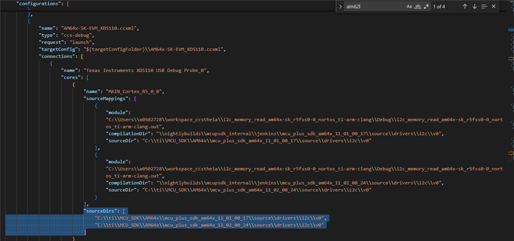

    Can you please check, does you launch.json file also has the path added for file on which you are adding breakpoint?
    To open launch.json file, Navigate to Debug and click on settings icon as highlighted in red below.
    The file should look like below.
    Check for the sourceDirs for your application project.
    Tushar
  • Hi again,
    Here is my launch.json file. I dont have those "sourceDirs" you have at all.

    Why don't I have them? How do I add them?
    Thanks.
    K.
    This should automatically come once you debug the application step by step. Once it tries to access code from the files located in SDK. The file path are not added by default. You will need to locate the file path and it will be added to launch.json file.
    Please refer below attached video.
    Once the source dir is updated in launch.json, you should be able to put a breakpoint and debug.
    Tushar
    Understood. Here is my launch.json when i go inside the uart_echo() function like you did with breakpoints.
      // Use IntelliSense to learn about possible attributes.
      // Hover to view descriptions of existing attributes.
      "version": "0.2.0",
      "configurations": [
          "name": "uart_echo_am273x-evm_r5fss0-0_freertos_ti-arm-clang",
          "type": "ccs-debug",
          "request": "launch",
          "projectInfo": {
            "resourceId": "/uart_echo_am273x-evm_r5fss0-0_freertos_ti-arm-clang"
    I still don't have what you have. Furthermore when I Ctrl+CLICK on the function UART_Transaction_init it automatically opens a file called uart_sci.h which lies inside the SDK folder like so: C:\ti\mcu_plus_sdk_am273x_11_02_00_25\source\drivers\uart\v1
    So to sum up: When I reach your second breakpoint and click STEP INTO from the debugger it indeed AUTOMATICALLY opens that function (AS IT SHOULD) and I am also able to place breakpoints inside there. It doesn't say NOT FOUND like in your setup. Furthermore, shouldn't your debugger also open the function since it is included in the launch.json file and you not having to open it manually? What you are showing is counter-intuitive. It really undoes the whole purpose of existence of the sourceDirs inside the launch.json file.
    K.
  • Hi
    For the first time when the entry is not updated in the launch.json file, I have to manually locate it. Once the entry is updated now for the second run I am able to open the function directly.
    Tushar
  • Okay let us assume that it works that way.
    You still didn't reply to my issue. Why doesn't my launch.json automatically have those sourceDir lines like yours does?
    Shouldn't these lines be there?
    K.
  • I am using CCS v20.4.0. Can you also try with the same version?
    Also I manually located that file due to which this entry is added to lauch.json file. For you it was not the case, so this may be the reason.
    Are you able to put breakpoint in that file?
    The file which are not opening directly or the files on which breakpoints are not working. Try to located those files by step debugging as I did in the above video.
    Tushar
  • Same thing with 20.4.0. Maybe it is because my CCS installation has these directories discovered and added in the Products inside the CCS Settings?
  • If the files are discovered by the CCS launch.json file, then you should be able to put breakpoint in it. There should be no issue.
    Try keeping the breakpoint in files opened by CCS instead of manually opening the files.
