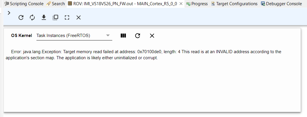

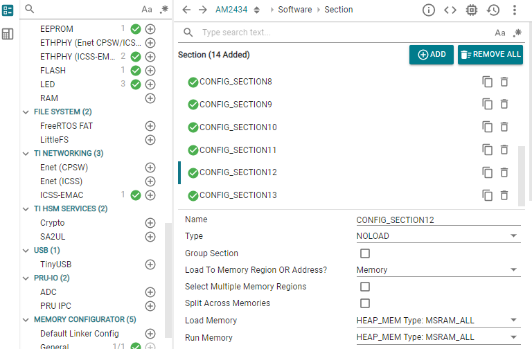

I am Runtime Object View in my application and it throws expection when I keep Heap section into the NoLoad memory region.
Note: The issue is specific to CCS Eclipse based IDE (CCS v12.8.1).
Please refer below error message.
  • The above error is coming because the debugger cannot read the memory address at location 0x70100de0. The ROV code used to read this memory uses a fetchArray function which cannot read the memory content because it is either uninitialized or corrupt. Please refer the above error message.
    We need to modify the code for ROV to use fetchFromAddress API instead of fetchArray API.
