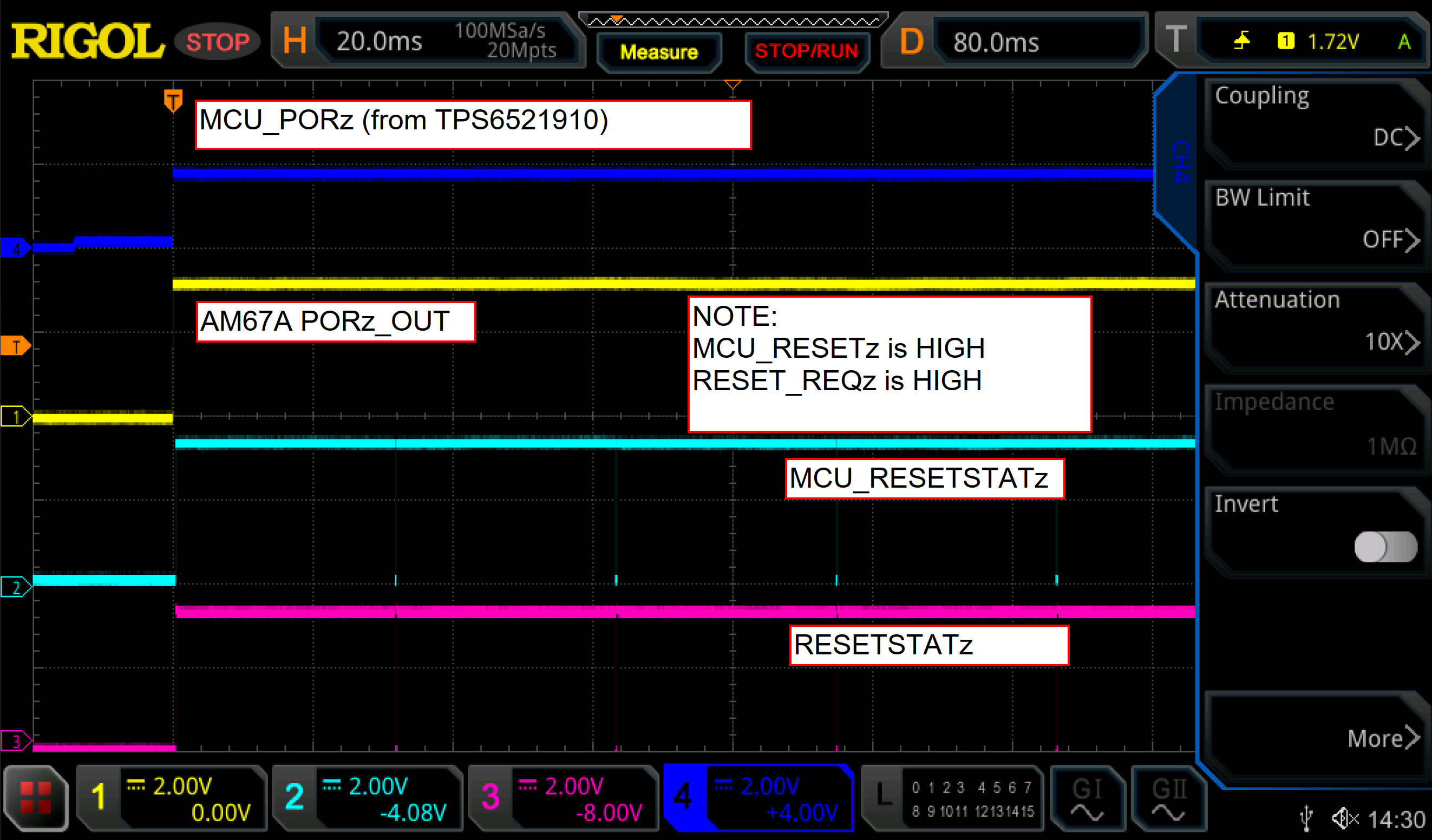

Our AM67A custom hardware design is not advancing through the ROM bootloading phase and remains in warm reset, on a ~32ms reset interval. This design is largely based on the BeagleY-AI schematic with other design inputs from the J722S EVM.
The AM67A fails to advance to booting from SD Card. There is no CLK or CMD actvivity on MMC1 initiated by the ROM bootloader.  We have confirmed that SDCD does go low, indicating card presence.
We have gone through the SPRAD91B checklist and the design seems to check out.
Bootmode Settings (via 10kohm PU/PDs)
  • Bootmode jumpers have been verified
  • Bootmode nodes have been measured with a DMM
  • Bootmode nodes have been measured with a scope during PORz rising edge
  • Bootmode is set at b0001001001000011
    • 25MHz PLL
    • Primary boot mode MMCSD, MMC1
    • Secondary boot mode Ethernet
    • B15-13, strapped low
    • Bootmode pins are not used after boot.

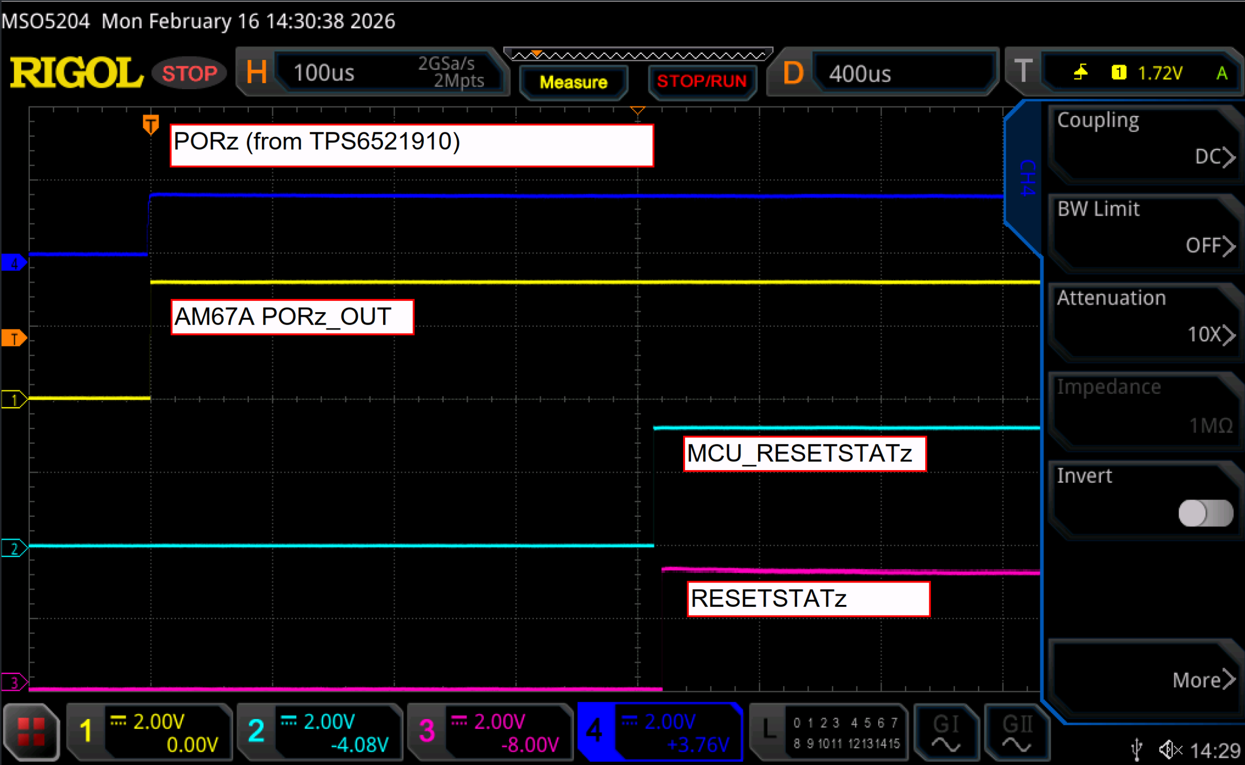

Waveforms
Initial power up reset sequence showing reset behaviour
Waveform showing repeated warm reset pattern at ~32ms
