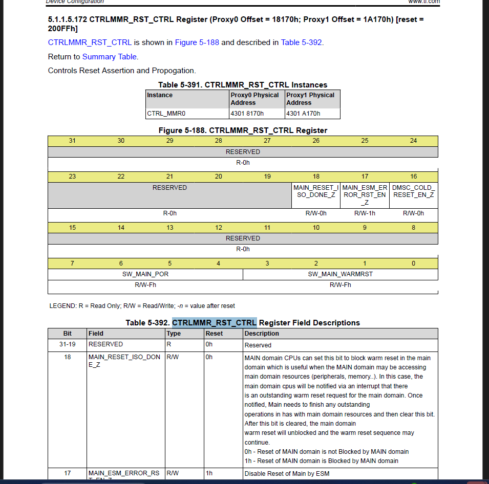

In the TRM spruim2h.pdf,  in section 5.3.5.1.1.5.172, it introduces two reset mode, one is power main reset another one is warm reset as below.
Is it possible that you made a mistake anywhere in this document,
I use T32 lauterbach to produce reset.
Step1  make sure all the reset is enabled.
Data.Set NSD:0x43018170 %LE %Long 0x000000FF
Step2, doing a power off reset, nothing happened.
"Data.Set NSD:0x43018170 %LE %Long 0x0000006F"  is not doing anything. it doesn't reset.
Step3,  doing a warm reset,  it is weird, PORZ is toggled, it is like a power up reset.
Data.Set NSD:0x43018170 %LE %Long 0x000000F6  producing a pow up reset
I am running TMDS64EVM. the Step 2,  the bit from 7-4, simply not working, am I forget something.
Then, I call the function you provided, it is exactly doing the same thing as in lauterbach, bahavior is the same.
both are under C:\ti\mcu_plus_sdk_am64x_09_01_00_41\source\drivers\soc\am64x_am243x\soc.c
"SOC_generateSwWarmResetMainDomain"  function will perform a power up reset
"SOC_generateSwPORResetMainDomainFromMcuDomain" is not doing anything.
Thanks.

    Q1. At which software execution stage do you have the Lauterbach debugger attached to the target ?
    Q2. What is the value of the SW_MAIN_POR some time after writing 0x0000006F to the address: 0x4301_8170 ? Can you confirm PORz_OUT pin level does NOT change and remains HIGH (inactive) ?
    Q3. How do the values change inside the register: CTRLMMR_RST_SRC (0x4301_8178) at the corresponding POR and warm reset reason bitfields:
    [25] SW_MAIN_POR_FROM_MAIN
    [21] SW_MAIN_WARMRST_FROM_MAIN
    According to the AM243x TRM section,
    Would you please check if this thread may give you the necessary explanation:
    Warm reset triggered as a workaround after software initiated power-on reset
    I understand that mcu_plus_sdk_am64x_09_01_00_41 might have the  errata integrated for this SDK version.
    The errata (See sprz457j_AM64x_AM243x_Silicon_Rev1.0_2.0.pdf ) is applicable for both AM243x  Silicon Revision 1.0 and Silicon Revision 2.0.
    Looking forward to your feedback !
