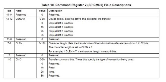

I am trying to understand the operation of the SPI peripheral in the C5515. sprufo3 seems to imply that SPI reads and writes are two different processes. However, most SPI peripherals treat a SPI transaction as both a read *and* a write by clocking data into MISO as it receives data from the master on MOSI. The SPI chip I am interfacing to requires a two-way (read *and* write) transaction since it clocks out status bytes as the C5515 is clocking out commands.
Does the C5515 SPI peripheral indeed perform a bi-directional transfer during a transaction? If so, why does the CSL only support SPI_write and SPI_read functions? After sending a 16-bit transaction to SPIDAT2, will SPIDAT1 have the incoming 16-bit response from my SPI peripheral?

    You are right. According to SPRUFO3, C5515 cannot read and write SPI simultaneously (input bit and output bit on the same clock edge). If that SPI device is not avoidable, you can use a small external circuit (shift register) to delay the output of the device 1 frame.

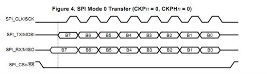

    No offense, but I sure hope you are wrong. All standard SPI devices shift data in as they are shifting data out. For example, take a look at the timing diagram on page 13 of sprufo3.
    Notice that the slave is sending data in (MISO) as the master is sending data out (MOSI). This is exactly what my SPI peripheral device does and will not work otherwise. What is confusing me (I can't test this yet) is why there are two different data transaction commands...read and write. See Table 10, pg 29 (bits 1-0, CMD).
    Should't the SPIDAT1 contain the incoming data from the slave after the master issues a Write command? This is how the OMAP-L138 SPI peripheral works. Why do I need a read command? What purpose does it serve? How is it different from Write?

    The reason is that the hardware peripheral buffers the serial data in parallel registers, and the DSP only deals with the parallel data. While it is true that each serial output bit is indeed simultaneous with the corresponding serial input bit, it is not quite possible for the parallel output buffer and parallel input buffer register to be updated simultaneously. When the peripheral output register is written, it takes several cycles for the total serial word to be transmitted. Meanwhile, the peripheral input register does not reflect the live serial input on a bit-by-bit basis, but rather it waits until the entire serial word has been received, and after the last bit comes in the peripheral updates the parallel buffer register as a whole word.
    The SPI_write() function stores a word in the parallel buffer register. Depending upon the serial hardware, there may actually be several stages of buffering, or at the very least there might be a buffer for the word that is actively being clocked out over the serial lines plus a separate word register that can hold the next word.
    The SPI_read() function grabs the entire parallel word from the peripheral buffer register, but it can only do so after all bits have been collected. Thus, it technically happens after the write has finished.
    No, SPIDAT1 cannot contain the incoming data from the slave immediately after the master issues a write. As I described above, it may take hundreds of CPU cycles before the much-slower serial port completes the entire serial word transfer. Granted, you did technically say "after" without qualifying how long of a time frame you're talking about. In my specific example given earlier in this thread, the incoming data appears 96 clock cycles after the write command is issued.
    If you check the timing diagrams for the OMAP-L138 SPI peripheral, you will find that it is not possible for all of the incoming data to be known at the instant that the output data starts the sending process. If you could superimpose the instruction sequence of your DSP on top of the SPI timing diagram, you'd see hundreds of operations during the time span of a single serial word. Human perception may be that such a serial transfer is instantaneous, but the DSP sees the serial operation as moving incredibly slowly.
    Note that if you need a single command that performs both write and read as one operation, then you can write one yourself. However, you would have to block the processor while the write buffer is full, then block the processor again until the read buffer is not empty. You would also have to be very careful not to get out of sync, because the serial peripheral will gladly hold on to the incoming data from a previous command until you read it, so your code might mismatch the command/result pair.

    I am still concerned by what I see on the C5515. As expected, the SPI WRITE command starts an outbound data transfer of data in the SPIDAT2 register, while at the same time clocking data into the SPIDAT1 register. Once this dual transaction is complete (completion being tested by waiting for #SPISTATA1->BSY) I can *COPY* the data that appears in the RX register (SPIDAT1) into my receive data buffer as follows (dest_buffer[bufIndex] = (CSL_SPI_REGS->SPIDR1 & 0xFF);
    HOWEVER, if I now issue a SPI READ "command", ANOTHER DATA TRANSACTION APPEARS ON THE MOSI/MISO PINS! This causes another byte to be sent from the SPIDAT2 register, and another byte to appear on the SPIDAT1 register. In other words, the SPI READ command DUPLICATES what the SPI WRITE has just done.
    I may be totally wrong in this since I can't actually test with my SPI slave chip yet, but by using LOOPBACK, this is what I am observing on the C5515.
