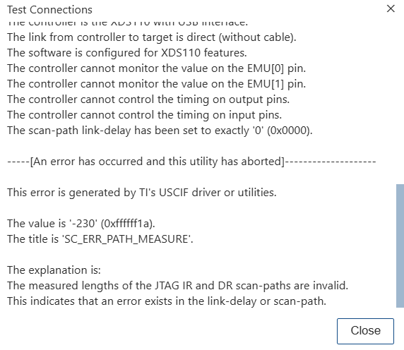

  • I tried changing tclk to 1MHZ, getting below error
    The error code -230 as shown in above screenshot is coming because the JTAG cannot find a consistent number of bits when trying to determine the length of the JTAG scan chain. This error varies depending on the target device configured, its status (locked, halted, running without control) or if the configured TCLK is too high.
    Please refer https://software-dl.ti.com/ccs/esd/documents/ccs_debugging_jtag_connectivity_issues.html#path-measure for details.
    Please change to clock setting to default instead of 1MHz.
    Also for error -1170 check the cable connection and connect JTAG after EVM is powered up. Try using the new *.ccxml file if the error persist.

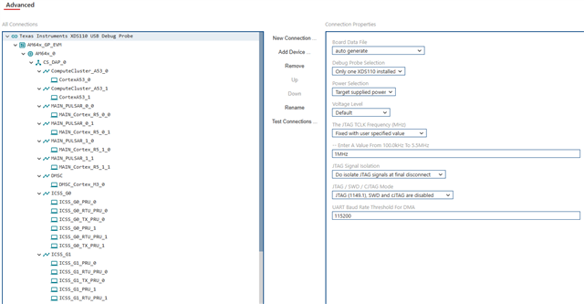

    This are my target config
    From AM64x from J25 connector we have connected to Debug port of XDS110 debug probe. And XDS110 debug probe to Host pc via USB. Only 1 led on debug probe  ie. D1 is glowing. & D2 is blinking when i do test connection
  • Hi Shraddha,
    I have tried on the TI AM64x EVM PROC101C(001) (REV. C) and the external XDS200 works there.
    I have checked the above target configuration files as you mentioned that you are using XDS560 and the target configuration shows XDS110 Debug Probe. Please change the field to XDS560 debug probe and try again.
