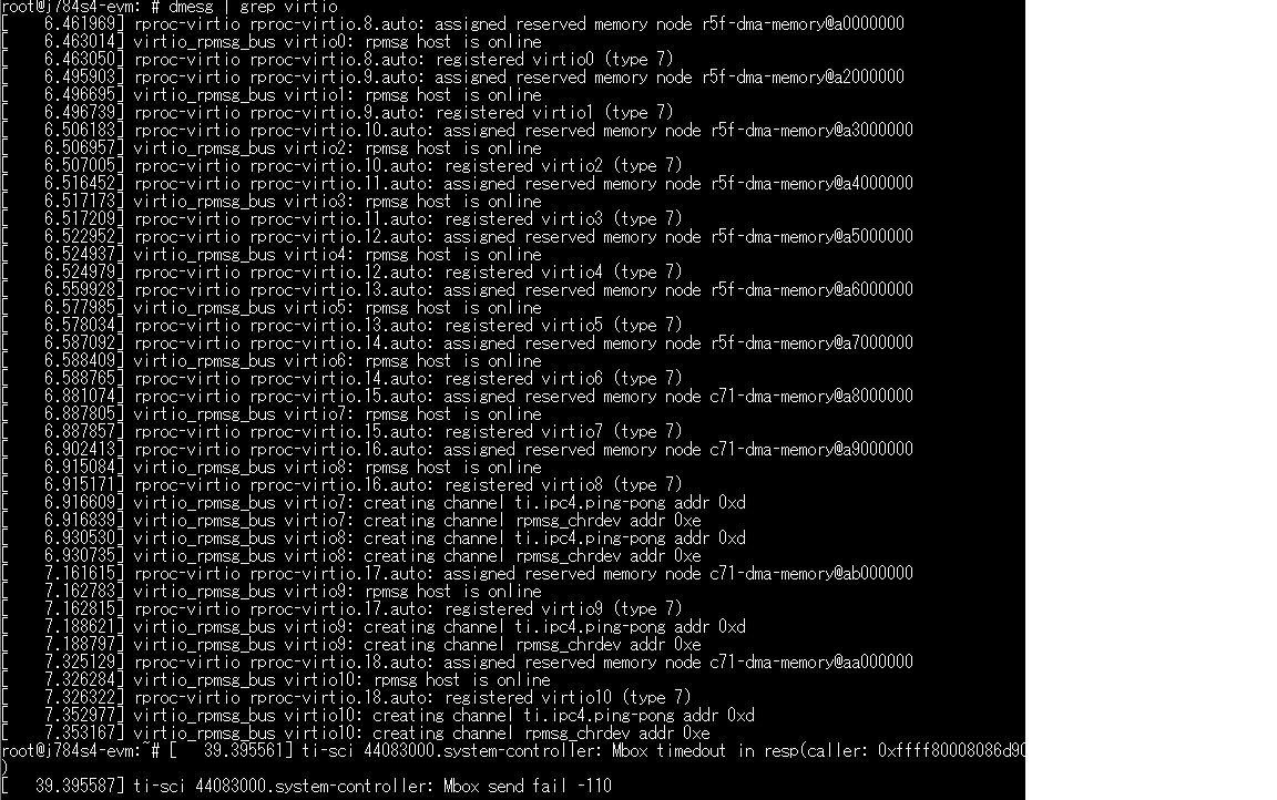

I am facing two issues:
First, MCU2_1, MCU3_1, and MCU4_1 do not operate at all.
Is there any special configuration required to enable or start these cores?

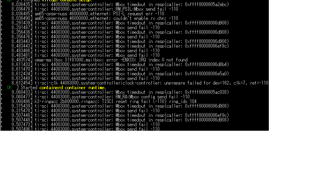

Second, in the code described above, if TaskP_sleepInMsecs(30000); is not set to a sufficiently long delay, a kernel panic occurs along with the error shown below.
Even when the delay is increased, the virtio devices are registered as shown below, but after some time an error still occurs on MCU1_0.
(MCU2_0, MCU3_0, and MCU4_0 continue to operate normally.)
I would appreciate your help with this issue.
thank you.

    The CSL_ArmR5MpuRegionCfg configuration is set as shown above, and dorprocboot in the uEnv.txt file is also set to 0.

    In the case of the rpmsg_char_simple test, if a channel creation message appears on virtio and no TI-SCI error occurs on the corresponding remoteproc, it operates normally.
    thank you.
    root@j784s4-evm:~# rpmsg_char_simple -r0 -n10

    root@j784s4-evm:~# dmesg | grep virtio
    dmesg | grep remoteproc
    [    6.525465] rproc-virtio rproc-virtio.8.auto: assigned reserved memory node r5f-dma-memory@a0000000
    [    6.543983] virtio_rpmsg_bus virtio0: rpmsg host is online
    [    6.544022] rproc-virtio rproc-virtio.8.auto: registered virtio0 (type 7)
    [    6.546789] rproc-virtio rproc-virtio.9.auto: assigned reserved memory node r5f-dma-memory@a6000000
    [    6.550338] virtio_rpmsg_bus virtio1: rpmsg host is online
    [    6.550380] rproc-virtio rproc-virtio.9.auto: registered virtio1 (type 7)
    [    6.559746] rproc-virtio rproc-virtio.8.auto: assigned reserved memory node r5f-dma-memory@a7000000
    [    6.562644] virtio_rpmsg_bus virtio0: rpmsg host is online
    [    6.562679] rproc-virtio rproc-virtio.8.auto: registered virtio0 (type 7)
    [    6.748590] rproc-virtio rproc-virtio.10.auto: assigned reserved memory node r5f-dma-memory@a2000000
    [    6.749201] virtio_rpmsg_bus virtio2: rpmsg host is online
    [    6.749235] rproc-virtio rproc-virtio.10.auto: registered virtio2 (type 7)
    [    6.754588] rproc-virtio rproc-virtio.11.auto: assigned reserved memory node r5f-dma-memory@a3000000
    [    6.755463] virtio_rpmsg_bus virtio3: rpmsg host is online
    [    6.755530] rproc-virtio rproc-virtio.11.auto: registered virtio3 (type 7)
    [    6.992341] rproc-virtio rproc-virtio.12.auto: assigned reserved memory node r5f-dma-memory@a4000000
    [    6.993292] virtio_rpmsg_bus virtio4: rpmsg host is online
    [    6.993323] rproc-virtio rproc-virtio.12.auto: registered virtio4 (type 7)
    [    6.996612] rproc-virtio rproc-virtio.13.auto: assigned reserved memory node r5f-dma-memory@a5000000
    [    6.997299] virtio_rpmsg_bus virtio5: rpmsg host is online
    [    6.997324] rproc-virtio rproc-virtio.13.auto: registered virtio5 (type 7)
    [    7.194533] rproc-virtio rproc-virtio.14.auto: assigned reserved memory node c71-dma-memory@a8000000
    [    7.195718] virtio_rpmsg_bus virtio6: rpmsg host is online
    [    7.195752] rproc-virtio rproc-virtio.14.auto: registered virtio6 (type 7)
    [    7.228389] virtio_rpmsg_bus virtio6: creating channel ti.ipc4.ping-pong addr 0xd
    [    7.228582] virtio_rpmsg_bus virtio6: creating channel rpmsg_chrdev addr 0xe
    [    7.281478] rproc-virtio rproc-virtio.15.auto: assigned reserved memory node c71-dma-memory@a9000000
    [    7.282560] virtio_rpmsg_bus virtio7: rpmsg host is online
    [    7.282599] rproc-virtio rproc-virtio.15.auto: registered virtio7 (type 7)
    [    7.290220] rproc-virtio rproc-virtio.16.auto: assigned reserved memory node c71-dma-memory@aa000000
    [    7.291537] virtio_rpmsg_bus virtio8: rpmsg host is online
    [    7.291570] rproc-virtio rproc-virtio.16.auto: registered virtio8 (type 7)
    [    7.310308] virtio_rpmsg_bus virtio7: creating channel ti.ipc4.ping-pong addr 0xd
    [    7.310451] virtio_rpmsg_bus virtio7: creating channel rpmsg_chrdev addr 0xe
    [    7.311523] rproc-virtio rproc-virtio.17.auto: assigned reserved memory node c71-dma-memory@ab000000
    [    7.313215] virtio_rpmsg_bus virtio9: rpmsg host is online
    [    7.313254] rproc-virtio rproc-virtio.17.auto: registered virtio9 (type 7)
    [    7.319366] virtio_rpmsg_bus virtio8: creating channel ti.ipc4.ping-pong addr 0xd
    [    7.319559] virtio_rpmsg_bus virtio8: creating channel rpmsg_chrdev addr 0xe
    [    7.340544] virtio_rpmsg_bus virtio9: creating channel ti.ipc4.ping-pong addr 0xd
    [    7.340721] virtio_rpmsg_bus virtio9: creating channel rpmsg_chrdev addr 0xe

    The errors are due to sciserver not able to address your sciclient calls from A72
    what if you increase the priorities sciserver task below , more than boot app task function which is 5
    appPrms.taskPriority[SCISERVER_TASK_USER_LO] = 1;
    appPrms.taskPriority[SCISERVER_TASK_USER_HI] = 4;
    Tarun Mukesh
  • Thank you for your response. The response was delayed because March 1st was a public holiday. I apologize for the delay.
    I changed the task priorities as shown below,
        appPrms.taskPriority[SCISERVER_TASK_USER_LO] = 4;
        appPrms.taskPriority[SCISERVER_TASK_USER_HI] = 5;
        ipc task = 3, ipc recv task = 3, send task=3
    and as a result, I was able to confirm that MCU2_1 and MCU3_1 are now operating correctly. However, communication with the MPU is still not working.
    (TI-SCI error no longer occurs as before)
