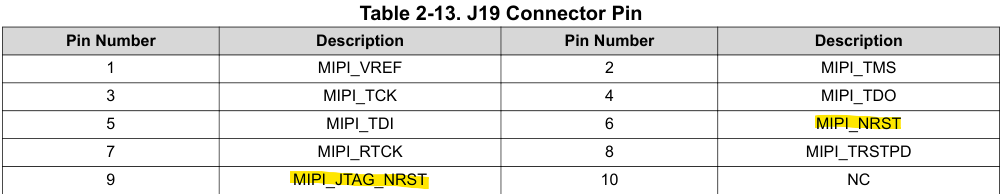

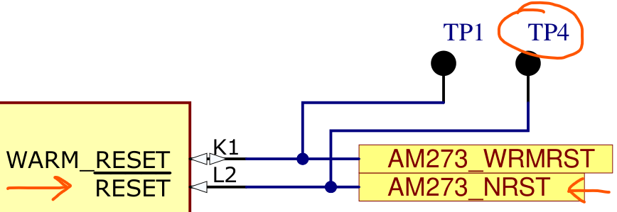

I would like connect the J19 pin 6 MIPI_NRST to the AM273_NRST (TP4 on the AM273x EVM) in order to issue the appropriate reset every time i debug my applications from the CCS 20.4.0 using a system project with R5Fs and C66, using an XDS560v2. The target is to test this connection, in order to proceed to a custom board design with this SoC.
  1. Are the following pins of J19 connector/XDS debugger (pin 6 MIPI_NRST and/or pin 9 MIPI_JTAG_NRST) used from the CCS every time a debug session is restarted?
    When i initiate a debug session and when i reload a binary, nothing is changing to the pins 6 & 9 (measuring with an oscilloscope they are constantly high). What actions should be made in CCS in order for the MIPI_NRST signal to work properly?
  2. Is the connection of the J19 pin 6 MIPI_NRST to the AM273_NRST the appropriate way to reset the SoC from the debugger?
Thanks in advance,

  • Hi Konstantinos,
    I think what you are looking for is the System Reset functionality within CCS. This works with the XDS TI debuggers.
    See CCS docs here: https://software-dl.ti.com/ccs/esd/documents/xdsdebugprobes/emu_resets.html
    See TI JTAG/TRACE debugger connector descriptions here: https://software-dl.ti.com/ccs/esd/documents/xdsdebugprobes/emu_jtag_connectors.html
    See "Table 12. MIPI 60-Pin Header Signal Naming Convention".
    For the MIPI-60 XDS debuggers, I pin 6 "MIPI_NRST" is the system reset pin and should be what CCS XDS debugger drivers toggle when the system reset function is called.
    The location of the GUI controls for this system reset may change depending on the CCS version, but I think it should be under the Run Menu >  Reset > System Reset. Should also popup when right clicking on the currently loaded target debug configuration.
    MIPI-60 pin 9 "JTAG_NRST" is the standard JTAG reset signal used to reset the attached device JTAG TAP. JTAG_NRST can be toggled by the attached debugger to reset the attached JTAG TAP. Depending on the debugger and its specific configuration, this might not toggle at all, or you might see just a single reset during power-on of the debugger.
    Let me know if you have any trouble finding that specific system reset functionality or seeing activity on the appropriate MIPI_NRST pin.
    Thank you,
    -Randy

    Konstantinos is attaching the XDS560V2 to one of our https://www.ti.com/tool/TMDS273EVM
    This target EVM just routes the J19.6 MIPI_NRST (System reset) signal to a 4.7k pull-up on the board and nowhere else. We didn't implement anything explicitly, but Konstantinos wants to mod the board to make use of this signal. When probing that signal though he is seeing no toggling at all.
    The driver read 0x6 and wrote 0x7 (i.e. we set bit 0) to the register at offset 0xF0 on AP 7 (that's what the 0x207F0 means).
    According to the device xml file, this is the SPREC register on the PWR-AP. According to the PWR-AP spec for the mspm0, bit 0 is SYS RST bit. As far as I know, the system reset bit is the same across all PWR-AP implementations.
    What were you referencing here? What that something specific to the XDS560v2 driver and firmware? I no longer have this emulator available to test with myself. In this case the target board behavior is not going to effect the pin behavior. Konstantios was just probing the MIPI-60 pins to see the expected toggle and is not.
    There is nothing on the target EVM to stop this signal, so I am suspecting something might be different on the drivers/CCS SW/XDS560V2 FW chain and has not been verified in a long time. Can someone in SDTO verify that this register write actually toggles the XDS560V2 pin as expected?
