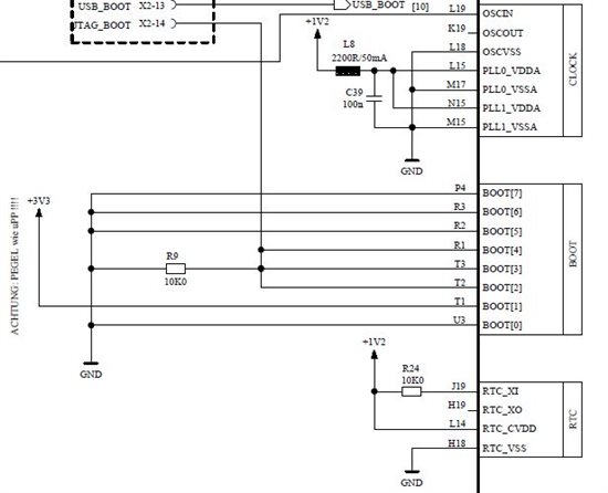

We are using the OMAP L138B and the standard boot configuration is 02h.
As we als want to boot with the JTAG interface, we connected the pins BOOT[2], BOOT[3], BOOT[4] with an external pulldown resistor to GND,
as shown in the following schematic.

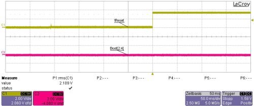

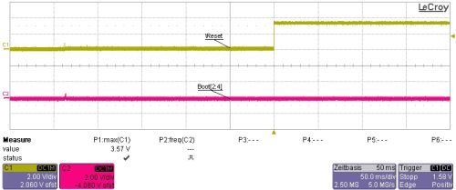

I have recorded the states of the boot pins [2]-[4] and the scope diagramm shows following:

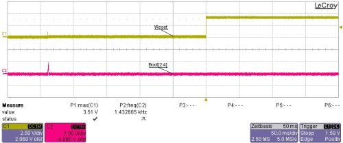

There´s a small glitch 240 ms before the rising edge of the reset. At the time of the rising edge,
the state of the boot pins is low ! Thus, the boot value should be 02h and not 1Eh !
I tried to use a stronger pulldown and change the resistor value to 1k. The result is:
The glitch is smaller than before, but the state at the moment of rising edge is low.
But, compared to the diagramm before, the OMAP starts und is booting !
I also compared this states with a PCB which has no problems:
 Here, there is no glitch before the rising edge, but the pulldown resistor has still the value of 10k !
Now, I have problems to understand this !  We have no problem to change the resistor value from
10k to 1k... but, is this the solution ? Is there anything else, we don´t know yet ?

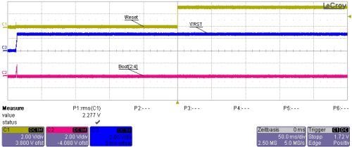

  • Hi Jeff,
    instead of using CCS for debugging, we use a Lauterbach debugger. My SW colleague verified that the boot mode is wrong because the value in the BOOTCFG register is 0x1Eh.
    The \TRST has an external pullup (blue line). So, every reset is like a warm reset.
    It seems, that this wiring is an error !
    It seems that with the rising edge of the \TRST the wrong states of the boot pins are latched caused by the glitch.
    As all following resets are warm resets, the wrong boot mode is not changed.
    After your post, I´ve made to two tests:
    a) connecting the \TRST hard-wired to GND
    first, the wrong boot mode was latched, after the reset of the watchdog the OMAP booted correctly
    b) removing the pullup resistor and the wire to GND and leave the pin floating
    In both tests at first the state of the boot pins was high, so the wrong boot mode was latched.
    After the rising edge of the reset, the state of the boot pins went low and the OMAP booted correctly.
    It seems that a warm reset doesn´t re-latch the boot pins by the rising edge of the reset.
    I think we have different options now:
    i) connecting the \TRST pullup to GND
    ii) using a pulldown resistor instead of the pullup resistor (\TRST)
    iii) leaving the \TRST pin floating
    iv) using a strong pulldown resistor (<1k)  instead of  the 10k at the boot pins
    Option ii) is a long-term solution because it requires a redesing of the PCB
    Option i) is possible but it requires an additional wire soldering by hand -> higher manufacturing costs   -> not the prefered solution
    Option iii) is possible but it is no good solution !
    Option iv) is maybe the best short-term solution for our problem.
    If you or anybody else has further more solution, please feel free to post it  ;-)
    I´m grateful for any other solution !
    Andreas

  • Jeff,
    unfortunately, my SW colleague was in a meeting the whole day.
    So, here are the results:
    This is the scope shot of the first (failed) boot attemp. The TRST is tied to GND. The external pulldown is too weak holding the boot pins low and the voltage rises up to ~2 V.
    After the rising edge of the RST, the internal pullups are disabled, but the wrong boot configuration is latched.
    After the reset of the external watchdog the correct boot configuration is latched and the OMAP starts to boot.
    But this works only if the TRST is low.
    My colleague read the memory location 0xFFFF0700 and the value is 0x00000000.
