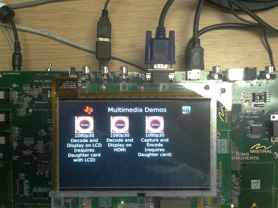

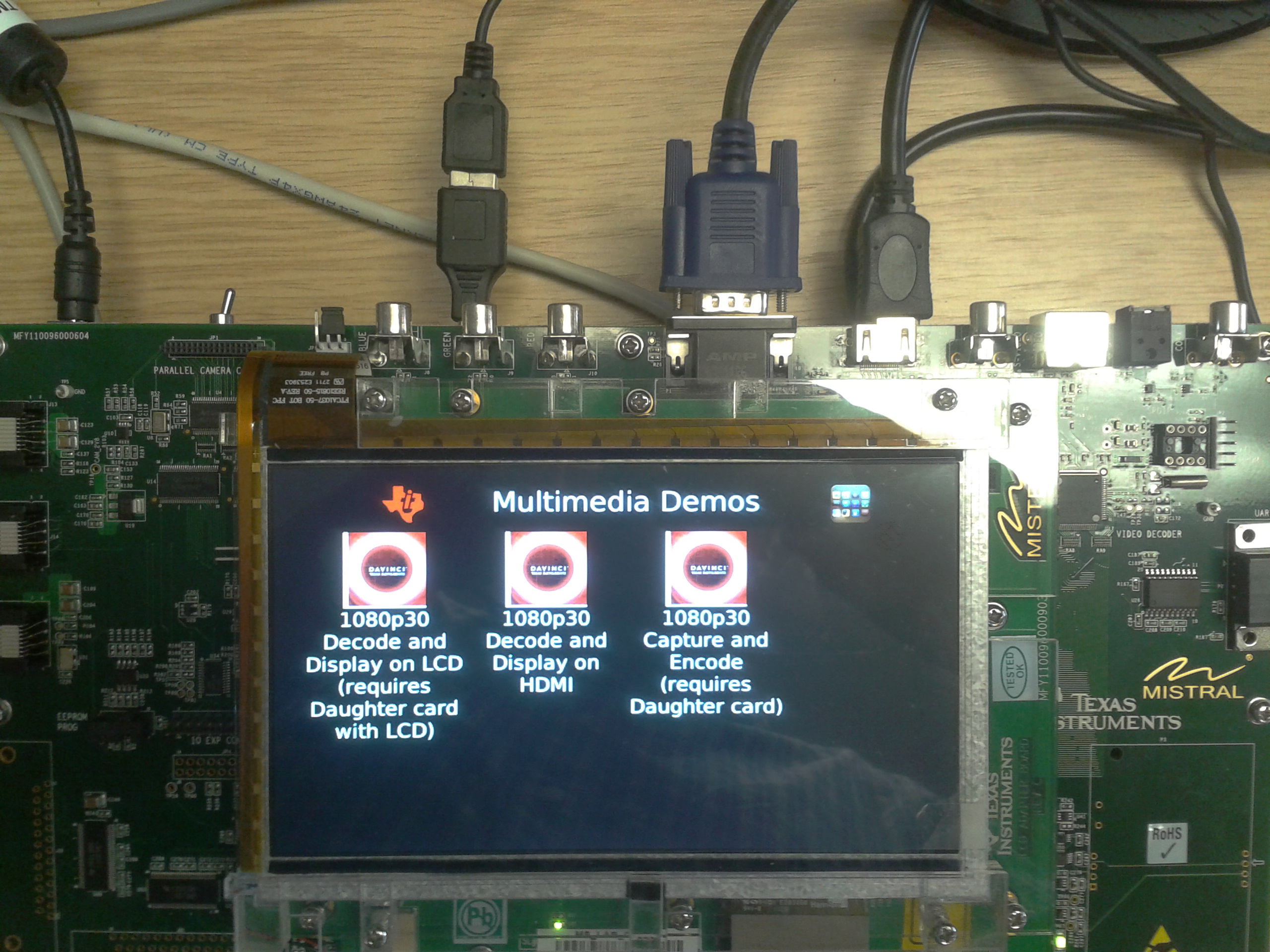

  • Hi Hardik,
    Sorry for bothering you again. Just one question.
    Is it true that VGA output is not supported in DM814x-EVM? I successfully tested HDMI but VGA seems not working.
    Is this software limitation?
    Andrei
  • Andrei,
    DM814X EVM does not have VGA output port.but in your own HW board, you can hook a external DAC to the DVO port of TI814X to support VGA output.
    yihe
  • Great,
    Link is very good source of reference. Can you please mark thread as answered so others will also come to know about it.
    Hardik Shah
    How are you testing VGA, there is not VGA connector on board. Are you sure you are using DM8148 and not DM8168, because DM8168 has VGA connector and VGA output.
    Hardik Shah
  • Hi Stephane,
    You must first switch to 1280x720 mode first, look at my bash script (from previous post) for the reference how to do this, then you should be able to run on full-screen.
    Andrei
  • Hi Hardik,
    Yes it's there, on Expansion I/O BOARD REV D.
    Andrei
    That is VGA input not output.
    Hardik Shah
  • Oh, really. Never heard about VGA input in the embedded system.
    Cool :-)
    Andrei
  • This is for PC input, output of your PC will go here and you can send it over network.
    Hardik Shah
  • It's a great feature!
    Thanks for letting me know, this is fantastic.
    Andrei
