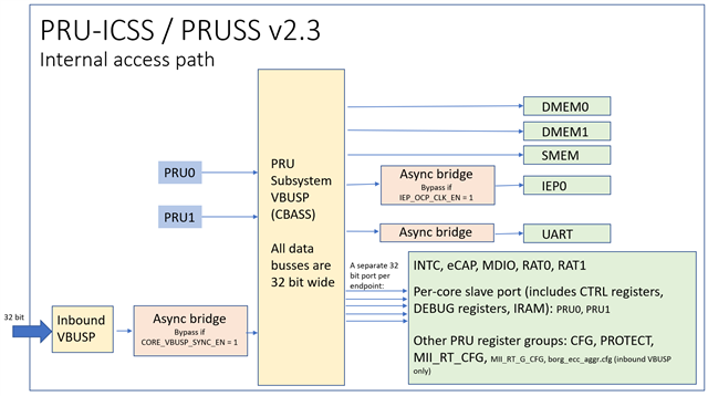

  • PRU-ICSS & PRUSS - external access path
    This is the path that read & write commands take when accessing peripherals or memory outside of the PRU subsystem.
  • PRU-ICSS & PRUSS: Internal access path
    This is the path that read & write commands take when accessing peripherals or memory within the PRU subsystem.
  • PRU_ICSSG: External access path
  • PRU_ICSSG: Internal access path
  • How do simultaneous reads & writes occur on a VBUSP bus?
    Each output port allows one in-progress command.
    That command can be a read, or a write.
    “head of line” blocking occurs.
    Reads can block writes, and vice versa.
    There is no "line" that keeps track of the next read or write to execute, because there is no command FIFO per output port on a VBUSP. The highest priority initiator will go next as soon as the output port becomes free. This can lead to starving lower priority initiators. For example, a R5F core trying to write to DMEM0 could be continuously preempted by PRU0 & PRU1.
    TODO: verify relative priority of each initiator for each bus
    A PRU/XFR2VBUS write of N [output_port_data_width]-bit words blocks the VBUSP port for N PRU clocks, until the data has exited the PRU subsystem
    A write to a VBUSP output port blocks BOTH write and read commands from getting executed to that output port until the write has completed the N clock cycles. This is DIFFERENT from VBUSM. On the VBUSM, an ongoing write will not block a read command from starting to execute.
    Let's use a 64-Byte write on PRU_ICSSG as an example. Slice 0 VBUSP has an output port data bus width of 32 bits, so a 64 Byte read would block the output port for (64 Bytes x 8 bits/Byte / 32 bits/clock) = 16 clocks. On the other hand, XFR2VBUS TX VBUSP has an output port data bus width of 64 bits, so a 64 Byte read would block the output port for 8 clocks.
    A read blocks until the read is complete
