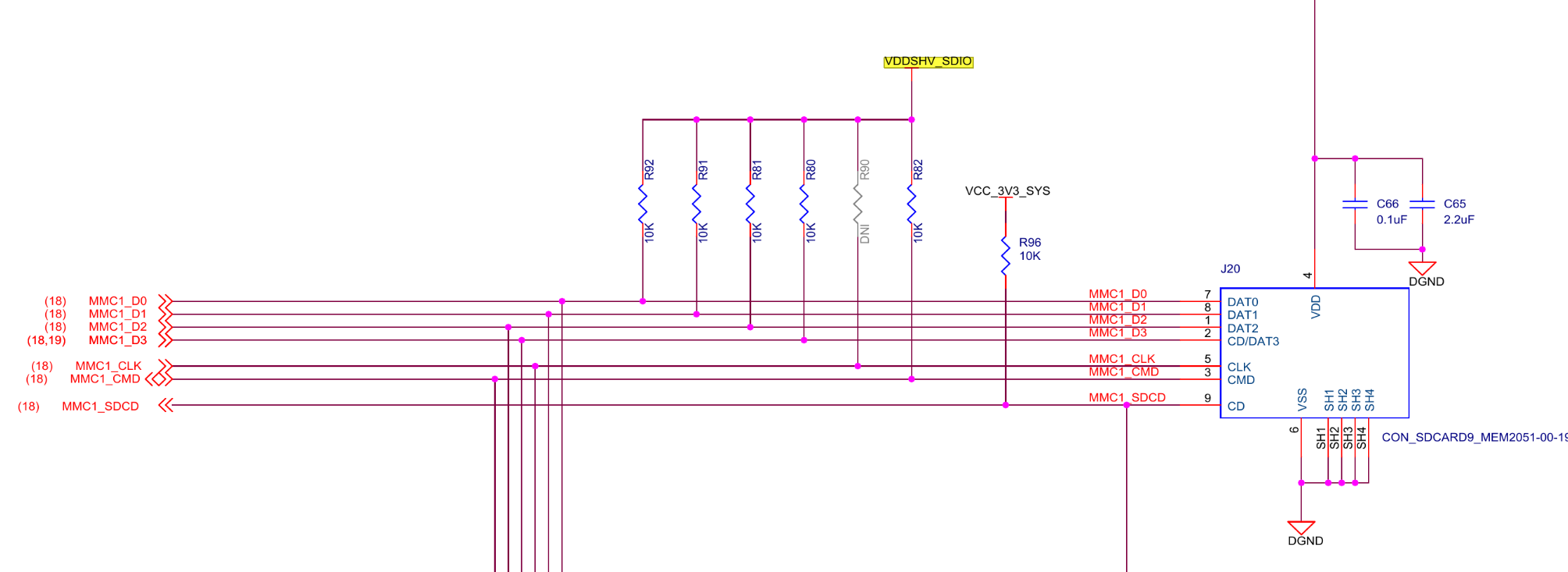

hi everyone,
I'm having the following problem: I'm trying to boot my custom board from a boot SD card, but it fails when the power is switched on, since I haven't configured it that way because the power supply is fixed.

As for the hardware, the power supply for both the I/O and VCC pins of the SD card is a constant 3.3V.
These are the pull-ups:

I tried running vdd_mmc1 and vdd_sd_dv separately and together, but the error persists.
From USB-DFU, I reach the u-boot console/prompt, but with the SD card, it gets stuck at the login screen shown here, even though I'm using the same tiboot3.bin, tispl.bin, and u-boot.img files.
