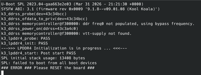

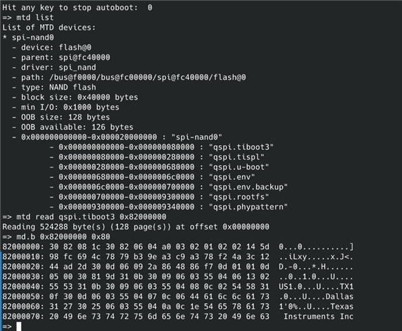

  • Hi Vinu,
    I have a problem, which is as follows:
    Context: From USB-DFU mode, I load tiboot3.bin, tispl.bin, and u-boot.img into RAM. I reach the u-boot prompt.
    U-Boot SPL 2023.04-gcbaa43190a (Mar 30 2026 - 18:26:28 +0000)
    SYSFW ABI: 3.1 (firmware rev 0x0009 '9.1.8--v09.01.08 (Kool Koala)')

    => mtd list
    List of MTD devices:
    * spi-nand0
    - device: flash@0
    - parent: spi@fc40000
    - driver: spi_nand
    - path: /bus@f0000/bus@fc00000/spi@fc40000/flash@0
    - type: NAND flash
    - block size: 0x40000 bytes
    - min I/O: 0x1000 bytes
    - OOB size: 128 bytes
    - OOB available: 126 bytes
    - 0x000000000000-0x000020000000 : "spi-nand0"
    - 0x000000000000-0x000000080000 : "qspi.tiboot3"
    - 0x000000080000-0x000000280000 : "qspi.tispl"
    - 0x000000280000-0x000000680000 : "qspi.u-boot"
    - 0x000000680000-0x0000006c0000 : "qspi.env"
    - 0x0000006c0000-0x000000700000 : "qspi.env.backup"
    - 0x000000700000-0x000009300000 : "qspi.rootfs"
    - 0x000009300000-0x000009340000 : "qspi.phypattern"
    Now I want to flash the NAND memory I have to get to the same place (the u-boot prompt). I don't want to see the kernel yet. Therefore:

  • What do I need to enable in the R5 and A53 settings to enable support for booting from serial NAND?
    because I have this outing now:
    U-Boot SPL 2023.04-gaa663e2e03 (Mar 31 2026 - 21:21:30 +0000)
    k3_ddrss_probe(dev=43c34bcc)
    k3_ddrss_ofdata_to_priv(dev=43c34bcc)
    k3_ddrss memorycontroller@f300000: ddr freq0 not populated, using bypass frequency.
    k3_ddrss_power_on(ddrss=43c3a4c0)
    k3_ddrss memorycontroller@f300000: vtt-supply not found.
    k3_lpddr4_probe: PASS
    k3_lpddr4_init: PASS
    --->>> LPDDR4 Initialization is in progress ... <<<---
    k3_lpddr4_start: Post start PASS
    SPL initial stack usage: 13408 bytes
    SPL: failed to boot from all boot devices
    ### ERROR ### Please RESET the board ###

    Yesterday, using usb-dfu, I erased the entire NAND flash memory and re-flashed tiboot3, tispl, and u-boot. I rebooted the device, and the following message appeared in the console:
    Is your tiboot3 loading now from NAND? Which boot mode is selected above?
    It now appears that tiboot3 is loading but crashes at the SPL, which is why I was asking if I need to add some kind of support to the r5 and a53 configs or to the am62x.env file.
    The boot mode I have selected is “serial nand”
    I hope this information clarifies the situation and helps us find a solution.
    Let's move forward and then assess the pending kernel issue.
    Regarding the latest issue, it seems that the R5 SPL (tiboot3) is running.
    Which implies that the RBL has read from NAND successfully and loaded tiboo3.bin.
    The failure is when the R5 SPL trying to load tispl.bin from NAND.
    The following are some of the required r5 configs to enable NAND on R5 SPL.
    CONFIG_MTD=y
    CONFIG_DM_MTD=y
    CONFIG_MTD_SPI_NAND=y
    CONFIG_SPL_MTD=y
    CONFIG_SPL_MTD_LOAD=y
    CONFIG_SPL_NAND_SPI_SUPPORT=y
    These are the unwanted configs (required for NOR). Please disable if unnecessary.
    CONFIG_SPL_SPI_FLASH_SUPPORT
    CONFIG_SPL_SPI_FLASH_SFDP_SUPPORT
    CONFIG_SPI_FLASH_SFDP_SUPPORT
    CONFIG_SPI_FLASH_SPANSION
    CONFIG_SPI_FLASH_S28HX_T
    CONFIG_SPL_SPI_LOAD
    Please make sure that these are enabled, and share the current configs, which are being used.
    Also, can you confirm if you are using the DFU enabled bootloaders from NAND? Or are you using DFU enabled bootloaders just to transfer the default bootloader files (without DFU enabled)?
    Vinu
