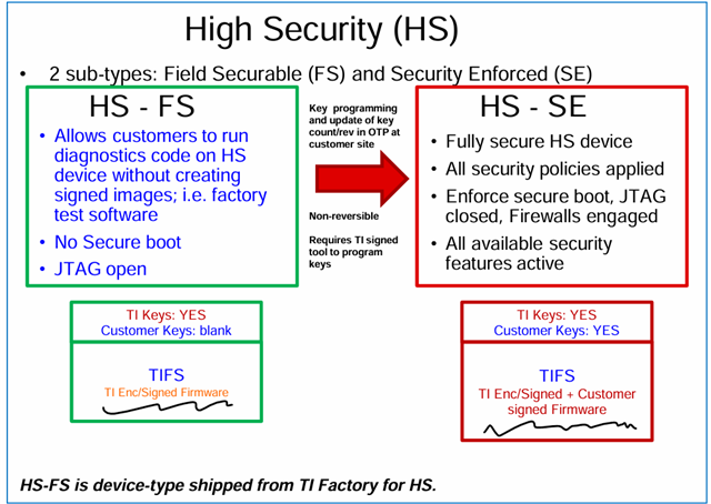

    For Secure Boot keys usage, we have another question:
    As we know for HS-FS device, the customer keys are not injected, so the secure boot will use TI Root key set (MPK / MEK) to sign the TIFS and R5F_DM images. I think this is clear.
    But for HS-SE device, after Customer keys injected, for TIFS and R5F_DM image, will use which keys? also use TI root keys (MPK and MEK)  or Customer Keys (SMPK / SMEK).
    According to this diagram, the TIFS image of HE-SE, does it mean signed by TI root keys firstly, and sign with customer keys again?
     The confused info is according to below diagram, for HS-SE device, the TI keys will be invalid, does it mean after customer keys injected, the TI root keys will be never used any more?
    BR
    Tim.
  • Hi Tim,
    There is no concept of secure boot on HSFS devices. The TIFS firmware only is signed with TI keys  but the user applications are signed with any random key on the HSFS devices.
    On the HSSE devices, the SBL and the applications are signed with the active customer programmed keys (SMPK or BMPK) and the TIFS firmware is signed with TI keys only.
    Prashant

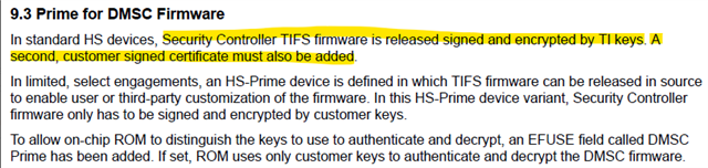

  • Hello Prashant,
    Almost clear for this.
    The SBL and other user application image will be signed and encrypted by customer keys, but for TIFS, seems also have conflict info in "K3 Security Hardware Architecture" (SPRUIM0C.pdf) - chapter 9 Security Booting Flow:
    could you help to confirm?
    BR.
    Tim
  • Hi Tim,
    This is for Prime Model of the devices which is not supported on the SITARA devices like AM62P. The TIFS is signed with TI keys only on AM62 devices. Basically, the customer do not need to concern with the signing of the TIFS firmware as it is provided as already signed blobs in the SDKs.

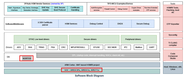

  • Hello Prashant,
    For am62px SDKs, we only have the binary file of TIFS, is there any diagram or architecture to introduce it?
    we got the TIFS package of am263px, its SW component as below:
    for am62px TIFS, is there mainly differences compared with this?
    BR
    AM62P and AM263 are two different devices with different architectures. The TIFS is a closed source software and so provided as binary blobs only in the SDKs.
