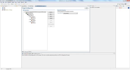

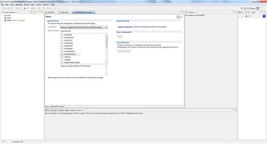

         So nobody must be using the Spectrum Digital OAMP137 EVM board anymore. I started a blank CCS project from scratch again. I imported my DSP source code files into the project and then I added a RSTC configuration file selecting the EVMOMAP137 with a Connection of "Spectrum Digital DSK-EVM PLUS onboard USB Emulator". From the .ccxml screens it seems like the device settings are correct:

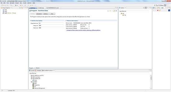

    But then looking at the .cfg Runtime screen under Platform information I notice that the device is a TMS320DA830 and to modify this I need to select a different platform:
    Because the device is not the correct, the memory map is wrong and linking process fails:
    MEMORY CONFIGURATION
             name            origin    length      used     unused   attr    fill
      IROM                  11700000   00100000  00000000  00100000  R  X
      IRAM                  11800000   00040000  00000000  00040000  RW X
      L3_CBA_RAM            80000000   00020000  00000000  00020000  RW X
      SDRAM                 c3000000   01000000  000261f7  00fd9e09  RWIX
        So what is the failure here? Have I found an issue because I did not originally create a RTSC project? If the .ccxml screens tell me it is a OAMPL137 then the device should be mapped correctly. Any help would be appreciated.
