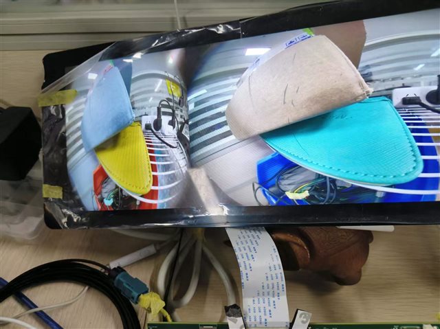

AM62A7: Gstreamer pipeline frame sequence error when high cpu usage
Part Number: AM62A7
SDK ver: 10_00_00_08
Here is the related question:
AM62A7: Frame skips when high CPU usage - Processors forum - Processors - TI E2E support forums
I previously raised this issue. Following the latest reply in the thread, I modified the pipeline, then simulated high CPU load using stress-ng --cpu 4 --cpu-load 70 --timeout 200, and the video frame sequence corruption issue still reproduces. Below are my pipeline and the trace files.
GST_DEBUG_FILE=/run/trace.log GST_DEBUG_NO_COLOR=1 GST_DEBUG="GST_TRACER:7" GST_TRACERS="latency(flags=element)" gst-launch-1.0 v4l2src device=/dev/video3 io-mode=dmabuf-import ! \
video/x-raw, format=UYVY, width=1920, height=1536, framerate=60/1 ! \
tiovxldc dcc-file="/root/isp_config/dcc_ldc.bin" sensor-name="X3F" ! \
video/x-raw, format=NV12, width=1920, height=1536, framerate=60/1 ! \
tee name=t \
t. ! tiovxmultiscaler name=multi target=0 \
multi.src_0 ! video/x-raw, width=1280,height=720,format=NV12 ! queue ! mosaic.sink_0 \
multi.src_1 ! video/x-raw, width=640,height=720,format=NV12 ! queue ! mosaic.sink_1 \
t. ! queue max-size-buffers=1 leaky=downstream ! tiovxmultiscaler name=multi2 target=1 \
multi2.src_0 ! video/x-raw, width=608,height=608,format=NV12 ! \
fakesink  \
tiovxmosaic name=mosaic \
sink_0::startx="<0>" sink_0::starty="<0>" \
sink_1::startx="<1280>" sink_1::starty="<0>" ! \
video/x-raw, width=1920, height=720 ! \
kmssink driver-name=tidss force-modesetting=true sync=false

    Sorry for the delay in responding. I just came back from a business trip.
    However, the image in the second channel turned discolored after MSC.
    Was this the same issue reported by you here: https://e2e.ti.com/support/processors-group/processors/f/processors-forum/1565297/am62a7-vpac-related-gstreamer-plugins-in-sbl-boot-mode/6071738?
    I apologize for not being able to follow up at that time. To confirm my understanding, can you run the following pipeline and share a picture of the display?
    gst-launch-1.0 videotestsrc is-live=true pattern=blue ! \
    video/x-raw,width=1920,height=1536,format=NV12,framerate=60/1 ! \
    queue ! \
    tiovxmultiscaler target=1 name=multi \
    src_0::roi-startx=0 src_0::roi-starty=0 src_0::roi-width=1920 src_0::roi-height=1280 \
    src_1::roi-startx=0 src_1::roi-starty=0 src_1::roi-width=1920 src_1::roi-height=1080 \
    tiovxmosaic target=0 name=mosaic \
    kmssink driver-name=tidss sync=false skip-vsync=true
    Thank you.
    Jianzhong
  • Hi Jason,
    As we communicated offline, applying the following two patches on top of 11.1 SDK fixed the problem:
    [0] - git.ti.com/.../
    [1] - https://github.com/TexasInstruments/edgeai-gst-plugins/commit/cbc6b6e43db48b01b410e94fb7499447ad31ac42
    Jianzhong
