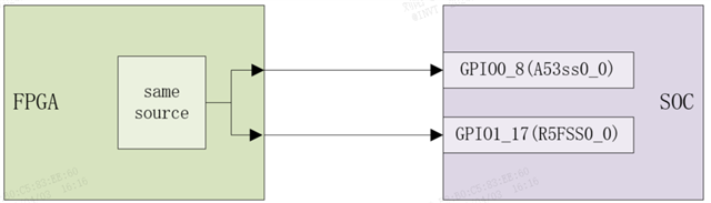

    I will need a schematic which represents any possible interconnections between the two GPIO pins from external side.  Are the GPIO1_17 and GPIO0_8 output and input  buffers disabled at the moment when IRQ initialization for the two inputs is performed. Is GPIO1_17 and GPIO0_8 interrupt status cleared before arming (enabling) the corresponding IRQs.

  • Dear TI Experts,
    Regarding your reply, additional details are supplemented as follows:
    1. The topology diagram of the GPIO trigger signal is shown in Figure 1. The trigger signal comes from the same signal source of the FPGA. The peripheral connection circuits of the two GPIO pins are completely identical, and edge triggering is used.

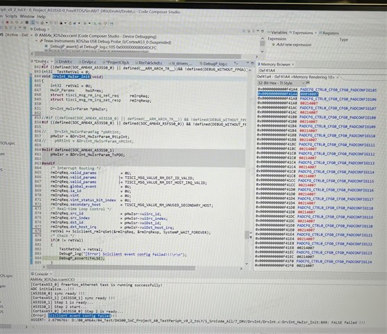

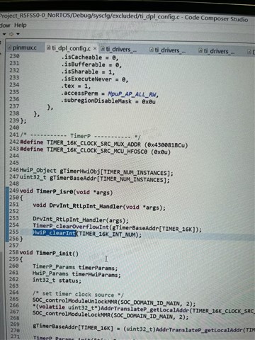

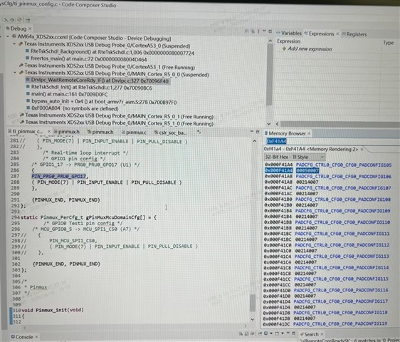

    2. After the program runs, the register values of GPIO1_17 and GPIO0_8 have been checked, both of which are 0x50007 with the 18th bit set to 1, and neither has the receive buffer disabled. Screenshots of the register checks for A53SS0_0 and R5FSS0_0 are shown in Figure 2 and Figure 3 respectively.
    3. After inspecting the code, it has been confirmed that both the A53SS0_0 core and the R5FSS0_0 core clear interrupts through the Hwip_clearInt function after each interrupt execution is completed. The code screenshot is shown in Figure 4.

  • Dear TI Expert,
    Here is a supplementary reply to the question “What do you mean under - the interrupt initialization of the A53_0 core fails?”:
    After completing the interrupt configuration in A53SS0_0, and calling the Sciclient_rmIrqSet function, the return value is -1 instead of 0. This results in the
    print log shown in the figure below, and an assertion is triggered after the printing is finished.

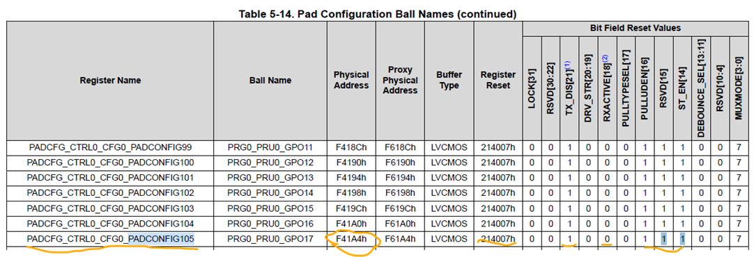

    From AM64x Datasheet, the GPIO1_17 corresponding SoC pin: PRG0_PRU0_GPO17  has the following default pin-mux settings:
    After POR: The input and output buffers are OFF, weak pulls disabled, GPIO1_17 signal selected by default on U1 pin -> the U1 pin shall be HiZ after POR.
    According to the  AM64x TRM, the responsible register is PADCFG_CTRL0_CFG0_PADCONFIG105 at physical address = 0x000F41A4 (matches your used address).
    In your case its register value was changed to 0x00050007:
    PADCFG_CTRL0_CFG0_PADCONFIG105[31:20] = 0x0 -> TX_DIS=0 -> Output buffer enable/disable depends on the GPIO IP itself  - seems like TX_DIS was cleared  in a previous running program or your app.
    [19:16]=0x5  -> Input buffer is enabled (RX_ACTIVE=HIGH), weak pull down enabled, [15:0] = 0x7 -> Schmitt Trigger is disabled (is this intentionally done ?), MuxMode=0x7 -> Q: Does the value = 0x00050007 reflects the state of the padconfiguration105  register during your interrupt setup ?

    Yang,
    In the particular case when both GPIO pins are tied-off together, and SoC pin output buffers are enabled, there is a possibility of spurious interrupts triggering. If the GPIO1_17 IP output and its Soc pin output are enabled (as it is in your case), flipping the GPIO1_17 OUTPUT_DATA value can cause the other GPIO input to see a pulse transition and detect an undesired interrupt event. Also if  FPGA output is initially to a HiZ, because AM6442 is initialized before it, I would recommend to use external 10k pull resistors at the AM6442 GPIO input pins to avoid spurious interrupt triggering. Select the pull type to match the initial level corresponding to the triggered edge event (PD for rising edge, PU for falling edge).
