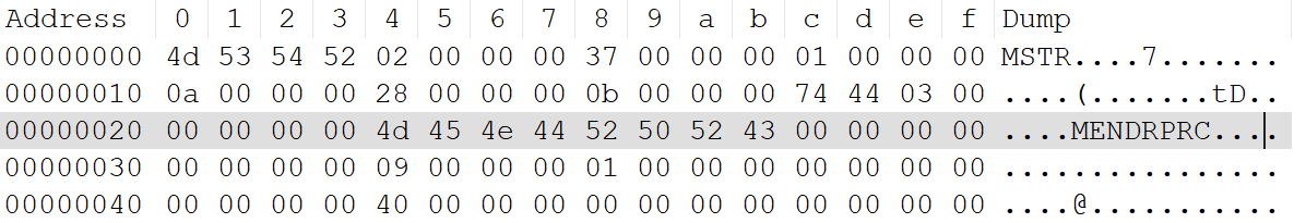

The error occurs in the SBL_MulticoreImageParse function. This function is called for both MMC/SD and OSPI boot modes. The same lateapp1 and lateapp2 images are used in both cases.
  • MMC/SD boot: works correctly
    • magic number 0x5254534d 0x5254534d
      file Read Time: 171091
      file Read Time: 359769
  • OSPI boot: results in "invalid magic number" error
Below is the hex dump of the lateapp1 image.
I have checked similar issues discussed in forums, but could not find a clear solution.
Any help would be greatly appreciated.

    I have confirmed that OSPI boot is working correctly.
    However, the issue was not related to the pattern size (it was verified to be 512Mb and the address 0x3FC0000 is correct), but rather an error in the SDK Guide documentation.
    In the guide, the flash layout is described as follows:
    • sbl_cust_img_mcu1_0_release.tiimage at an offset of 0x0
    • tifs.bin at an offset of 0x8000
    • boot_app_ospi_linux_<board_name>_mcu1_0_freertos_TestApp_release.appimage at an offset of 0x100000
    • stage1 image at an offset of 0x1fc0000
    • stage2 image at an offset of 0x27c0000
    • atf_optee.appimage at an offset of 0x1c0000
    • tidtb_linux.appimage at an offset of 0x7c0000
    • tikernelimage_linux.appimage at an offset of 0x1ec0000
    However, the locations of tidtb_linux.appimage and tikernelimage_linux.appimage are swapped.
    If flashed according to the guide, the kernel image overwrites the stage1 image region.
    By reviewing the actual SBL source code, it is clear that:
    • the kernel should be located at 0x7c0000
    • the DTB should be located at 0x1ec0000
    It would be appreciated if the documentation could be updated accordingly.
