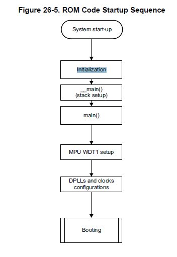

Hi ti,
I debug a custom Am3359 design that use TP65910/DDR3. And Now, the CPU prints "C"  repeatedly, unlikely the beaglebone prints eight "C"  then wait watchdog.
I check status register &WDT1 related register. BOOT , CLK frequency all fine(00001 UART0-XIP-MMC0-SPI,26MHz,);  WDT1 registers valided. clkout2 also can output L3_CLK,,,
JTAG linked to the board, seems that the program in "internal ROM" executes circle.
I think, DPLL  ,WDT setup is fine. reference  Fg 26-5 TRM. the "internal ROM" run to booting.

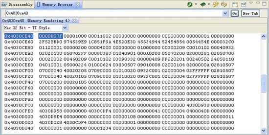

  • Try looking at the tracing vector that the ROM code provides. The TRM gives the address and the bit field definitions for the tracing vector.
    Vaibhav
    Vaibhav
    Thanks.
    Trace vector as the figure:
    The vectors show that Am335X have not found proper boot device(Am335X should have be in the reserved dead loop).
    We find the strange thing. When AM335X linked with Jtag firstly,  we can read memory data as the figure. After resuming Am335X and pausing later, memory reading error until resetting the CPU(not PROZ).
    If this prevents to loading SPL &Uboot...
