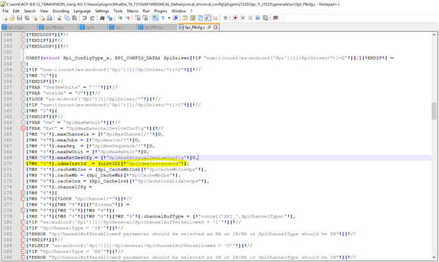

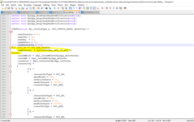

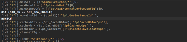

Hello Team,
MCAL Package: MCUSW_11_01_00_03_CONFIG-windows-installer.exe + MCUSW_J722S_11.01.00.03.zip
Below is the error message reported while integrating Spi driver from above mentioned MCAL Package:
{code}
C:/work/ACP-8.8.12_TDA4VENCR5_clang-4.0.1/tests/Compile/Spi_ComTest_2/output/generated/src/Spi_PBcfg.c:136:28: error: use of undeclared identifier 'UDMA_INST_ID_MCU_0'
  136 |     .udmaInstId  = (uint32)UDMA_INST_ID_MCU_0,
{code}
UDMA_INST_ID_MCU_0 is not defined in the Package.
Could you please provide your feedback on this?
