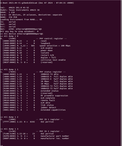

In our project we are using processor AM6231AKGGHHALW and ethernet phy DP83848KSQ/NOPB.
 We are facing a etheret problme sometimes with some boards. During the problem u-boot will give this error message
In this time Reading phy register with u-boot mii command giving ffff result
And in linux
root@user1-                :/sys/devices/platform/bus@f0000/8000000.ethernet/net/eth0# cat carrier
cat: read error: Invalid argument
And it is showing
Configuring network interfaces... RTNETLINK answers: No such device
Some board the issue is permanant. and in some board it is comming after 3 time reboot or 5 time reboot and it is very random nature. some time it is working.

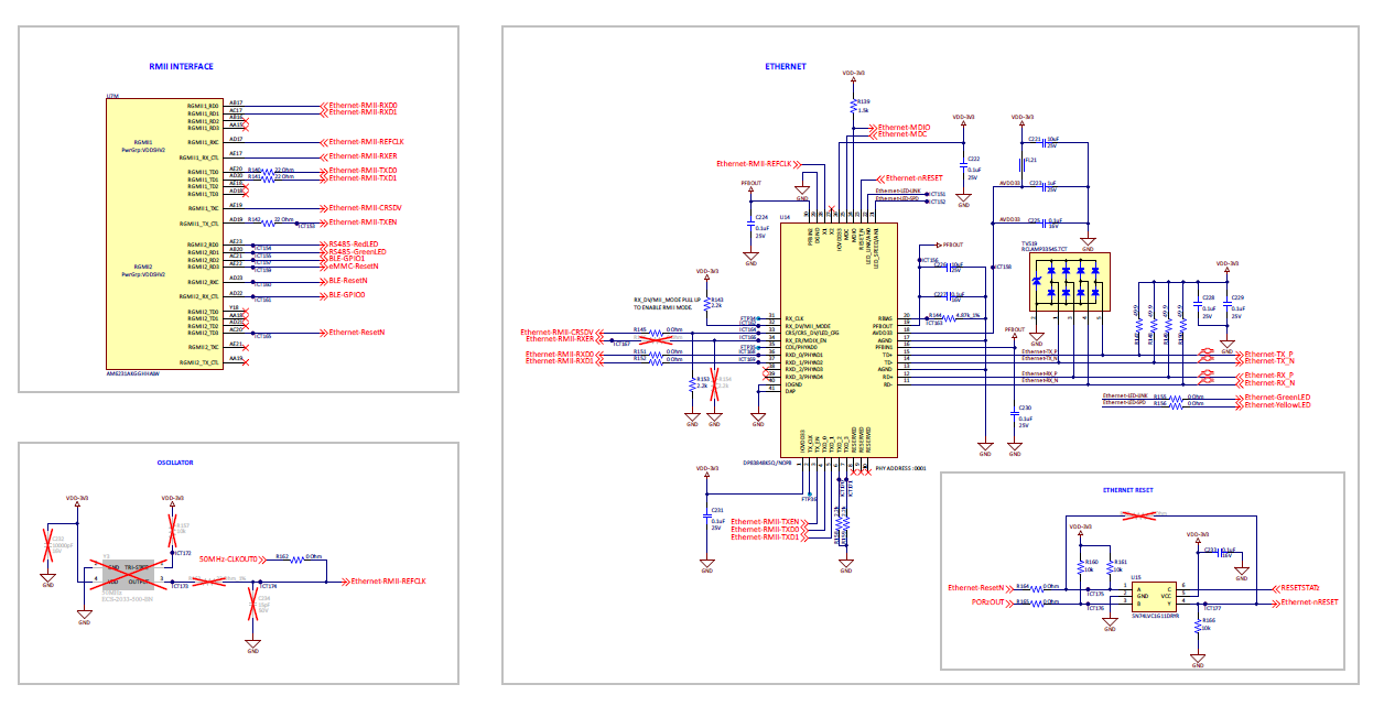

  • If you don’t mind, could you please share your email address for sharing the document?
  • Hello Jomon Thomas,
    Please send a hi message and later you can share the info securely.
    Sreenivasa
    I received the schematics through Dhruva Kashyap
    Please make the below changes and do a check.
    C234 - add a 10K pulldown using the cap pads
    R160 - DNI
    Sreenivasa
    Route clock as point to point  add a dual buffer Take note of the buffer placement   Refer schematics checklist SFO
    Yes considered during PCB design
    In the schematic i have, the processor clock output connects to the SOC RMII input and the EPHY without a buffer.
    This is likely to affect the functionality.
    Can you confirm the revision of the schematics you have for me check with the schematic i have.
    Sreenivasa
  • U15 ANDing logic representation is confusing. Use 3 input AND gate symbol.
    Please do the following
    DNI 165
    populate R161
    Disable PORz_OUT and use RESETSTATz for resetting the EPHY
    Sreenivasa

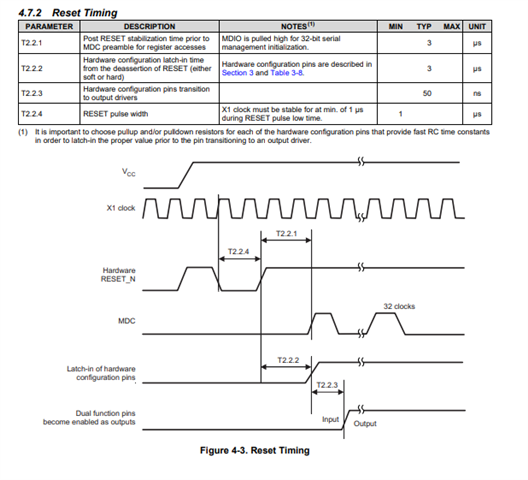

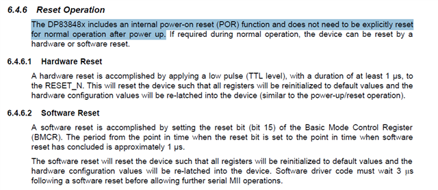

    In the current clock configuration, the clock will be applied after the EPHY is released from reset and this is not recommended.
    The clock is expected to be stable before the reset of the EPHY is released.
    I see you have Y3 provision. Can you populate Y3 and DNI the EXT_REFCLK1 clocking option.
    Alternatively, you need to change R161 (pullup for the SOC IO configured as EPHY reset) pullup configuration to pulldown and release the reset of the EPHY after the clock is configured.
    Sreenivasa
    Please continue to retain the changes.
    Can you please capture the reset and the clock waveform.
    The clock is expected to be available before the reset is released (goes high).
    I suspect this may be reverse in the current board configuration.
    Sreenivasa
    Please refer the EPHY reset release timing
    Sreenivasa
    Based on the discussion, today here are the likely changes for releasing the reset after the clock is stable.
    Common change
    Disconnect PORz_OUT - this is redundant in the current design - DNI R165. Ensure R160 is populated.
    Changes for EPHY reset implementation using processor GPIO Ethernet-ResetN
    Preferred approach
    Change R161 pullup to pulldown (this needs to be a glue wire in this case)
    The pulldown ensures the EPHY is reset. In the code in case the Ethernet-ResetN  is being configured configure as low.
    The EXT_REFCLK1 can be configured for 50MHz clock output and the Ethernet-ResetN  can be made high.
    Advantage: The EPHY reset will be low from power-up until the clock is enabled and the software sets the Ethernet-ResetN  high. No reset glitch
    Alternate approach for testing
    Configure Ethernet-ResetN low during the boot as early as possible. This will cause the reset to glitch High to low.
    Nite: The above changes can solve the reset timing related issue.

    A discussion is ongoing with the software technical team regarding the implementation of the reset procedure. In the driver, I can see that a software reset is being triggered, but I am still investigating the GPIO pin-level reset
    Also, the screenshot below is from the DP83848K datasheet. May I know your opinion on this? It mentions that it ‘does not need to be explicitly reset for normal operation after power-up
    Thank you.
    Please note the issue we are resolving is the clocking issue and not the reset issue.
    The above section assumes the design to follow the recommended clocking + reset sequence.
    When the required reset sequence is followed, there is no need to perform another reset but does not stop you from doing the reset.
    The pin strapping in case connected to the processor may be affected and hence the note.
    Sreenivasa
  • Hi All,
    Capturing the discussion here for tracking.
    I suspect the discussion here is on improving the performance vs right/wrong.
    I wanted to be sure that TI is making recommendation to ensure optimal signal integrity as well as proper communication performance. I do not know the use case and so you can judge the best.
    You may be able to route the clock without buffering but will need careful routing as well as timing analysis to ensure signal integrity. It is the board designer responsibility that the routing works over temperature and voltage variations.
    Connecting clock to x2 loads without buffer
    It is never a good idea to connect to two clock inputs to a single clock source.  This is very likely to cause signal integrity issues for one or both devices.  There may be cases where this can be done with careful PCB layout that was simulated and the PCB layout of the clock signal optimized for signal integrity, but this is very risky. one source to two load connection topology is not a recommended topology for a clock signal and needs to be fixed
    As per the datasheet, the CLKOUT0 pin is capable of driving both the external RMII PHY and the RMII[x]_REF_CLK pin, and no clock buffer is recommended. The schematic design has been implemented in accordance with the datasheet recommendations.
    Data sheet is describing the required connections. Data sheet does not any time provide custom board design implementation approach or recommendations.
    In the user guidelines, CLKOUT0 is buffered output even though additional external buffer is recommended. It is not a mandatory requirement. Right?
    I suspect you may have been confused with buffering. Buffering of the clock output means clock input to the SOC RMII refclock and the EPHY is expected to be connected through individual buffers. Refer below
    https://www.ti.com/lit/ug/sprado3b/sprado3b.pdf
    7.4.1.1.4.3 Processor Clock Output (CLKOUT0)
    When EPHY is configured as a device, the MAC and the EPHY uses a 50MHz common clock that is synchronous to both transmit and receive data. The 50MHz clock is defined in the RMII specification as a common data transfer clock signal that is used by both the MAC and the EPHY, where transitions are expected to arrive simultaneously at the MAC and EPHY device pins. The common clock provides better timing margin for both transmit and receive data transfers. Important requirement is that the MAC and EPHY do not receive any non-monotonic transitions on the clock inputs. To control the clock signal integrity, the recommendation is to route the common clock signal through a single input, two-output phase aligned buffer. The recommendation is to use equal length signal traces that are half the length of the data signals for connecting the clock buffer outputs, where one clock output connects to the MAC and the other connects to the EPHY.
    Regards.
