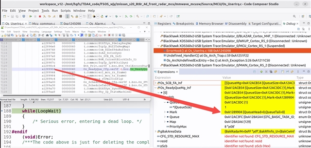

Os_ReadyQueueMark_Core0 ,
Hi Liang Hao,
Can you please set this(Os_ReadyQueueMark_Core0 ) as second parameter in the Os_ReadyQueMg_Core0 and try.
- If we are not seeing the issue then there is no issue with the structure parameter : Os_ReadyQueueMark_Core0
Anil
can you please let me know which is the example you are trying to build this from mcusdk, I will try this from my end.(Please let me know the which version of MCUSDK you are using for building this example)
meanwhile
- If this is linker issue, can you please try changing the linker version to older version and try?
- You are not seeing the issue with first member from that list after this try?
Hi Anil
I am using radar_perception_sdk_j722s_00_09_00_00 that is used to build.
I have no older version linker. If you have one, please send it to me and tell me the replacement method.
but with the same linker, only one member's address is wrong and the other 3 members's addresses are right, replacement linker is not root reason, we should find the root reason.
Hi Liang,
I am using "MCUSW_J722S_11.01.00.03", But i am unable to build mcu_app from this package.
After changing the structure member order from the list you are not seeing the issue with other members as well?
Can you please set the meeting to discuss the same?
