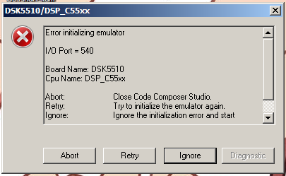

I'm having trouble figuring out how to connect to the DSK via USB. I have a Windows 7 32-bit OS. Here's basically what I've tried:
1) Installation CD for CCS v3.1 came with the DSK. Installed it directly onto my system. No issues with installation. 5510 DSK Diagnostic Utility didn't recognize the DSK at first, but I changed the compatibility to Windows XP (SP2). Worked like a charm, no issues. Ran all tests, including additional tests included with the software (Codec, Memory, DSP, and Switches), no issues. Started CCStudio 3.1, keep getting an error message. Screencap here:
Attempting to set compatibility to any version of Windows will result in the IDE failing to even start. Don't know if I'll be able to program the DSP like this.

  • Hi Jordan,
    With CCS4 or CCS5 I believe you should use Connection: "Spectrum Digital DSK-EVM-eZdsp onboard USB Emulator".
    I've had success connecting to C5509ADSK & C5416DSK this way...

  • Hi Jordan,
    I have the 5509A DSK, but I think it's the same story.
    A) It seems that you can only use the built-in JTAG emulator when running the CCS v3.1 that comes with the DSK.  Whatever drivers are present are not installed with CCStudio 3.1, and I've never figured out how to link the two.
    B) If you have a standard USB2 JTAG emulator for the C5510, then you should be able to plug that in to the 5510 DSK and run CCStudio 3.1 or CCStudio 3.3
    Basically, since I needed a separate USB2 JTAG emulator for my custom C55x hardware, I'm just using that same USB2JTAG for the DSK. You might have similar luck unless you don't have a standalone emulator and can't justify the cost.

  • Hey all,
    Thanks for the help. I was able to get the DSK to connect with CCS 4.
    Jordan
