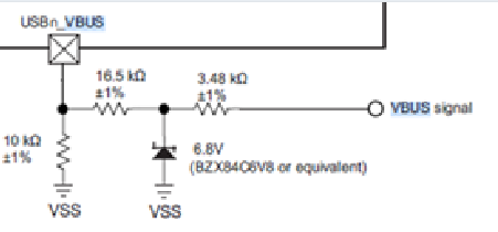

Please tell me about the circuit diagram of USB0_DRVVBUS.
Of the three resistors in the external circuit, is it possible to change the 16.5 kohm to 16 kohm?
We do not have a usable lineup within the company, and if possible, we would like to make the change.
