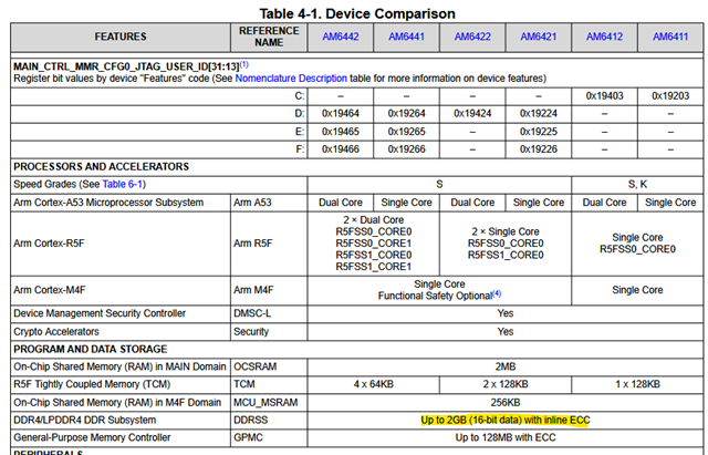

Part Number: AM6442
customer needs 4GB DDR4 oder LPDDR4. Is this supported?
Regards, Holger
Holger,
The max DDR4 and LPDDR4 size on AM64x devices is 2GB as specified in the device comparison table of the datasheet.
Chris
