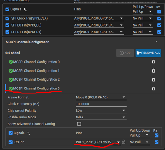

Hi
When I try to assign more than 3 peripherals (Chip selects) on SPI0 using Sysconfig (11_00_00_18) the driver initialization (Drivers_mcspiOpen) fails.
Code is running on R5_0_0 core. The SPI-instance is configured as "Multi Controller" with 4 MCSPI Channel Configurations
The failure occurs in Udma_rmAllocTxCh which appears to hava a limit of 3 DMA-tx-channels for all SPI interfaces combined. It looks like it tries to allocate one channel per CS.
Not sure what DMA-tx-channels means in this context but I don't see why each SPI instance would need more than 1 DMA channel for tx and 1 DMA channel for rx.
Any reason for this failure? Am I configuring the SPI wrong in Sysconfig?
Mathias

  • Problem occurs when running the mcspi_loopback_multi_instances_multi_channels_lld freeRTOS example if I add a 4th CS to CONFIG_MCSPI1 (original example only has 3 CS configured).
    I then get the following error:
    MAIN_Cortex_R5_0_0: ASSERT: 0.8121s: mcspi/v0/lld/dma/udma/mcspi_dma_udma.c:MCSPI_udmaInitTxCh:342: UDMA_SOK == retVal failed !!!

  • Hi Mathias,
    Please share the generated file "ti_drivers_open_close.c" in your application.
    Vaibhav

    /* MCSPI UDMA Channel HPD Mem */
    static uint8_t gMcspi1UdmaTxHpdMemCh3[MCSPI_UDMA_TEST_DESC_SIZE] __attribute__((aligned(UDMA_CACHELINE_ALIGNMENT)));
    static uint8_t gMcspi1UdmaRxHpdMemCh3[MCSPI_UDMA_TEST_DESC_SIZE] __attribute__((aligned(UDMA_CACHELINE_ALIGNMENT)));
    MCSPI_UdmaChConfig gConfigMcspi1DmaChCfg[CONFIG_MCSPI1_NUM_CH] =
            .txChHandle       = &gMcspi1UdmaTxChObj0,
            .rxChHandle       = &gMcspi1UdmaRxChObj0,
            .cqTxEvtHandle    = &gMcspi1UdmaCqTxEventObjCh0,
            .cqRxEvtHandle    = &gMcspi1UdmaCqRxEventObjCh0,
            .txHpdMem         = &gMcspi1UdmaTxHpdMemCh0,
            .rxHpdMem         = &gMcspi1UdmaRxHpdMemCh0,
            .hpdMemSize       = MCSPI_UDMA_TEST_DESC_SIZE,
            .txRingMem        = &gMcspi1UdmaTxRingMemCh0,
            .rxRingMem        = &gMcspi1UdmaRxRingMemCh0,
            .ringMemSize      = MCSPI_UDMA_TEST_RING_MEM_SIZE,
            .ringElemCnt      = MCSPI_UDMA_TEST_RING_ENTRIES,
            .rxEvtNum         = UDMA_PDMA_CH_MAIN0_MCSPI3_CH0_RX,
            .txEvtNum         = UDMA_PDMA_CH_MAIN0_MCSPI3_CH0_TX,
            .isOpen           = FALSE,
            .txChHandle       = &gMcspi1UdmaTxChObj1,
            .rxChHandle       = &gMcspi1UdmaRxChObj1,
            .cqTxEvtHandle    = &gMcspi1UdmaCqTxEventObjCh1,
            .cqRxEvtHandle    = &gMcspi1UdmaCqRxEventObjCh1,
            .txHpdMem         = &gMcspi1UdmaTxHpdMemCh1,
            .rxHpdMem         = &gMcspi1UdmaRxHpdMemCh1,
            .txRingMem        = &gMcspi1UdmaTxRingMemCh1,
            .rxRingMem        = &gMcspi1UdmaRxRingMemCh1,
            .rxEvtNum         = UDMA_PDMA_CH_MAIN0_MCSPI3_CH1_RX,
            .txEvtNum         = UDMA_PDMA_CH_MAIN0_MCSPI3_CH1_TX,
            .isOpen           = FALSE,
            .txChHandle       = &gMcspi1UdmaTxChObj2,
            .rxChHandle       = &gMcspi1UdmaRxChObj2,
            .cqTxEvtHandle    = &gMcspi1UdmaCqTxEventObjCh2,
            .cqRxEvtHandle    = &gMcspi1UdmaCqRxEventObjCh2,
            .txHpdMem         = &gMcspi1UdmaTxHpdMemCh2,
            .rxHpdMem         = &gMcspi1UdmaRxHpdMemCh2,
            .txRingMem        = &gMcspi1UdmaTxRingMemCh2,
            .rxRingMem        = &gMcspi1UdmaRxRingMemCh2,
            .rxEvtNum         = UDMA_PDMA_CH_MAIN0_MCSPI3_CH2_RX,
            .txEvtNum         = UDMA_PDMA_CH_MAIN0_MCSPI3_CH2_TX,
            .isOpen           = FALSE,
            .txChHandle       = &gMcspi1UdmaTxChObj3,
            .rxChHandle       = &gMcspi1UdmaRxChObj3,
            .cqTxEvtHandle    = &gMcspi1UdmaCqTxEventObjCh3,
            .cqRxEvtHandle    = &gMcspi1UdmaCqRxEventObjCh3,
            .txHpdMem         = &gMcspi1UdmaTxHpdMemCh3,
            .rxHpdMem         = &gMcspi1UdmaRxHpdMemCh3,
            .txRingMem        = &gMcspi1UdmaTxRingMemCh3,
            .rxRingMem        = &gMcspi1UdmaRxRingMemCh3,
            .rxEvtNum         = UDMA_PDMA_CH_MAIN0_MCSPI3_CH3_RX,
            .txEvtNum         = UDMA_PDMA_CH_MAIN0_MCSPI3_CH3_TX,
            .isOpen           = FALSE,

    Upon adding 1 more CS, I run into this problem as well:
    [MAIN_Cortex_R5_0_0] ASSERT: 0.14053s: mcspi/v0/lld/dma/udma/mcspi_dma_udma.c:MCSPI_udmaInitTxCh:342: UDMA_SOK == retVal failed !!!
    I have created a bug to follow up on this and will get this fixed in the coming release.
    Vaibhav
